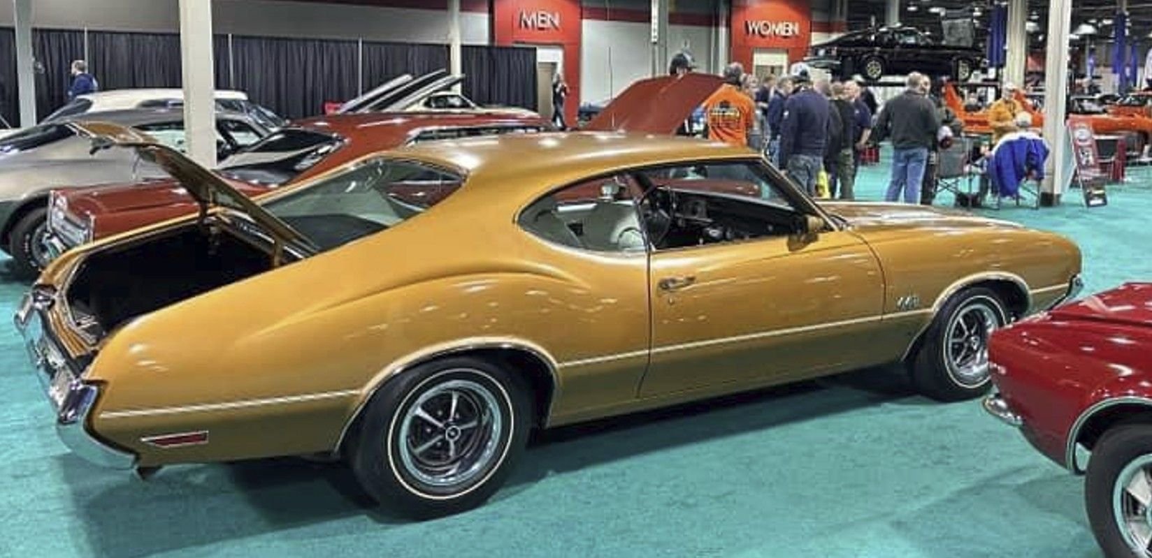

Our original paint survivor came with 14" thin white wall. If you want to go with 15" you may want to look into 225/70/15. It is about 1/2 taller than stock but I think your car will look good in one of these tires from Walmart or Discount Tire:
