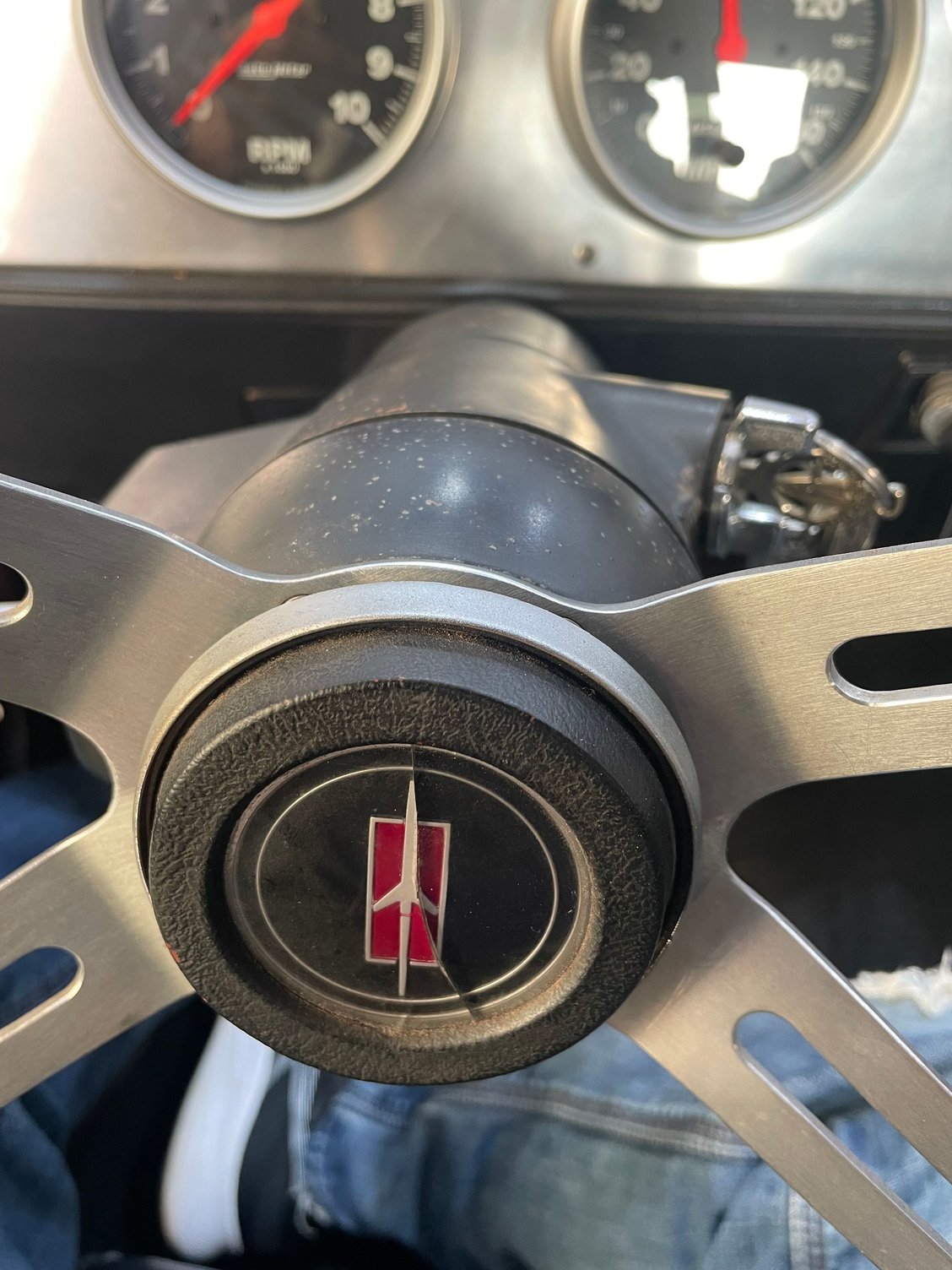

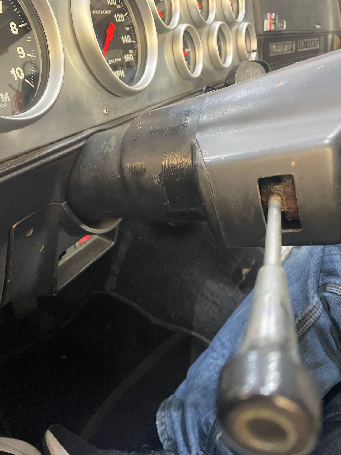

Ok got this 1979 cutlass not long ago
the steering wheel I wish could be shorter torwards front of car. Looking around today I noticed I might just do that. I’m thinking it’s telescopic

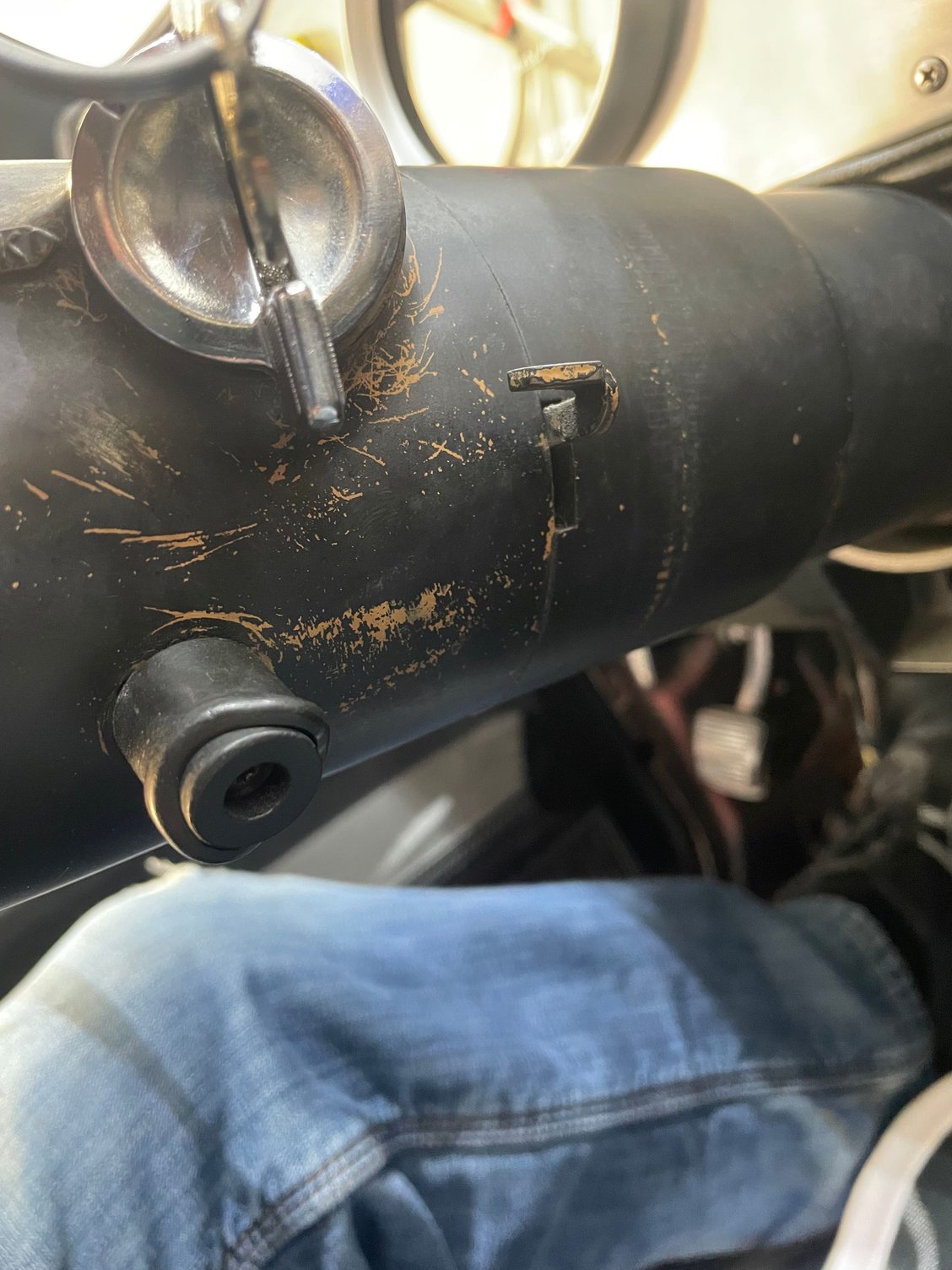

it’s got a lever type thing
I push it down. Nothing happens
anyone know how these work ?
I don’t think it’s tilt steering
Old Nov 3, 2024 | 06:18 PM
Posts: 50,770
The lever is to allow you to turn the key to the LOCK position. You're supposed to hold that lever down while turning the key. It is not a telescoping column.

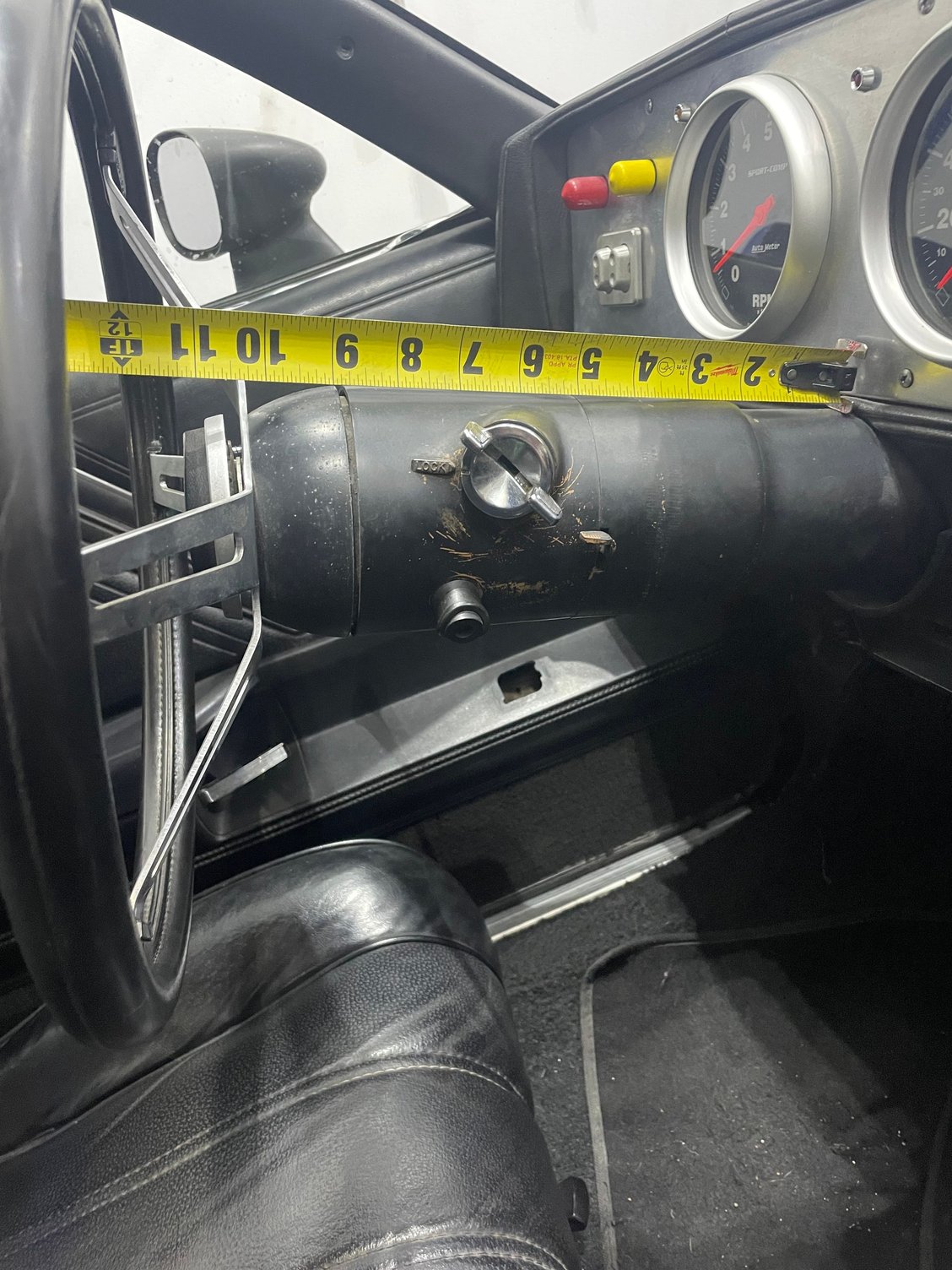

It's a bit hard to tell from the pics but that column looks awful long coming out of the instrument panel; are you sure that is the correct one for the car?
Old Nov 4, 2024 | 02:56 PM
79cut's Avatar
Joined: Sep 2024
Posts: 321
From: Canada Ontario
it’s about 10 inches long
mostly likely not the one for this car
Old Nov 4, 2024 | 07:12 PM
Posts: 50,770
More to the point, that vintage Olds did not use the locking lever to turn the key to LOCK. That column likely came out of an F-body, probably to replace the original column-shift column for a floor shift.
