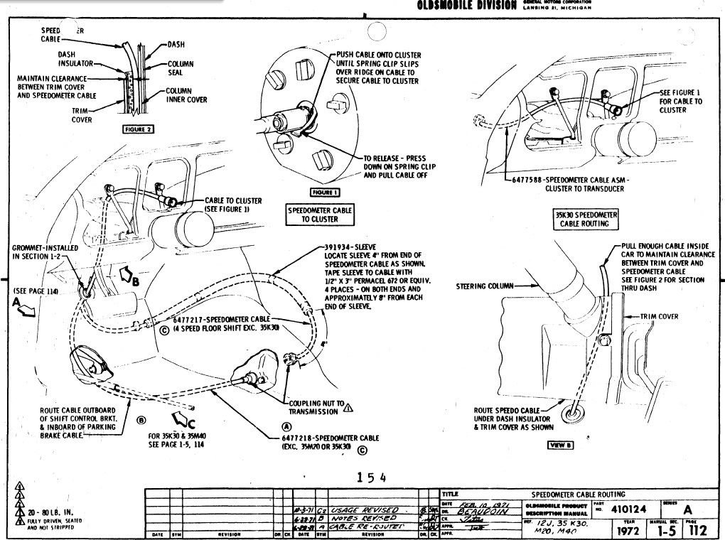

It's honestly not that bad. Yeah, you'll have to navigate under the car. Jack stands make it far more comfortable (w/ or w/o a floor roller dolly). Only one place/hole where the speedo cable goes through the floor pan. There are a couple tie-off/clips but nothing excruciating. Removing the speedo assembly from the transmission is a snap. The entire speedo cable assembly itself is held onto the transmission by one bolt as I recall. I don't think you even have to remove the assembly. You unscrew the knurled nut from the assembly and the speedo cable comes off. I think you only need to remove the attachment bracket only if you change out the speedo gear (like if you had larger tires or were changing rear end gear ratios) so the speedo was calibrated correctly.
See if I can find a couple diagrams from the PIM.

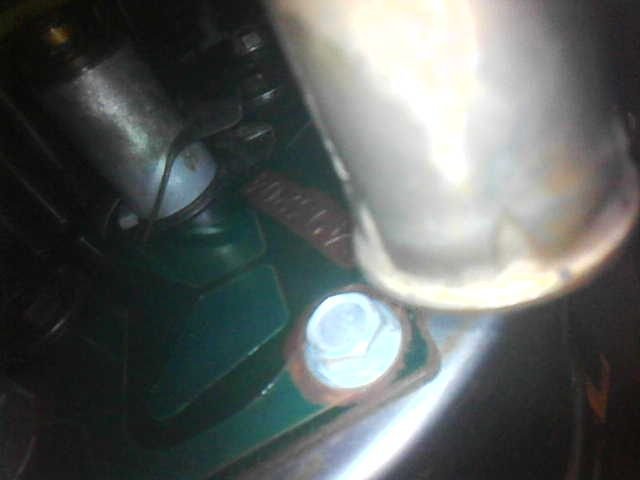

Several good posts that were very helpful. A simple procedure really, but if you have never done it, a little difficult, mostly because ya just can’t see the connection very well on the back of the speedo. I used one of those flexible camera wand things and found the retainer clip that was just like VC said. I pushed it down like Fun71 said and the assembly pulled apart easily. I was able to pull the actual cable. It was very clean. No lube on it at all. No kinks, fresh, etc. looked really good. Lubed it with a chain and cable lube. Slid it back into the sheath easily, except for the last inch or so where I suspect the square cable was searching for its way into the transmission gear. Finally found its way OK. Reconnected the sheath to the Speedo with just a push on. Didn’t need to fiddle with the retaining clip.
So the process went well…
But the test drive reveals that the wobble is still there. So..I’ll probably buy a whole new speedo cable assembly and hope it goes away. I may get my nose down by the transmission first and see if there is an obvious problem?

Yes VC. That is what I used. It did help. So simple when you totally understand it like several of you already do. Here is what I saw….
Speedo is on left, with retaining clip visible.

Oh yeah, I've been in there numerous times for a consortia of reasons. In the 2nd image I posted the PIM does a decent job of depicting the spring clip & how to remove the cable. Good work.
