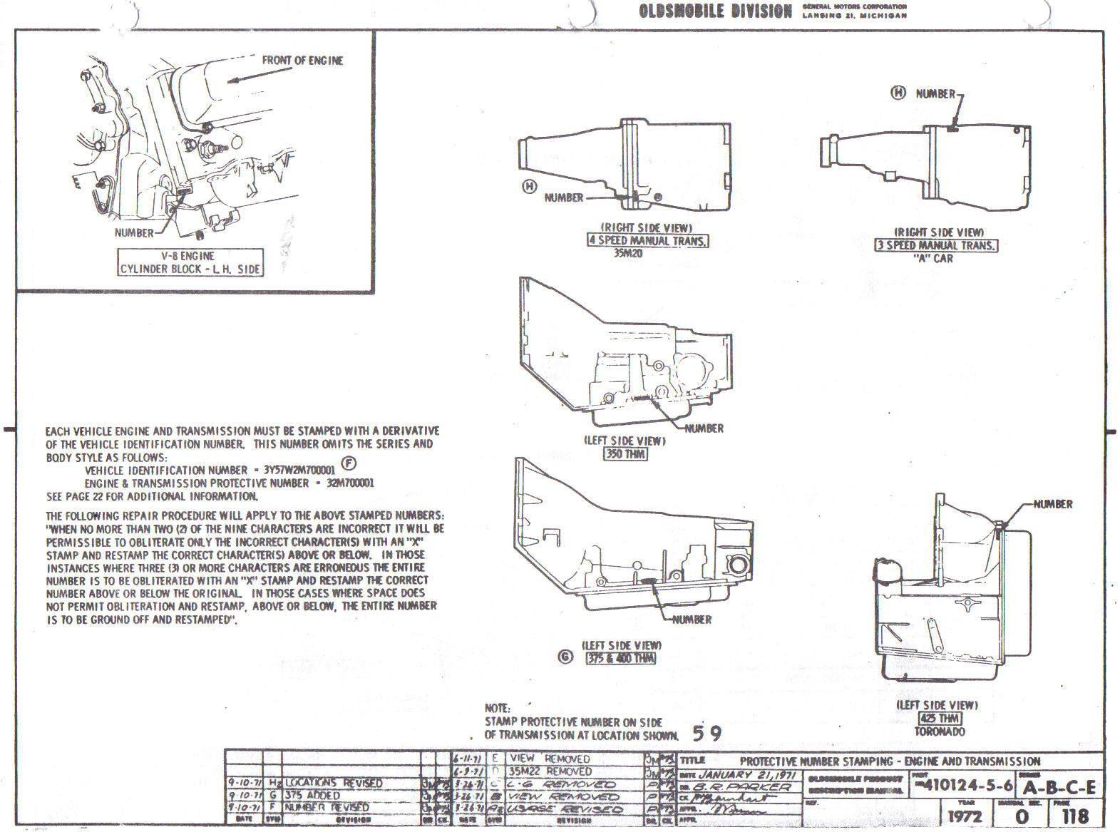

I'm going to sell my 72 Cutlass Supreme and I have no idea if it has numbers matching engine or transmission. My question is: does it really matter for setting the value?
I know it does on Chevelles, Corvettes and Camaros but since my Cutlass isn't a 442 or W-30 does it really matter?
If so, where is the partial VIN stamp on the engine block?

Great pics Fun71. Thanks a bunch.

The matching VIN derivative stamp applies to both the engine block and the trans case.

It matters a little for show car condition cars. The good news is, unless your ride grenaded its engine, it probably IS numbers matching. It might help 10% for a non-performance car.
