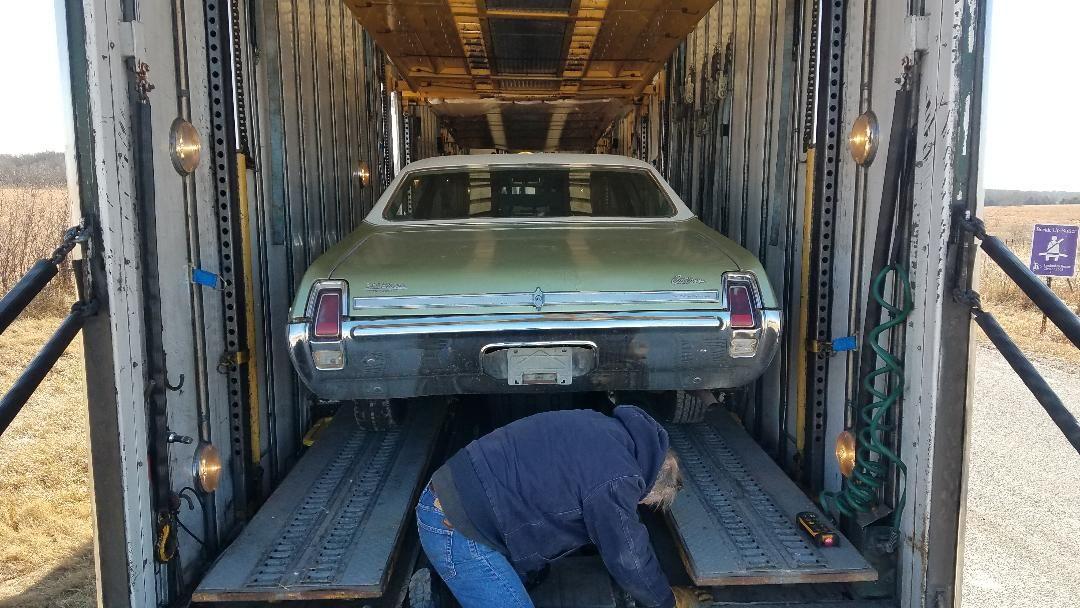

Slightly newer than my last one! '69 Cutlass Holiday Sedan just arrived from Oklahoma, very original car, not run it at least 3 years, probably longer, no brakes, dirty.. now the fun begins!

Wow, that looks like an easy job to get it back on the road. It's a Supreme, obviously. Nice find.

Nice solid car! Looks almost like my Supreme, Just missing front and rear side moldings to paint the lower rockers Argent Silver and window sills. Also I have a Halo top with a CS emblem, I don't know if that was unique to the Supreme. On your car someone replaced the tail lenses with Supreme lenses. The Supreme lenses have the silver trim molded into them. If you switch back let me know, I would like to buy them, because they are not reproduced. Also be very careful with the vent window gaskets, the only replacements I have been able to find would be from Steel Rubber if I wanted to pay $30,000.00 for a mold.

I think his tail lights are confusing you, they are Supreme lenses. When I first saw Holidaysedan's picture I too thought his car was a Supreme. His car is missing the stainless moldings going from the bumpers to the wheel wells. I don't think Holidaysedan's car has window sills either. The pictures that Holidaysedan had of his interior in a previous thread. are not of a Supreme. Also Joe, I have been very impressed with your knowledge on these cars, can you shed some information about the vinyl tops? My car along with a parts car I had bought have a Halo top that goes lower into the rear doors. It is weird that I have a chrome emblem on my rear doors that I had to paint the vinyl tops color on. Holidaysedans top is not a Halo design, was the Halo top an option?

Thanks all, 4+4+2 found this car in OK and facilitated everything, been looking for one for quite awhile, a rather hard find in the Northeast.. I'm unclear as to whether it's a Supreme or not as it's got mixed signals, like those tail lenses. I'll need to find a build sheet if it's under the seat or does VIN 336399Mxxxxxx give any clues? M tells me it's a Lansing built car. It doesn't have the contrasting silver paint band under the side trim, nor the CS interior, and I'm not sure whether the halo roof was a CS standard, the brochure shows a red regular Cutlass Holiday Sedan with a halo roof and black vinyl, so it was evidently optional on all 4 dr hardtops, but standard equipment on the Supreme? Also the dash on this car doesn't have the wood-grain. So I'm leaning towards a standard Cutlass.
Possibly the rear lights were replaced, I can't get the trunk open yet but there may be evidence of a past rear-end hit, as the bumper looks possibly like a replacement and the trunk paint is crazed, unlike anyplace else on the car, a possible sign of a repaint, beyond the obvious repaint of the rest of the car at some point.

Actually, I just looked quickly at the side trim and assumed it was a Supreme, but you are right, and the 33669 VIN proves the car is a Cutlass Holiday Sedan as shown in this page from the 1969 dealership brochure. The factory vinyl top on all 69 Holiday Sedans was a halo top. The one on the OP's car must be an aftermarket or dealer-installed replacement. The cowl tag will tell you if the car came from the factory with a vinyl top or not. And yes, the painted textured trim was also used on the trunklid of the 68-69 Holiday Coupes with vinyl tops. The paint chip chart lists the colors for this paint - note the listings in the lower RH corner of the paint chip chart below.

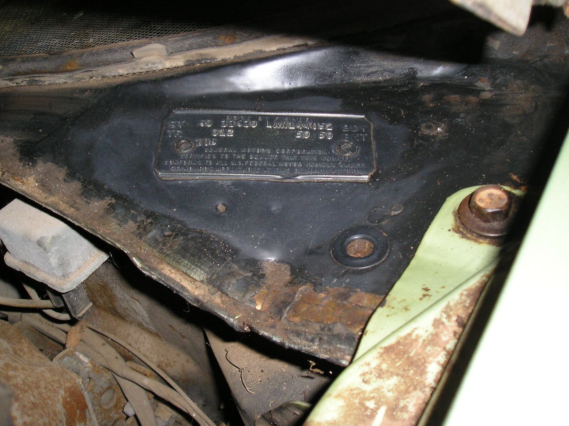

The brochure also shows the lower dash to be wood-grained on that same page, yet mine is green. Wonder if wood-grain is supposed to be standard, or was so later on in the year? Being a Jetaway car, I'd assume then that it was not a later production car?
pic of the cowl tag - interpretation below
ST 69 33699 LAN144052 BDY
TR 912 59 59 PNT
10B

The woodgrain was RPO BC1, a $10.53 option on the Cutlass line that year. The woodgrain was standard on the Cutlass Supreme and 442 models.
And as we suspected, your cowl tag shows 59 59, which means Meadow Green Poly lower and upper body colors, so this was not a factory vinyl top car. Had the top been factory, the second "59" would have been replaced with a letter that designated the top color. That, of course, explains the lack of a halo top. It's an aftermarket installation.
