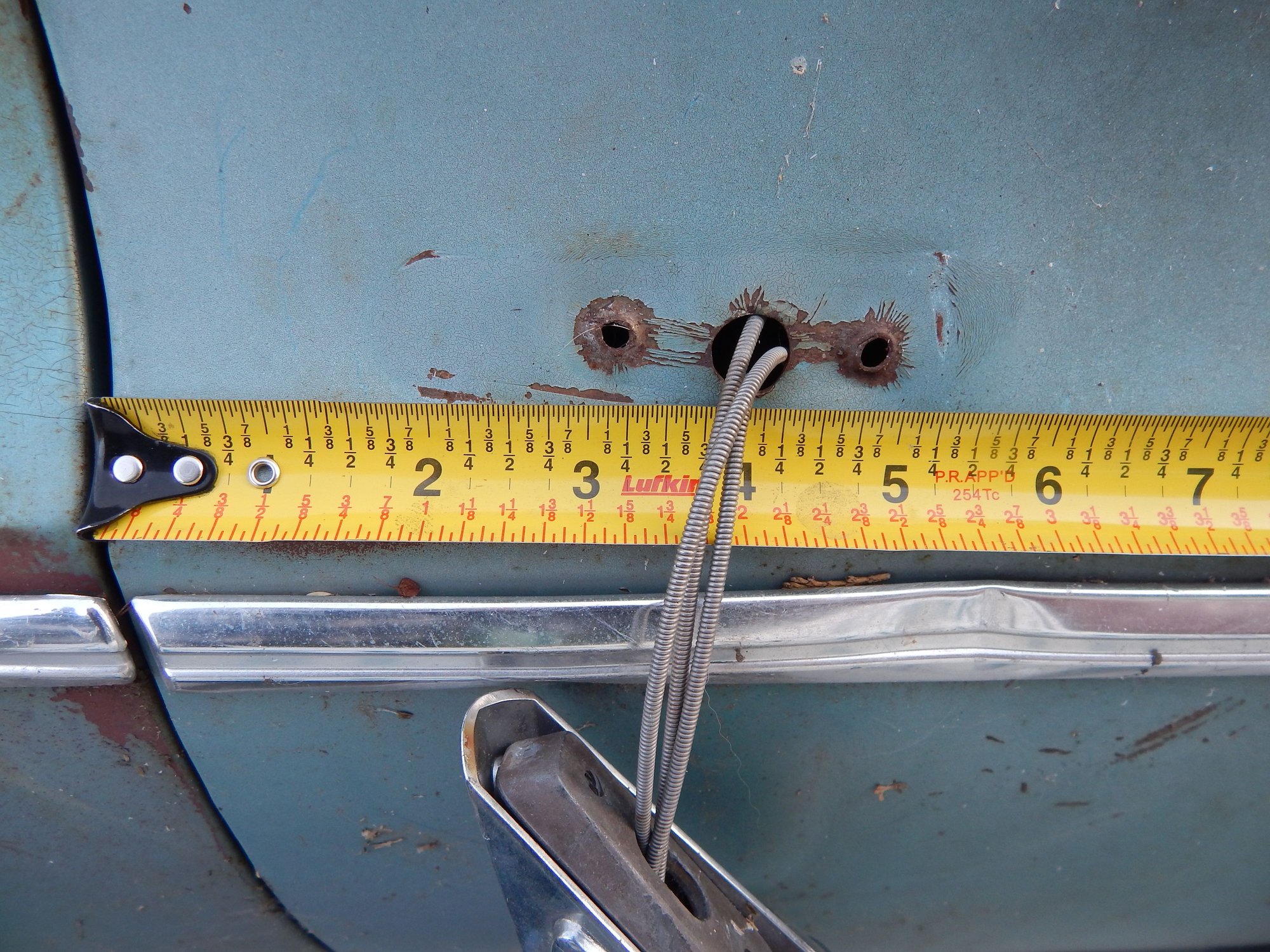

My body man filled the holes for the remote control mirror. Now I'm trying to install the mirror and somewhat guessing where to drill.
Anyone doing restoration work out there on a 64 cutlass that could possible send me measurements or come up with a template for me?
Just checking. I hate to drill into the paint and body and be off too far. I have put this off for some time because I really don't want to make a mistake.

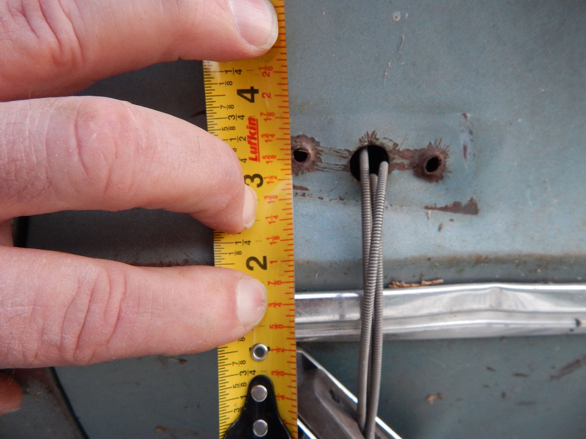

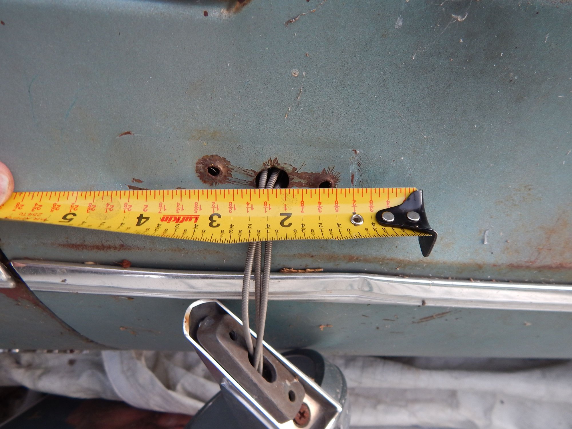

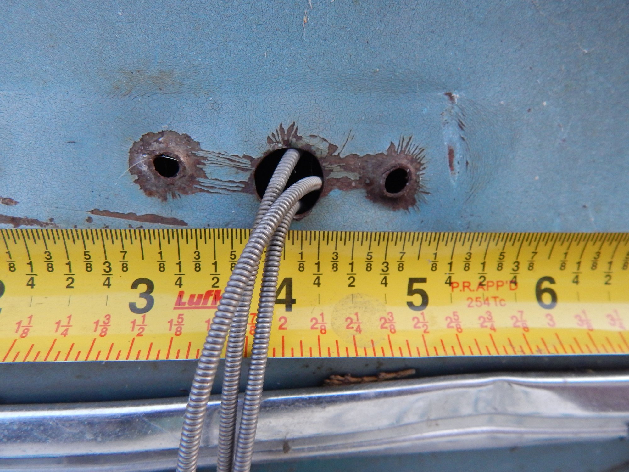

Here's some photos. Let me know if any measurements are not clear.
John

Thank you! I think this really helps.
Dale
