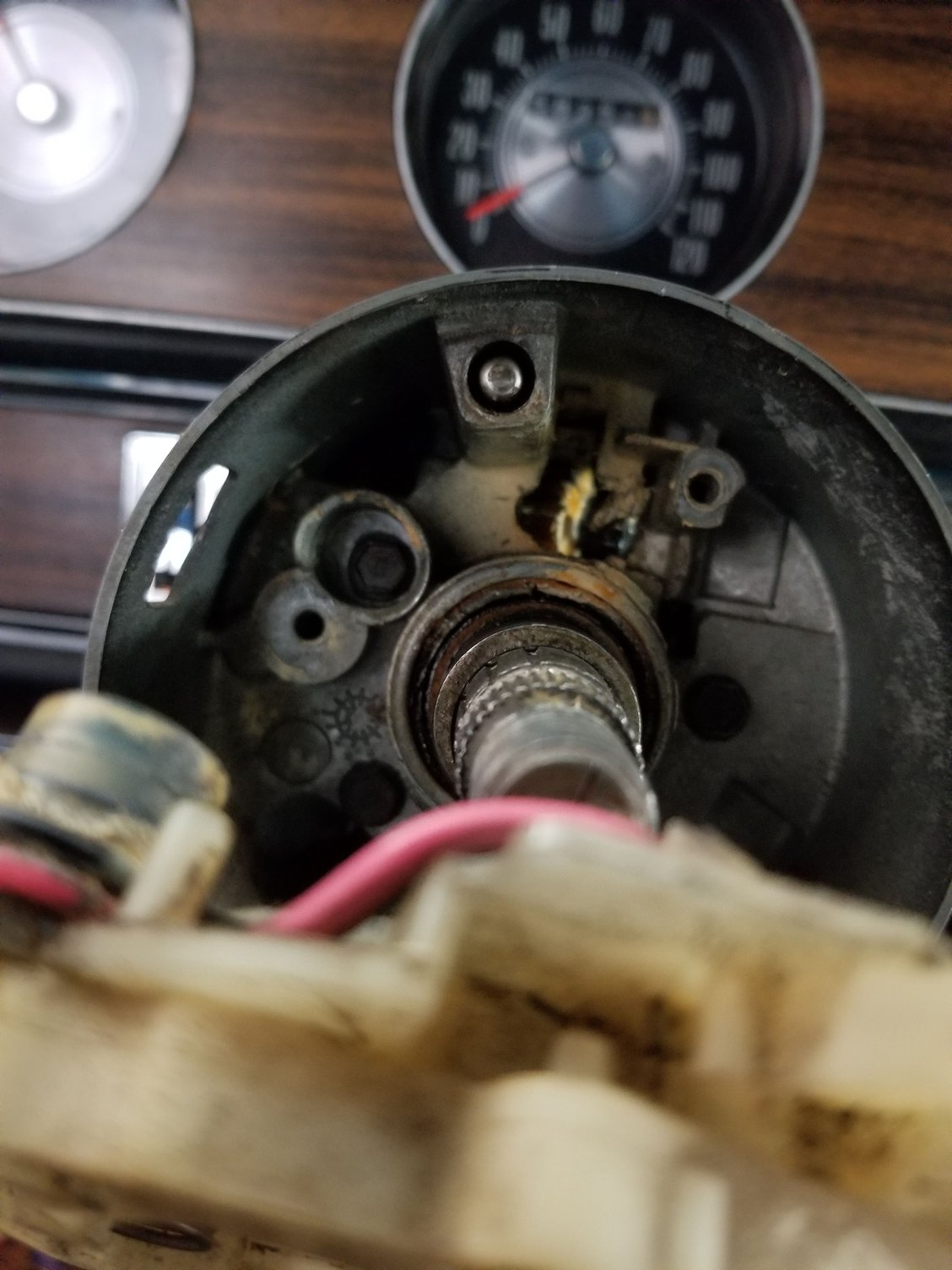

Old May 13, 2020 | 05:36 PM
BLUZIN's Avatar
Joined: Mar 2020
Posts: 64
From: Boston, Ma
End of where ignition cylinder would be piece broken off.. the casting inside is chipped.
Old May 13, 2020 | 05:57 PM
Posts: 50,802
I still can't tell exactly from that photo, but if you are talking about the part of the casting just below and to the right of the lock pin, where there seems to be some yellow material, that is the part of the casting that the ignition lock cylinder snaps into. That part is called the upper lock housing, and I don't believe it is reproduced, but it should be the same on every 1969-77 GM non-tilt steering column - so long as the headlight dimmer switch is on the floor and not on the column, and so long as it doesn't come from a car that uses the little lever under the key to lock the column (these were on low-end cars like Vegas). This part is the same for both floor and column shift, so there should be a lot of donors out there. There is some disassembly of the column needed to replace it. A virgin one should look like this:
Of course, nothing about that part will effect the horn.

Old May 13, 2020 | 07:14 PM
BLUZIN's Avatar
Joined: Mar 2020
Posts: 64
From: Boston, Ma
Yes, I need that whole housing. Thank you Joe. The hunt is on.
This one is currently for sale on line for $125. Apparently it is made from solid gold...
Hi Joe, Yes, just to the right of the yellowish, plastic piece the white spot is the casting broken off giving the ignition too much play and wont turn back to accessory position. I'll see if I can hunt one down. And he got the wheel on but having trouble with the spring and plunger to make the horn work. I showed him what others have said, then he dropped the spring and we couldn't find it! He will round up a spring today, and I will go back to have the column fixed.
Again, Thank you for sharing your knowledge. Regards, Jack
