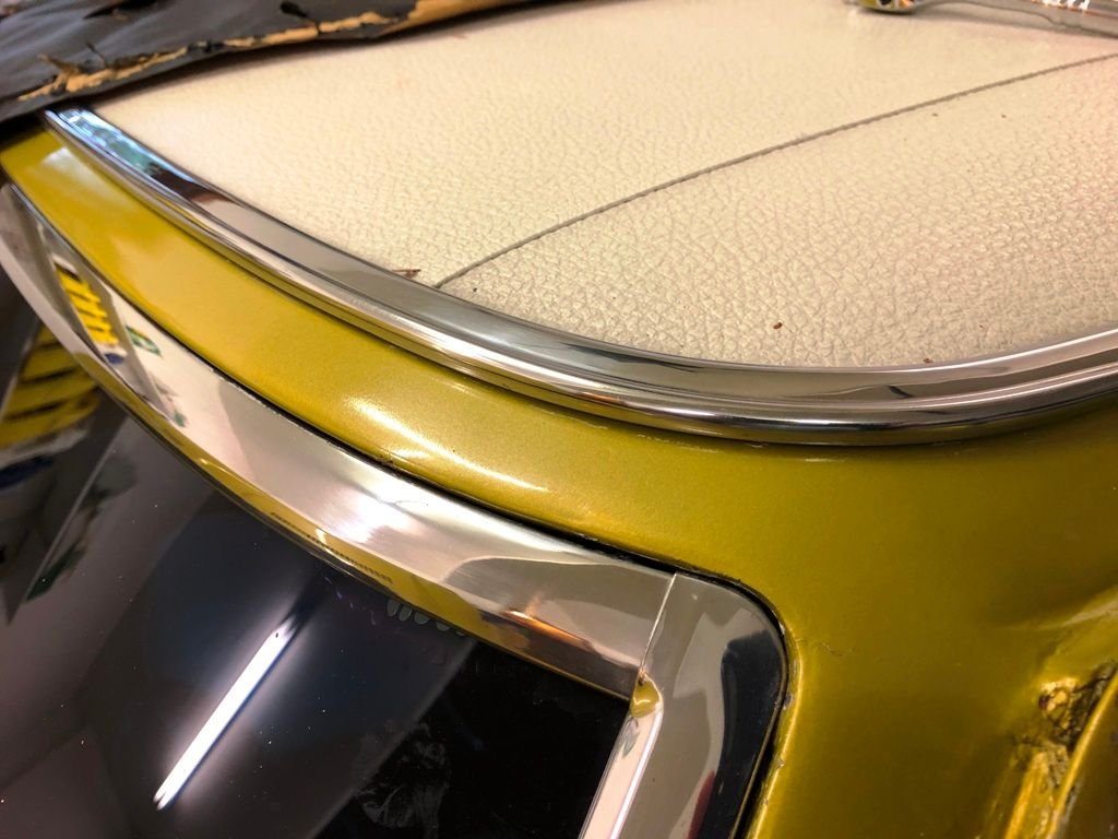

these clips hold the halo trim, these should be the same as the rear deck section ,I use the plastic putty knife to get it started or if you have a trim tool , just go slow so you don't bend the trim

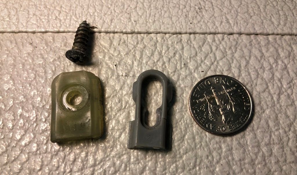

There are two types of clips, I'll just call them A and B.
The B-clip has a screw hole mount. There are 8 of these.
The B-Clips were much harder to Pop off and usually shattered.
The A-Clips slide over an existing stud. These popped off easily.
I plan on buying a few new of each for the re-installation.

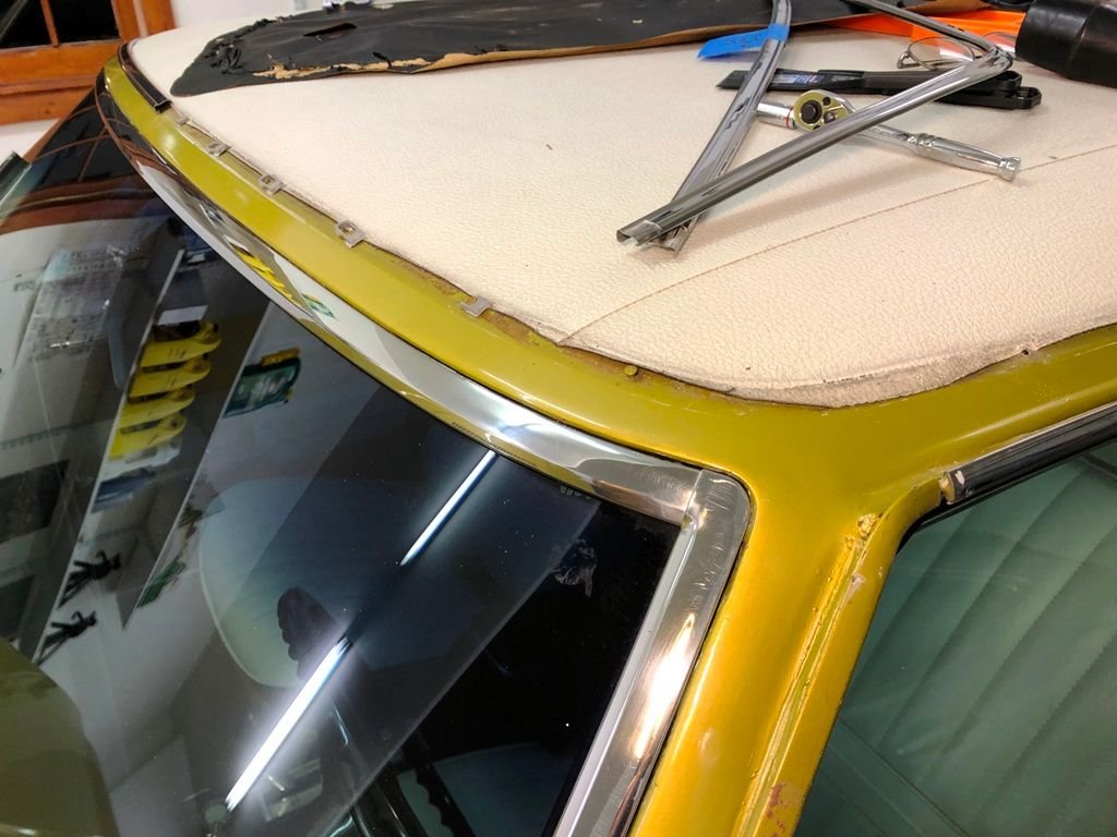

I did use a pair of plastic putty knives to slide under the trim and pop off.
Front section with trim removed
The Screw clips were harder to pop off. The key-hole style popped off easily.
72455
