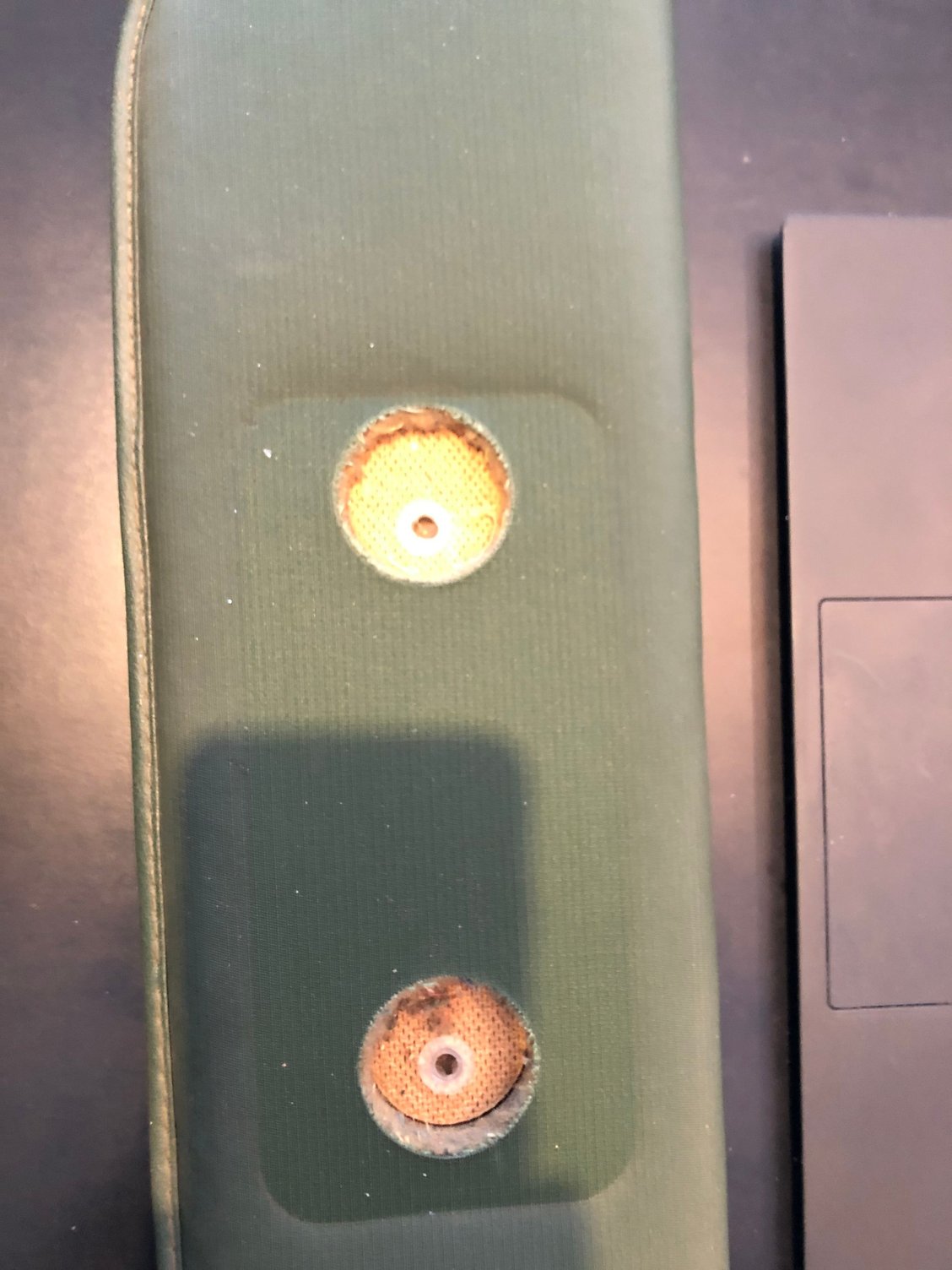

Does anyone have any tips on how to install a vanity mirror on the visor. The visor (original) is so cushioned the mirror clips do not reach. When I tried pushing the mirror down engage the clip the mirror shattered. Purchased a new mirror but
looking for advice before proceeding.

I used a thin wood board the size of the mirror, laid it over the board to get even pressure (I broke my last one) and pressed in place with wood clamps. It worked great.
