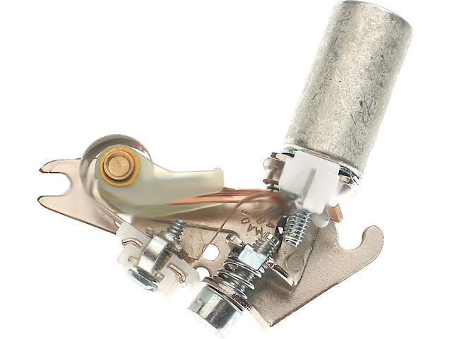

Some Points, have a "Built" in capacitor physically attached to the point set.
It sounded like a nice idea.
The Built-in-Capacitor versions of points are crap, stay far away!
Not only did I have capacitor clearance issues hitting the Distributor cap, I could never
get the car to start.
I took them back and got the style with a Separately mounted capacitor.
Also, Look for the points that have a Screw down bolt for the mounting
of the Ground Wire and the Capacitor wire
The cheap points use a simple friction fit sprint to hold the two critical wires to the points.
The Screw is harder to install, but more reliable.
Poor: This type has a physically attached capacitor. It would not fit my distributor cover.

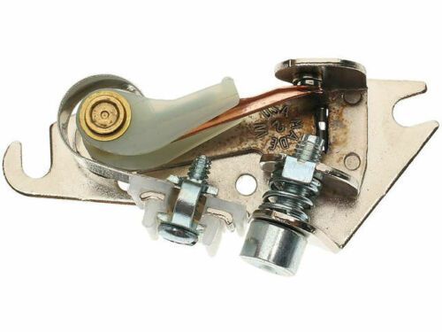

Poor: This set uses a friction spring.
At the top there should be a Screw, instead this cheap version has a metal plate, and you slide the wires under the plate.
This set has a separate capacitor.
Best: Note the wire attachment point is secured with a screw.
This is much better than the Friction Spring type used by some.
