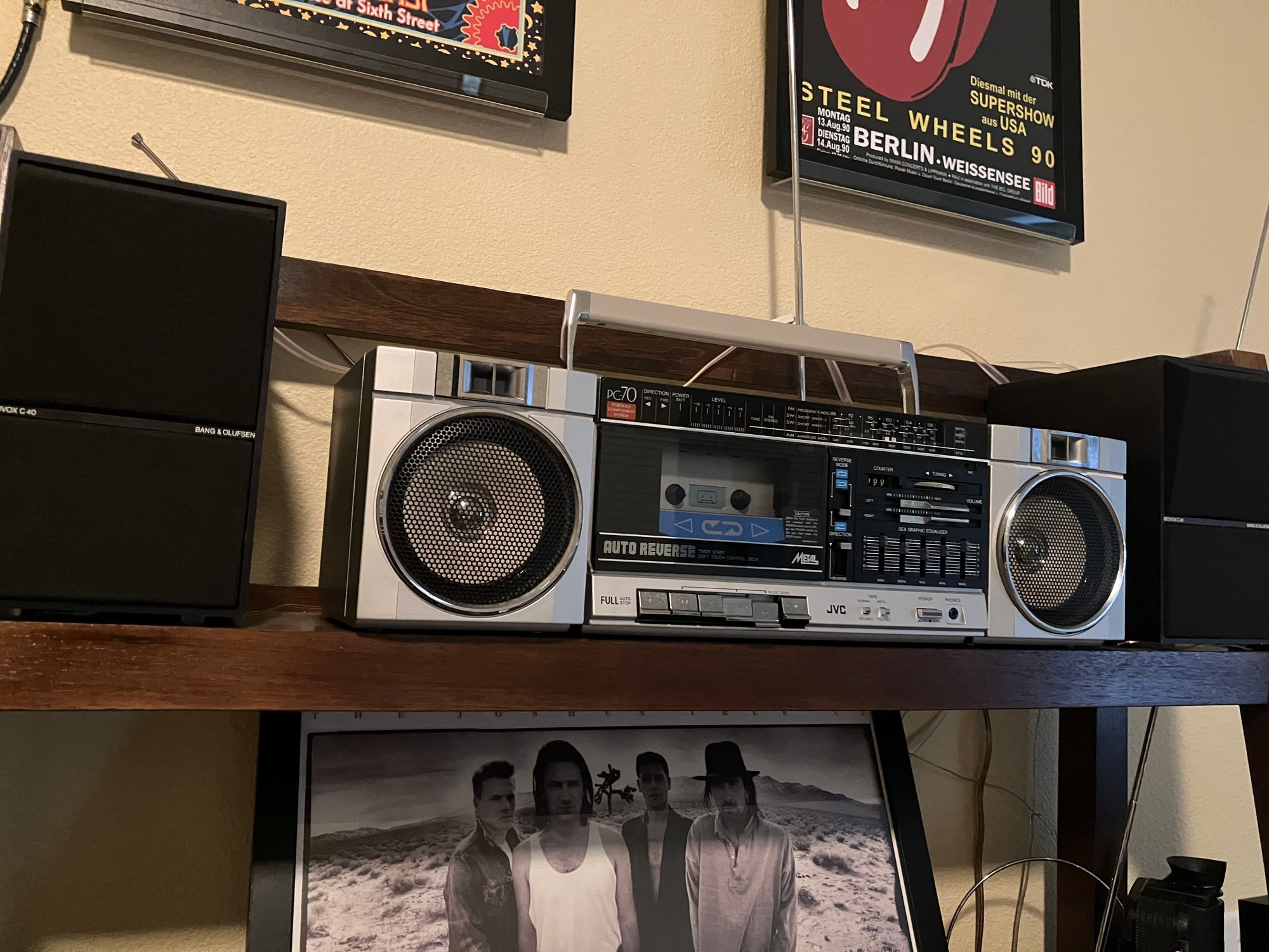

Good luck and let’s see the unit, recently I picked up a mini JVC boombox circa 84 / 85, and although it’s mostly a display piece, it’s full of great memories. As typical of these units, the tuner and aux inputs work, but tape deck belts are fried.
