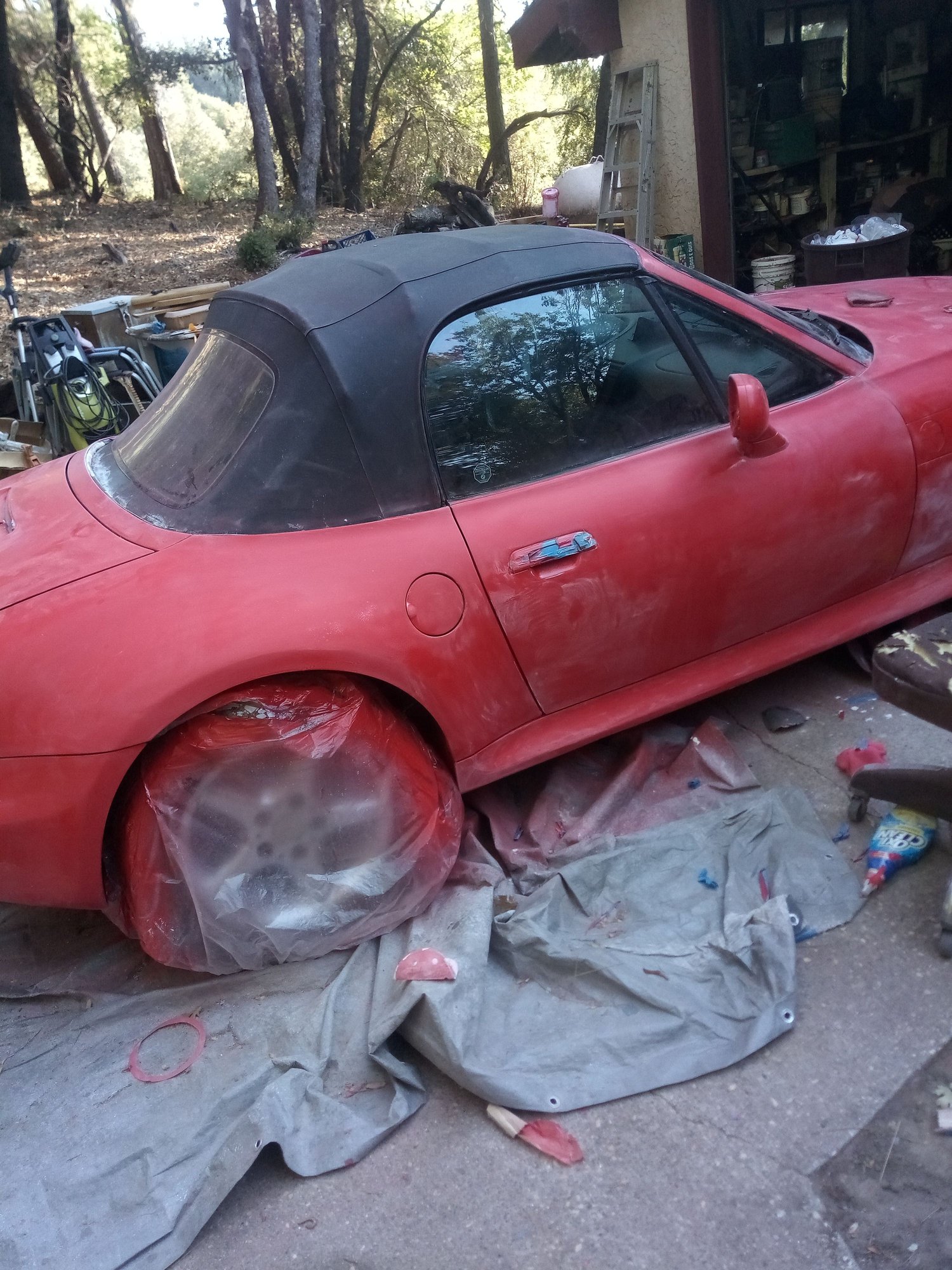

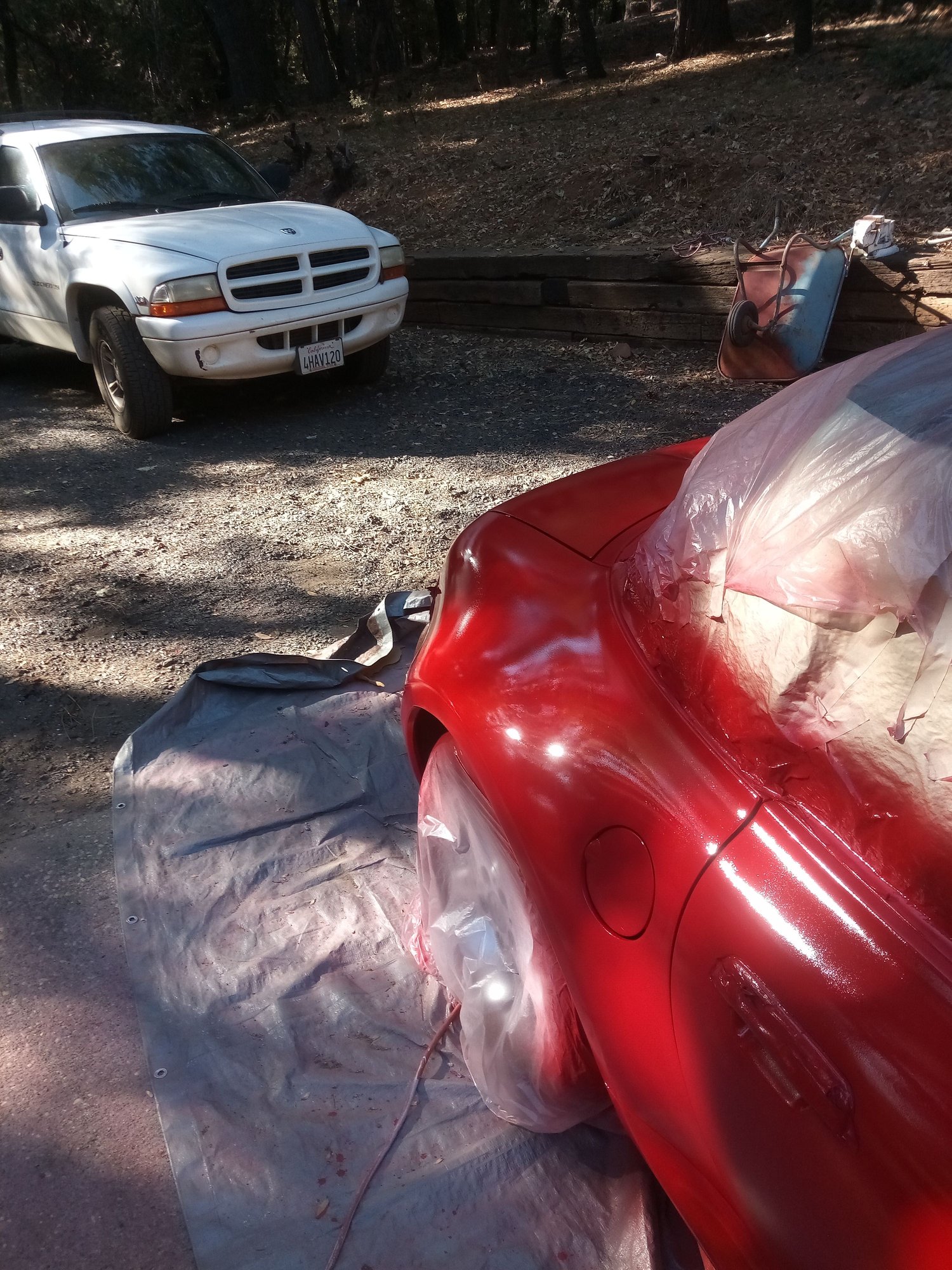

Well it's red again but looking much smoother and I think it will take a clear without orange peel and without a issue. I did managed to get three little runs that I will clean up after they dry, can't swing a gun as smooth as I use to my shoulder joints have square spots that match the runs. Dan couldn't make it so I ended up doing the low stuff also. If it doesn't get to hot maybe a coat of clear this afternoon, but I'm not taking any chances if I don't feel right or it is too hot I'll to it tomorrow or next week if need be. Here are a few pictures of the before and after. Kind of looks like it did before but trust me it is much smoother....Tedd
Out of place photo this is before the last repaint... Sorry operator error... Tedd

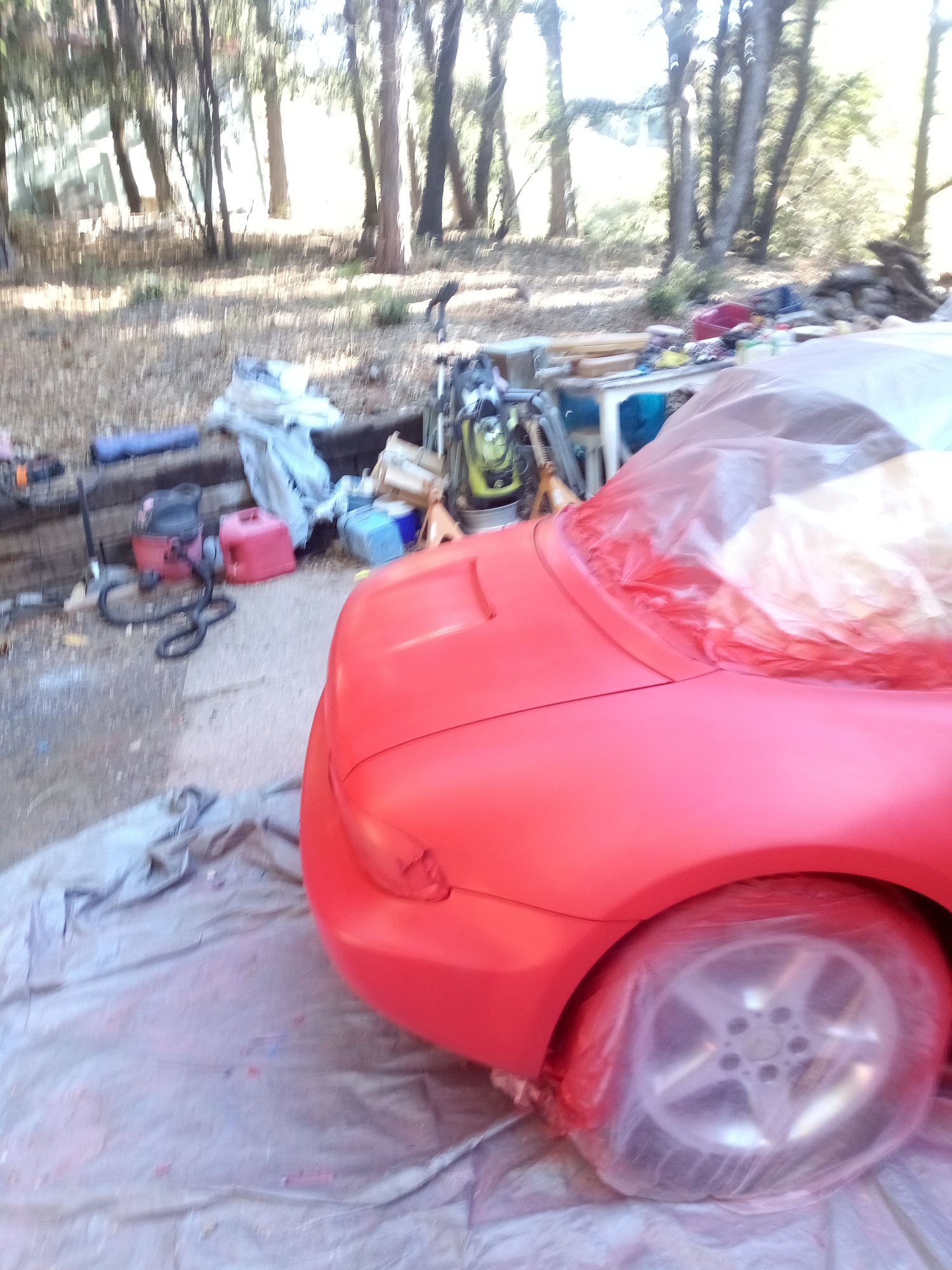

Nose after first coat

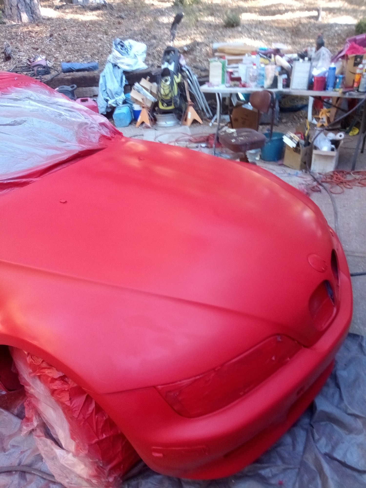

Side shot first coat
One more time with a tac rag. Probably time number 6 or 7.
The *** during the first coat

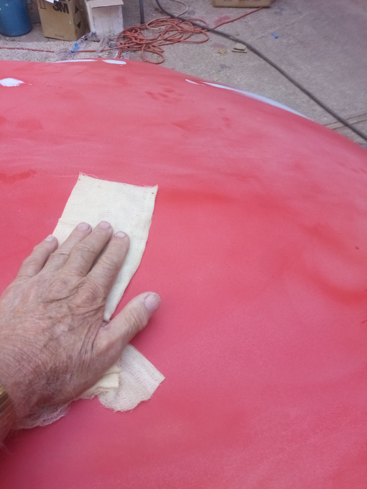

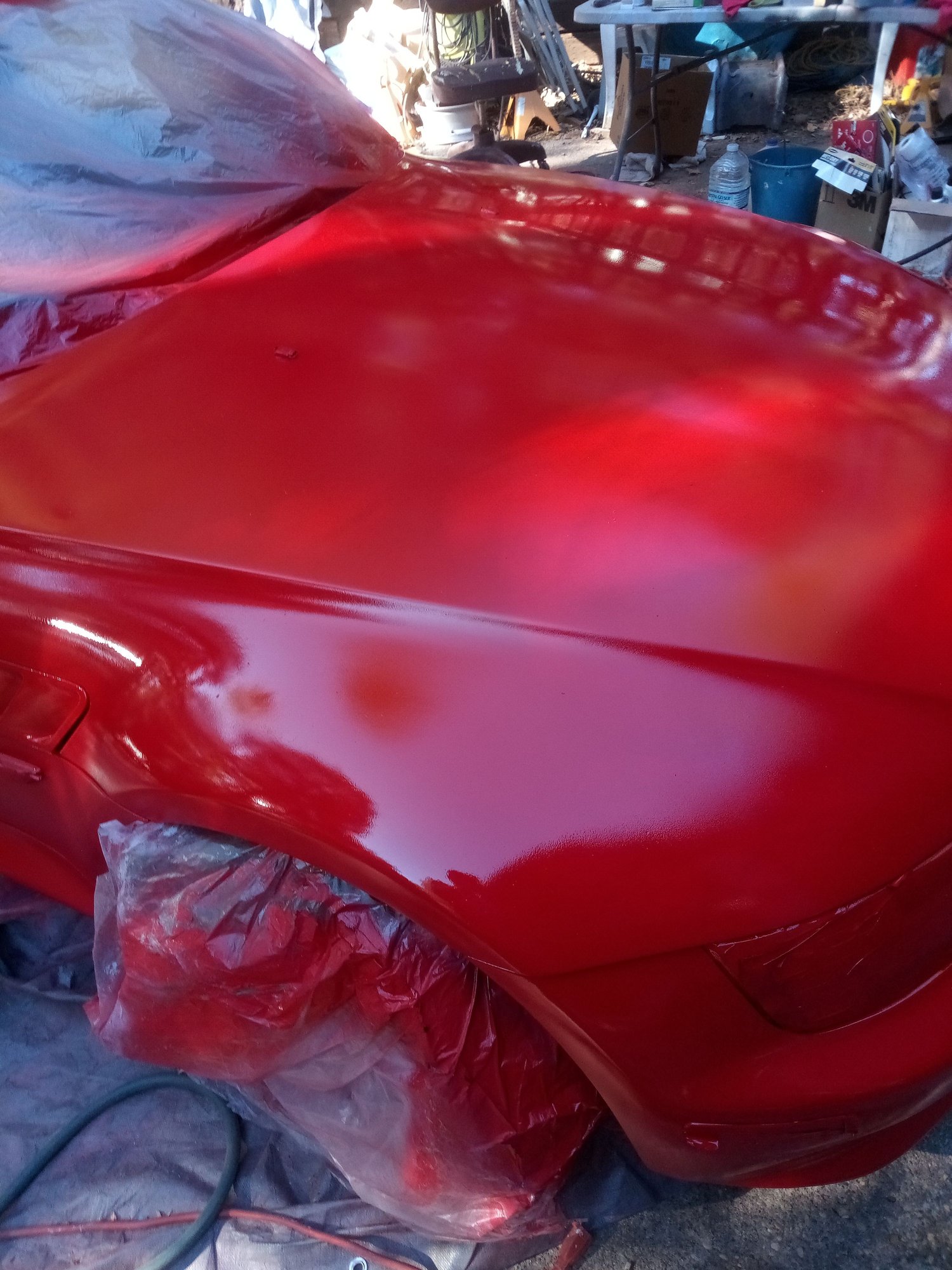

Last coat of clear and starting the cut and buff. Found a few runs that I didn't know I had mostly because I thinned the clear down so I could get a good smooth finish and it curtained on me, still learning. It's trying to rain this morning so I'll see how far I can get I would like to do some touch up but cut and buff likes rain.... Tedd
First pass with the buffer

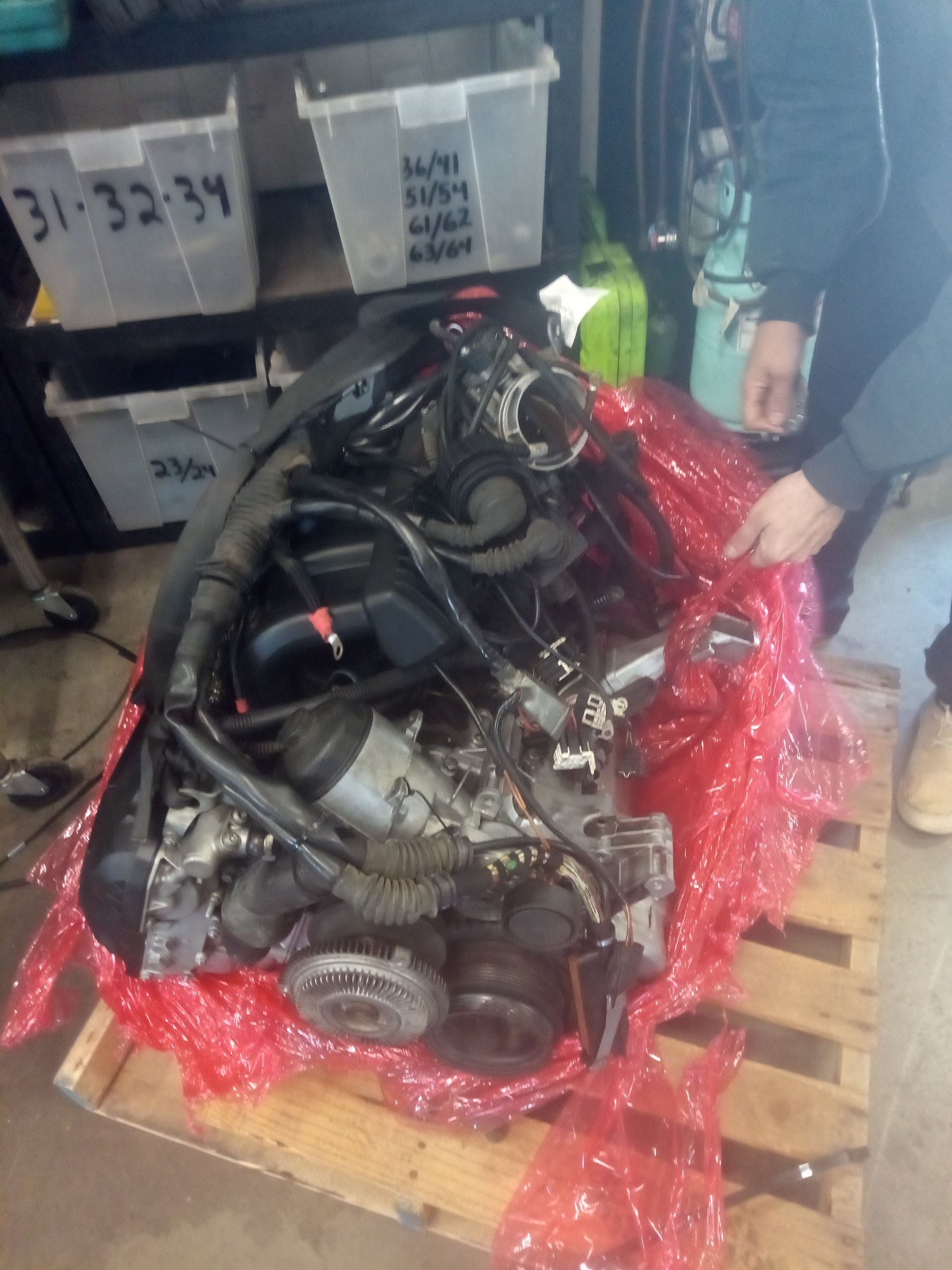

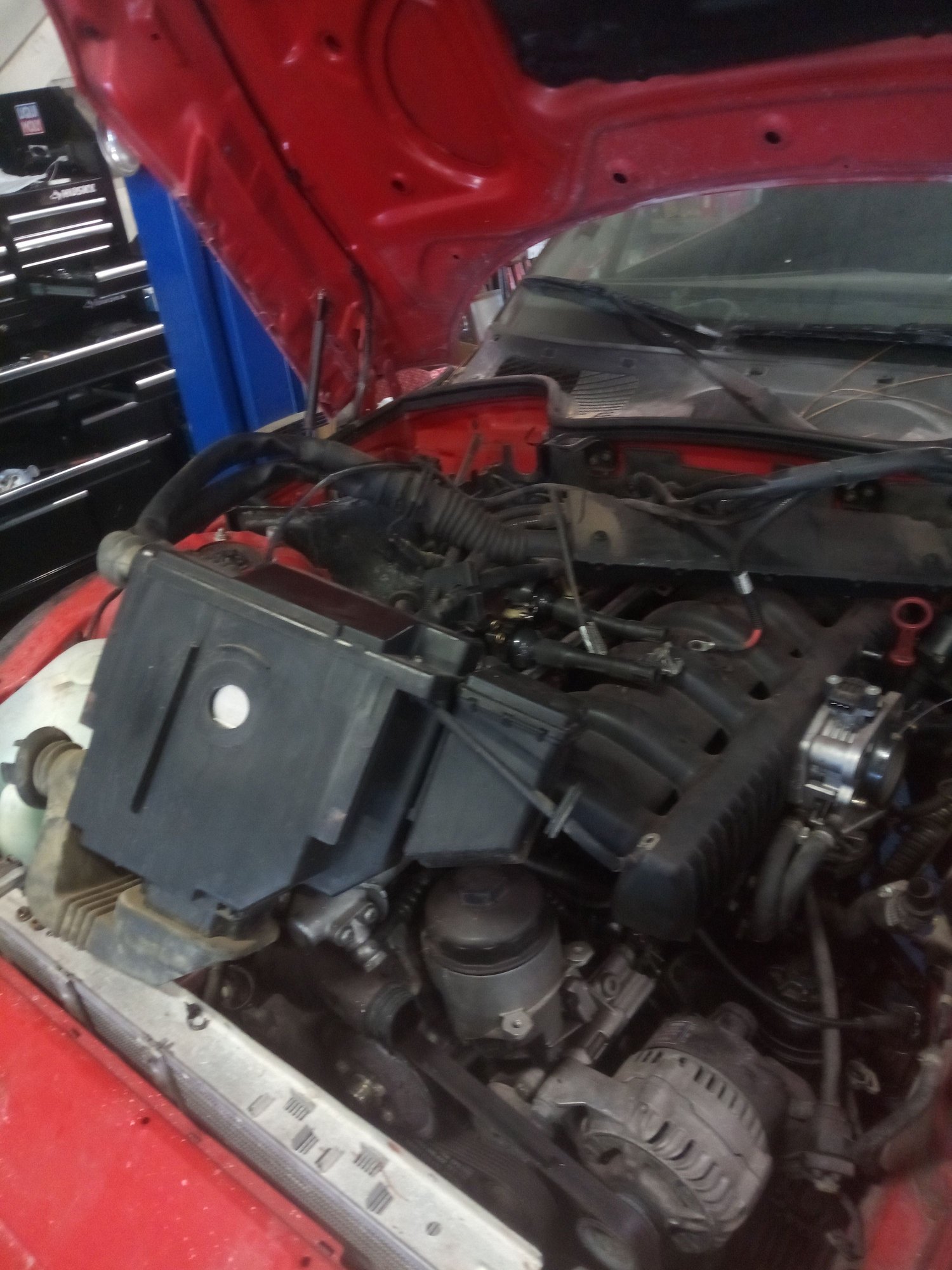

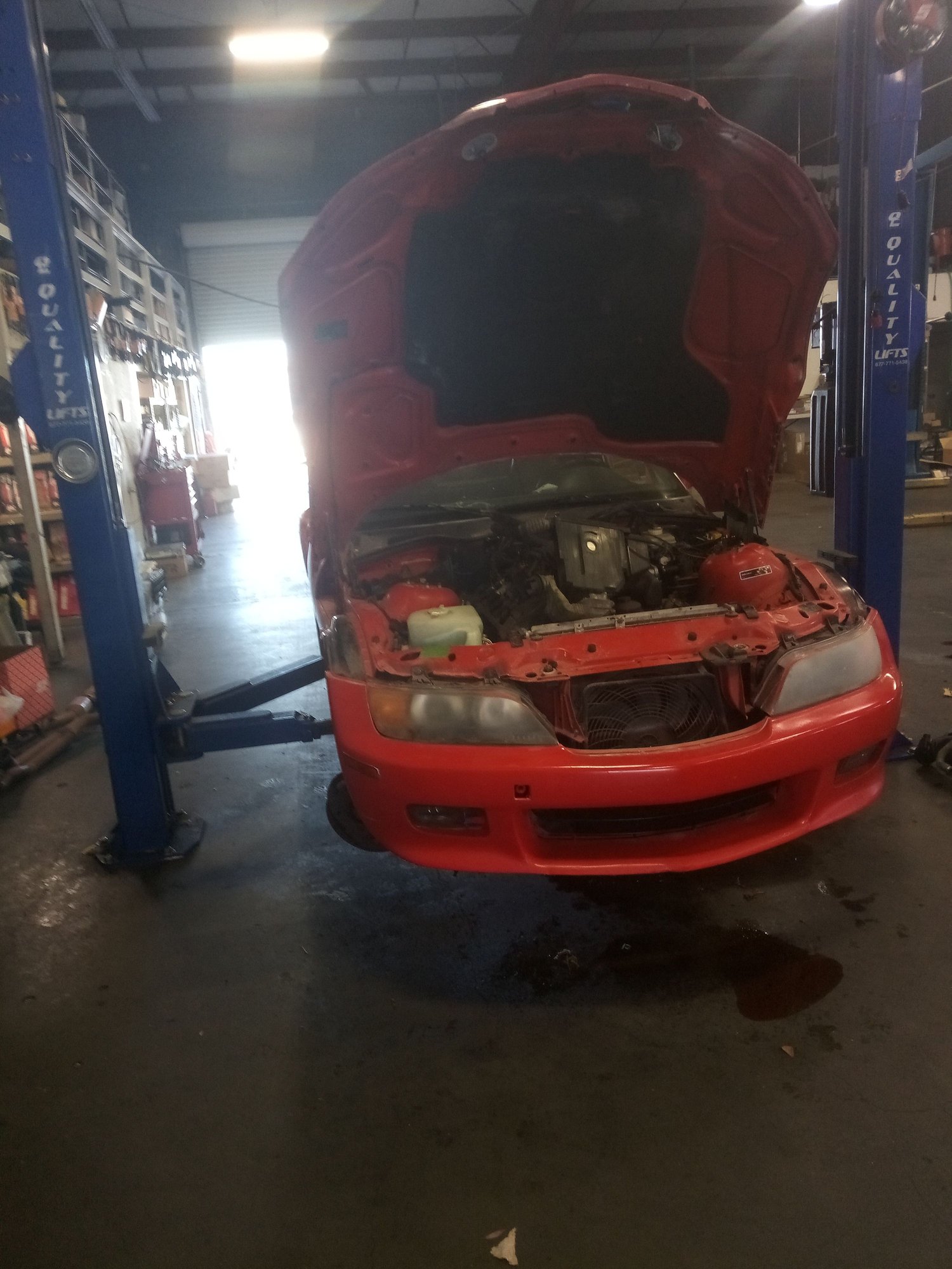

Transplant pictures, out with the old in with the new. First time I have really been under the car for a good inspection, mostly good news, no suspension surprises, the diff hangers are solid the tires are good but are aging by the looks of the date on them. No leaky issues on the parts that haven't been removed. The con, the lower area on my car looks like a blind man painted it, well at least 1/2 blind anyway.
Looking for a parts car still. I could just close my eyes and order off of eBay but the cost of interior OEM BMW stuff takes the fun out of ordering or finding parts on the cheap. Pictures to follow....Tedd
Old engine on the ground
Just about to drop it out the bottom
Just about out
New engine is here
It's almost Christmas, unwrap the goodies
I hope the insides are as good as the outside
