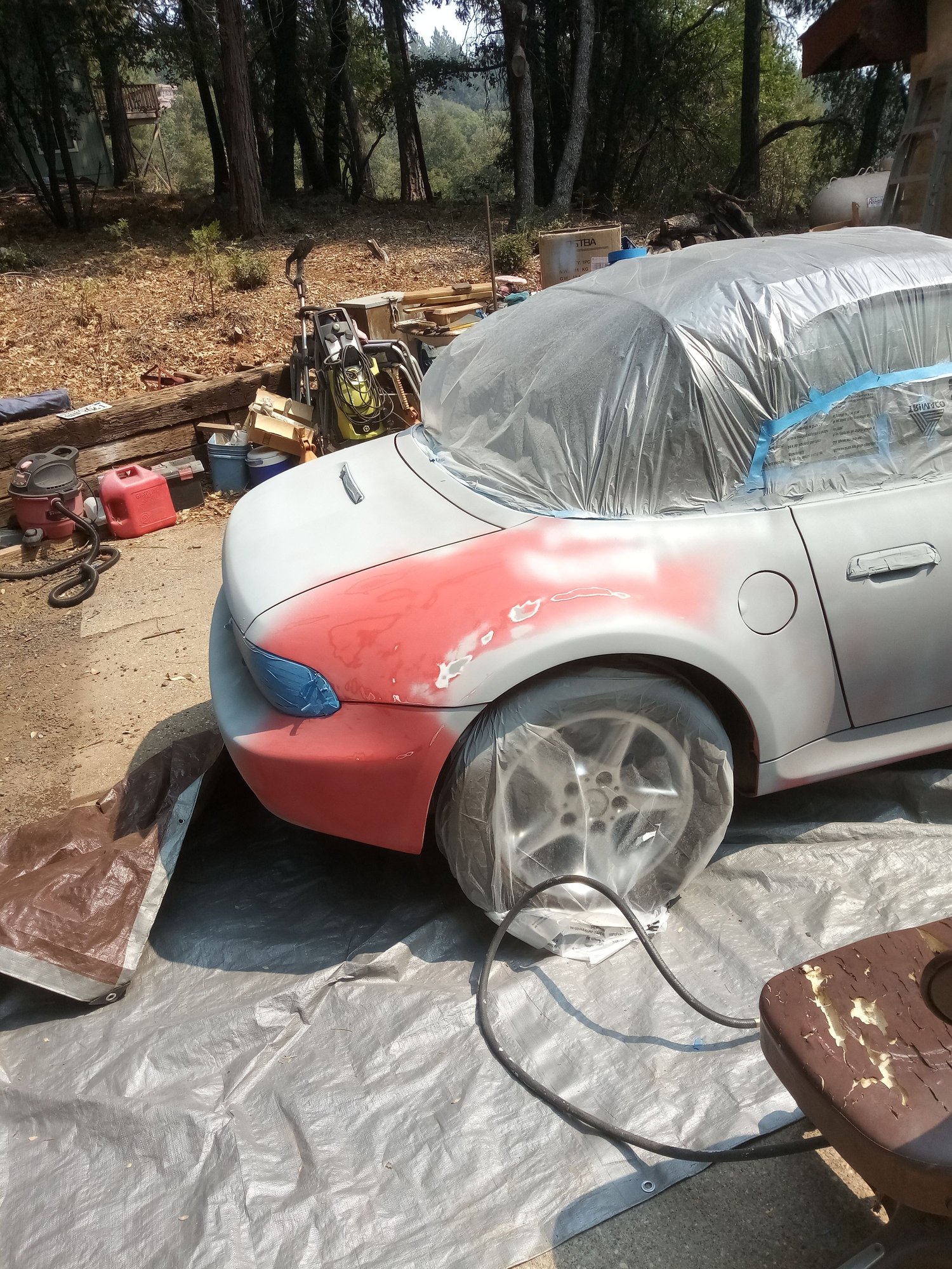

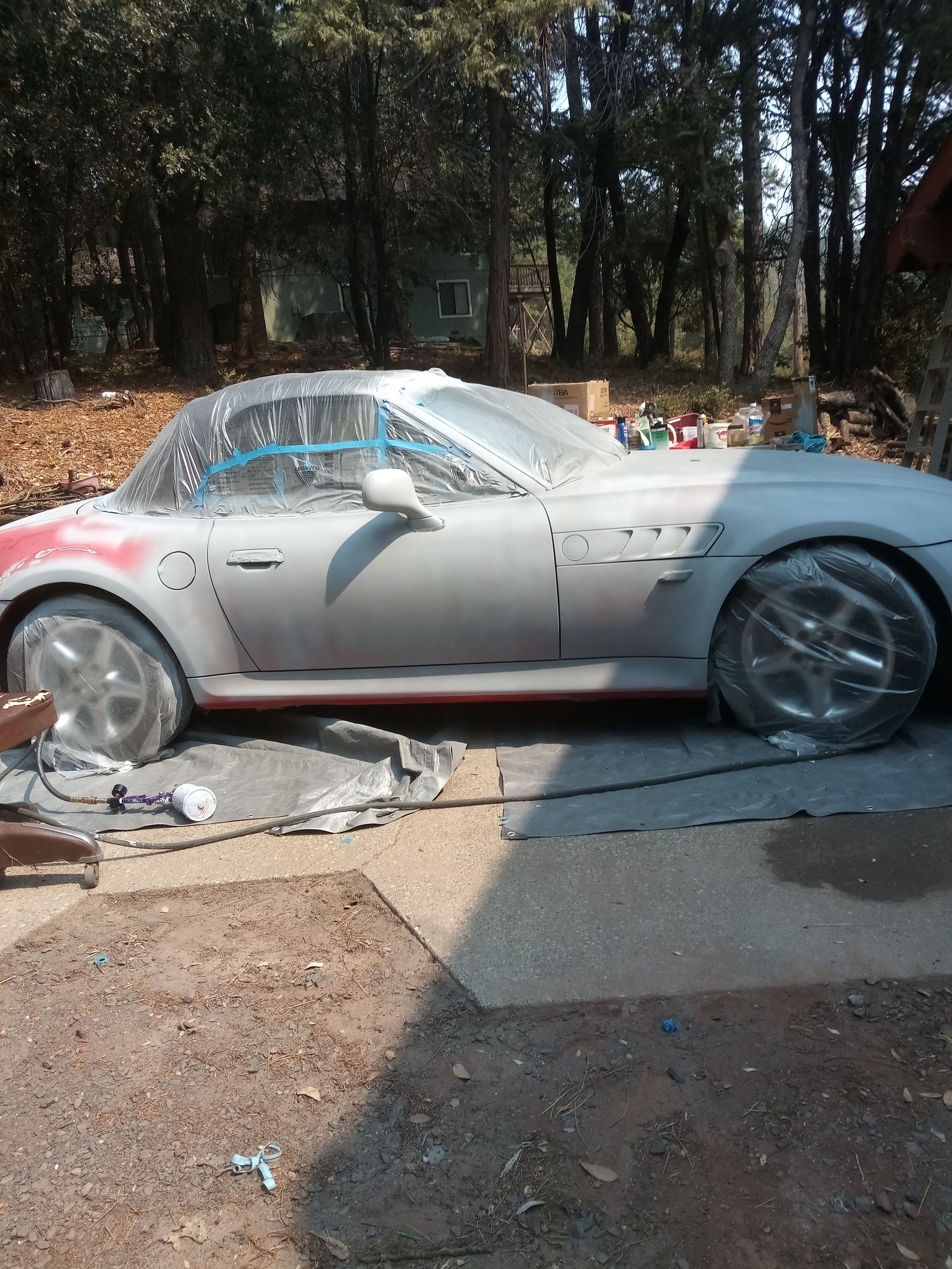

Well, she finally is in primer! I would liked to have said no problems but it was a fight till the end. I had troubles with the gun I believe it was a tiny piece of Teflon tape that was that was the issue mostly, found it late in the battle. Then there was driver error that came and went all day. spilled 1/2 cup of paint on the concrete and it dried before I could get to it, still there but it matches the concrete. Then the wind came up and spraying became a hit or miss affair, then my legs became rubber bands and I mostly finished the job on a desk chair that I could roll around with.
It was a steep learning curve and I was behind the ball all day, learned a lot, sorta enjoyed myself but the sad thing though is I realized the BMW will never be a show Queen she has to many warts and scars to go far in that world. Hopefully she will put a smile on my face like the Miata and be a fun driver.
Only two coats of base and a couple of clears to go and she will at least look presentable. Luke will be here tomorrow and maybe figure out the security system so I can go for a ride..... Tedd
She is loosing her spots, no longer a appaloosa but a Gray Ghost

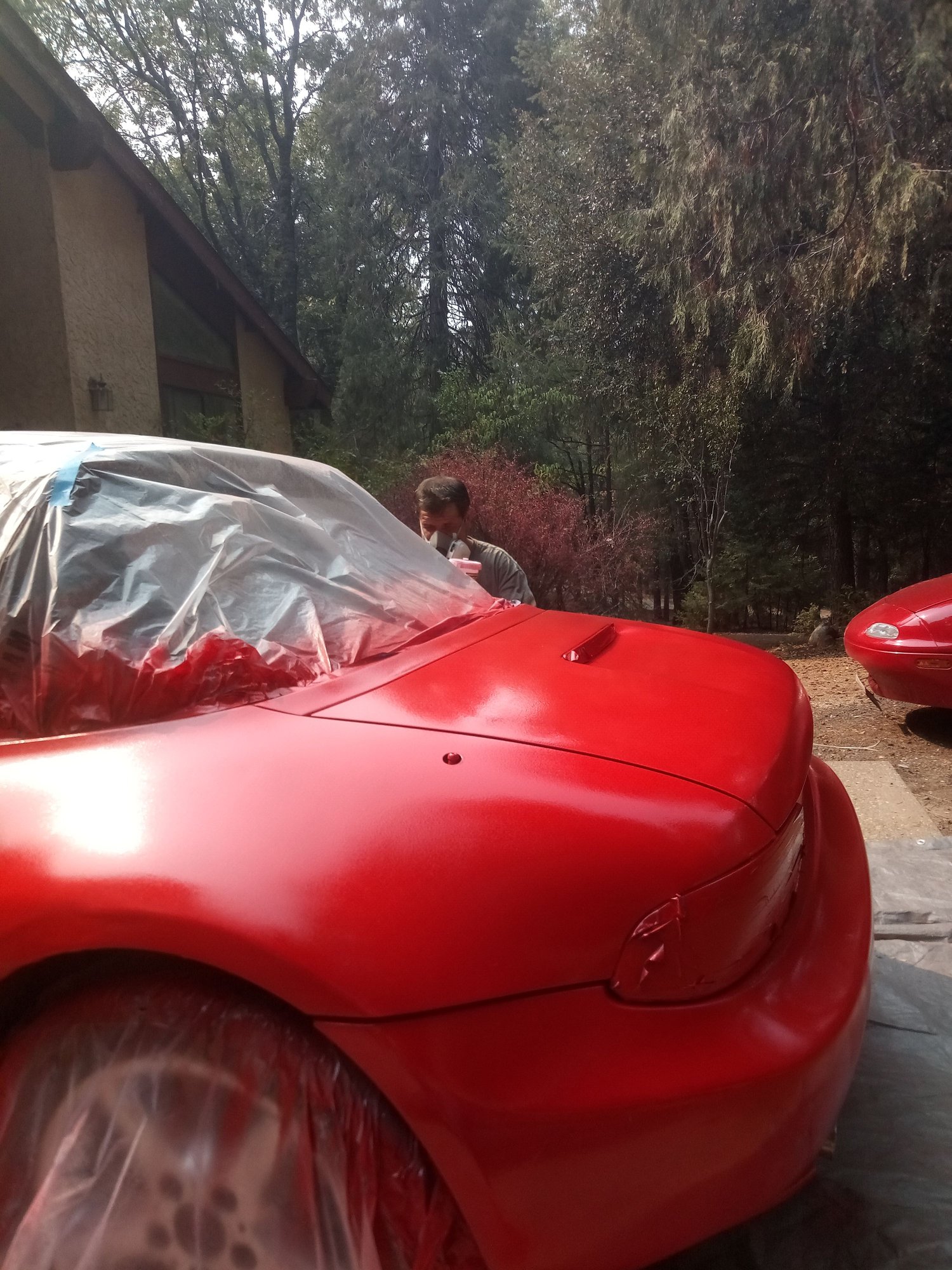

Here are a few pictures of MPB with a couple coats of clear. Pictures look better than the car looks in person. I'm working on the orange peel( cut and buff) then I'll give it another coat of clear. I think the hot temperature and lack my of knowledge is is kicking my butt getting the thing to flow out like I know it should...... Tedd
This may be only one coat of clear
My friend Dan shooting the low stuff, thank you Dan

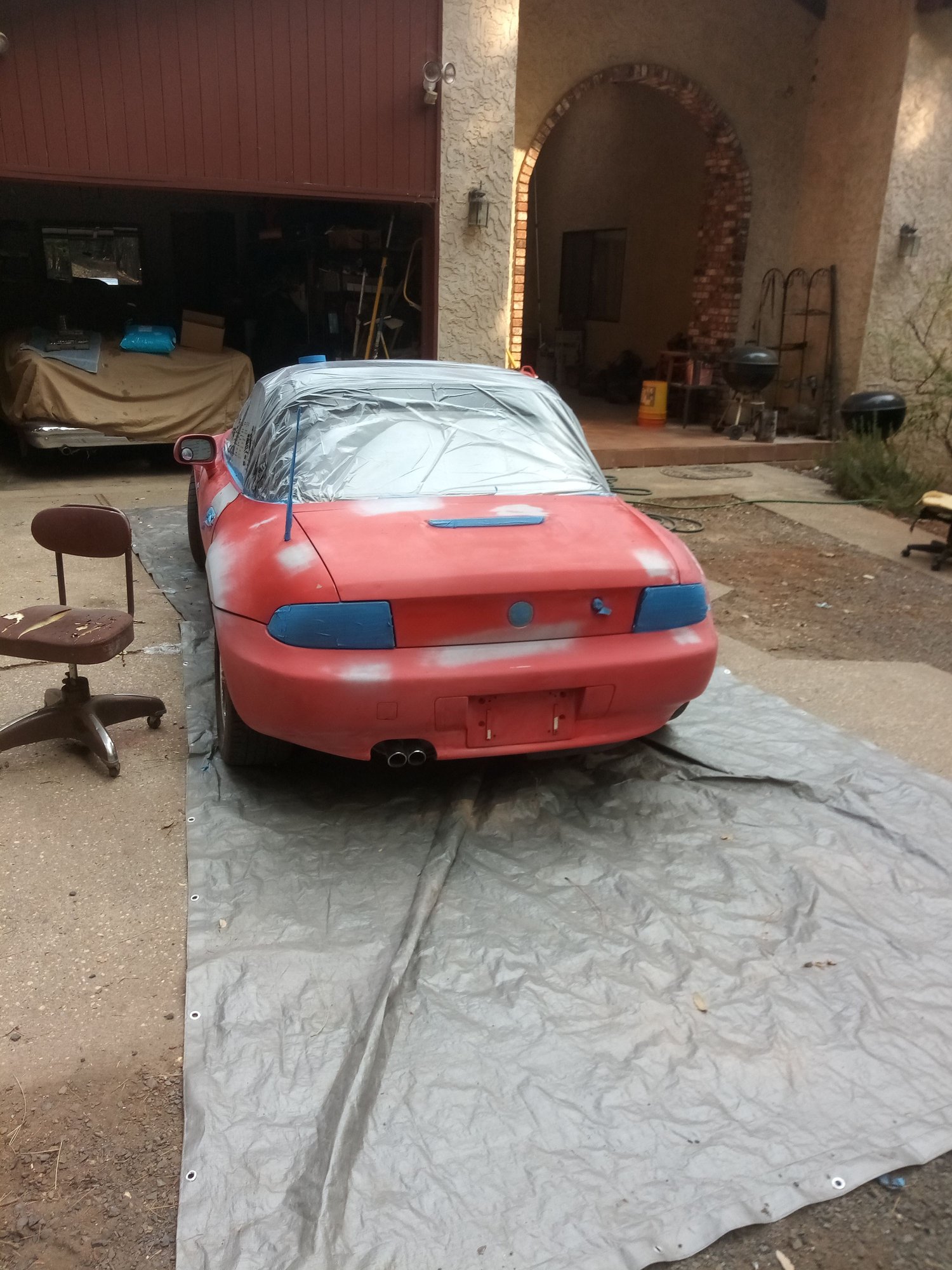

Well, I got a little pissed when I tried to remove the orange peel, it was going to take a huge amount of hand sanding and would still look like a patch work quilt. I got after it with a DA and ground it down to he color and beyond in some places. That what happens when most of your toys are show quality I just didn't want a ugly duckling in the stable. I'll either learn to spray decently or I'll let someone else take a whack at it.
Dan was a little shocked when he came over tonight the MPB look worse than when he was here working on it this morning. I told him it needs to be better than just red, it has to look good also. It will get done but in the way I want it to look. Good enough is not good enough. Sorry for the length of this thread...... Tedd

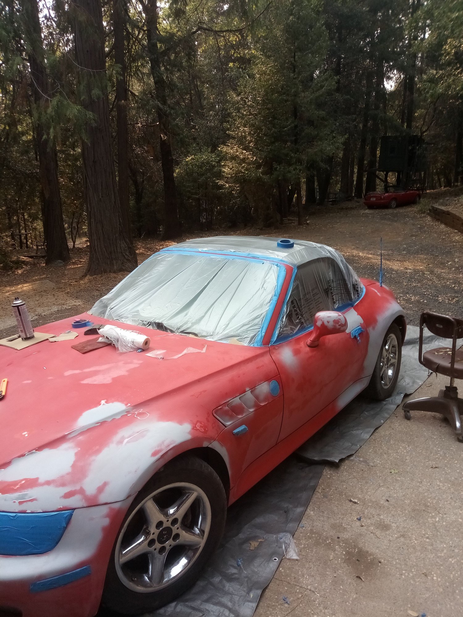

Well one step forward and two back. She looks much like it did a week ago, grew spots and everything. Now If I can find the combination to get it to flow out I'lll be a happy camper. I would rather put some work into it now than hid it in the garage the rest of it's life. Here it is as a appaloosa again.
She has spots again but is smooth. I'll see if I can do something with it.

Actually the one picture of the trunk lid is after a small scrub with a DA and a wash, lots more to come off to be really baby butt smooth, it's almost like a guide coat to see the area where I need to concentrate on. As you can see it's everywhere.
I'm headed for the paint store today for some paint and advise. If I don't get smarter this time I'll watch someone else paint the damn thing. I need to move on their are other projects that need to be finished before the snow flies..... Tedd
