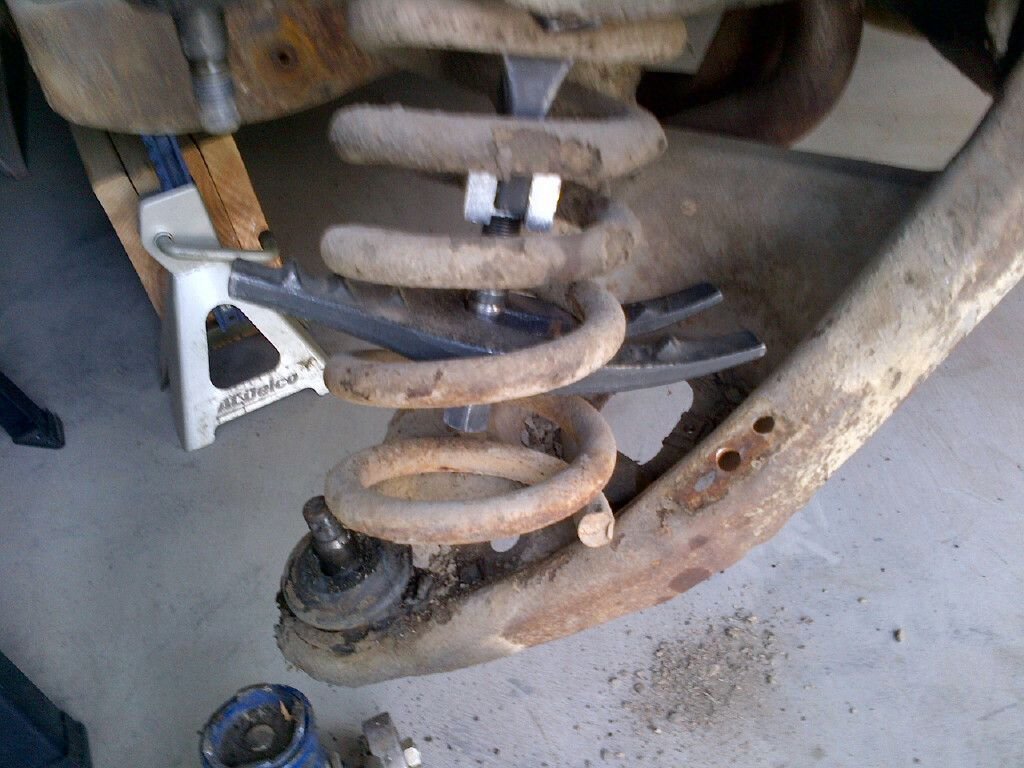

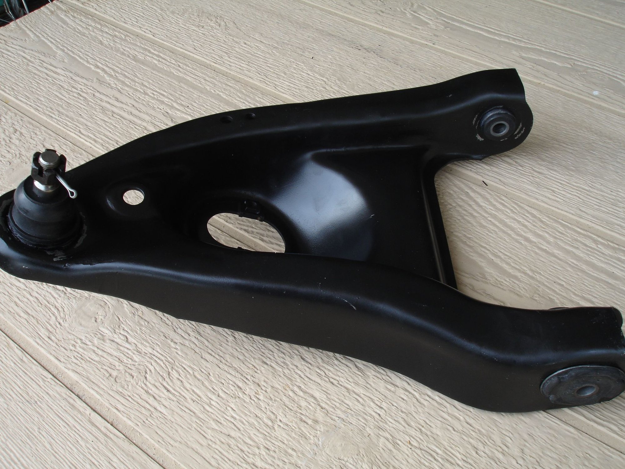

Some of you have probably used this technique, but there may be a lot of people who have never heard of using a molasses bath to remove rust from fall off parts. I have used this method to clean up most of the front suspension parts from my '71 Cutlass "S" and if you are not in a hurry it saves a lot of elbow grease.
I used a 20 gallon tote which held parts up to the control arms and bumper brackets. The mixture is 1 part molasses to 9 or 10 parts water. Mix it up in the tote, drop in the rusty parts and let them soak for 10 days - two weeks.
When you pull them out they will have a coating of the dissolved rust which will wash off. I used a stainless pot scrubber to clean them up. Most parts will immediately develop a fine surface oxidation which will come off by buffing with a wire wheel. From there I hit hem with a degreaser and they were ready to paint.
Here's a few before and after pics..

Feed stores are the best source for cheap Ag grade molasses in bulk. Buying it at the grocery store is expensive and most of them only sell it by the pint. If the feed store doesn't have it, they will usually know where you can get it locally. Amazon is another option.
I mixed up a 10 gallon batch and over a period of about 6 months, I de-rusted and cleaned up both left and right A-frames, spindals, rotors and calipers, the front and rear bumper brackets plus numerous linkage rods, shims, nuts and bolts. My experience with this car has been that if it isn't rusted, it's going to be rusted and broken. I'm just trying to get the car stabilized, cleaned up and running again. It's been parked for over 25 years.
Like I said before, if you're not in a hurry and don't want a toxic mess to get rid of when you are done, this is a method to clean up your parts with no big investment. The down-side is; don't do this anywhere inside and wear gloves. It will stink up the place and stink up your skin.
