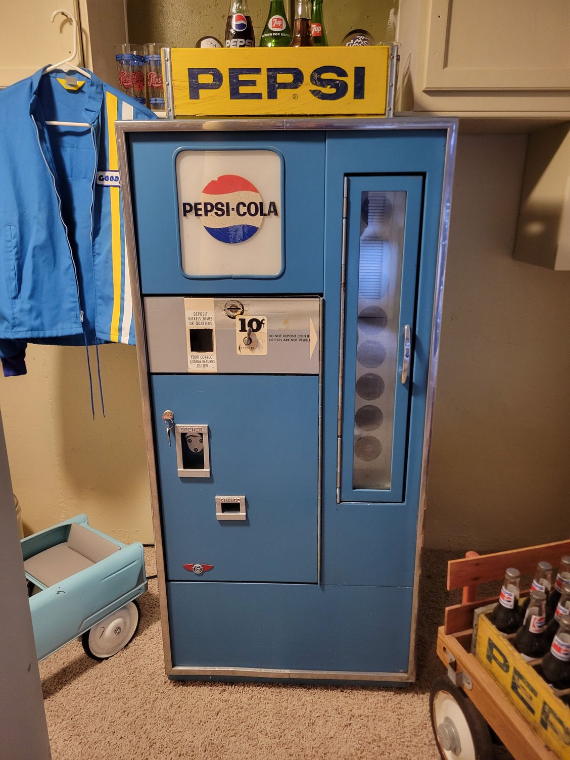

I have a 1961 SelVend Pepsi machine I bought back in the late 80's from a local auto parts store that was closing up. I used to buy pop out of it when I would go there and get parts for my Dad and couldn't pass up the $10 asking price for it. It still works, even though I don't run it very often, but decided to plug it in the other day, only to discover the cord needed to be replaced. That turned into an event because most of the wiring is pretty brittle now. So I've spent several hours today searching for restoration parts for these old machines and all I have found is a SelVend service manual. I'd like to replace the entire harness and door seal, if possible. Anybody have any ideas?

Can you post pictures and model number? Perhaps a member can point you in the right direction with the additional info.
