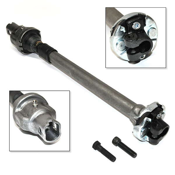

Nothing doing on spreading shaft clamp and driving downward there seems to a a small rod going inside the middle of the splined shaft and extending into the intermediate shaft it's about an eight of an inch in diameter any clue what it is ? If I pound like hell on it I'm going to bend it

Ok I got it shaft had to be slid up toward firewall in order to pop knuckle off that piece is just another part of the spline .

If you are talking about the large housing on the LH side of this photo, that comes off the splines with the rest of the steering shaft. The housing is a combination slip joint and u-joint. The cross pin you talked about fits into two square blocks that pivot on the pin and slide up and down in the housing. The housing itself has the splines and pinch bolt that fits over the bottom of the steering column shaft. The shaft you removed should look like this photo.

your exactly right .of course it all made sense once it came out. the car is in a dimly lit garage with no drop light very limited tools and covered with grease . reminds me of the old days

steering link
this is the best pic i have regarding that pin just posting it in case someone else runs into this
