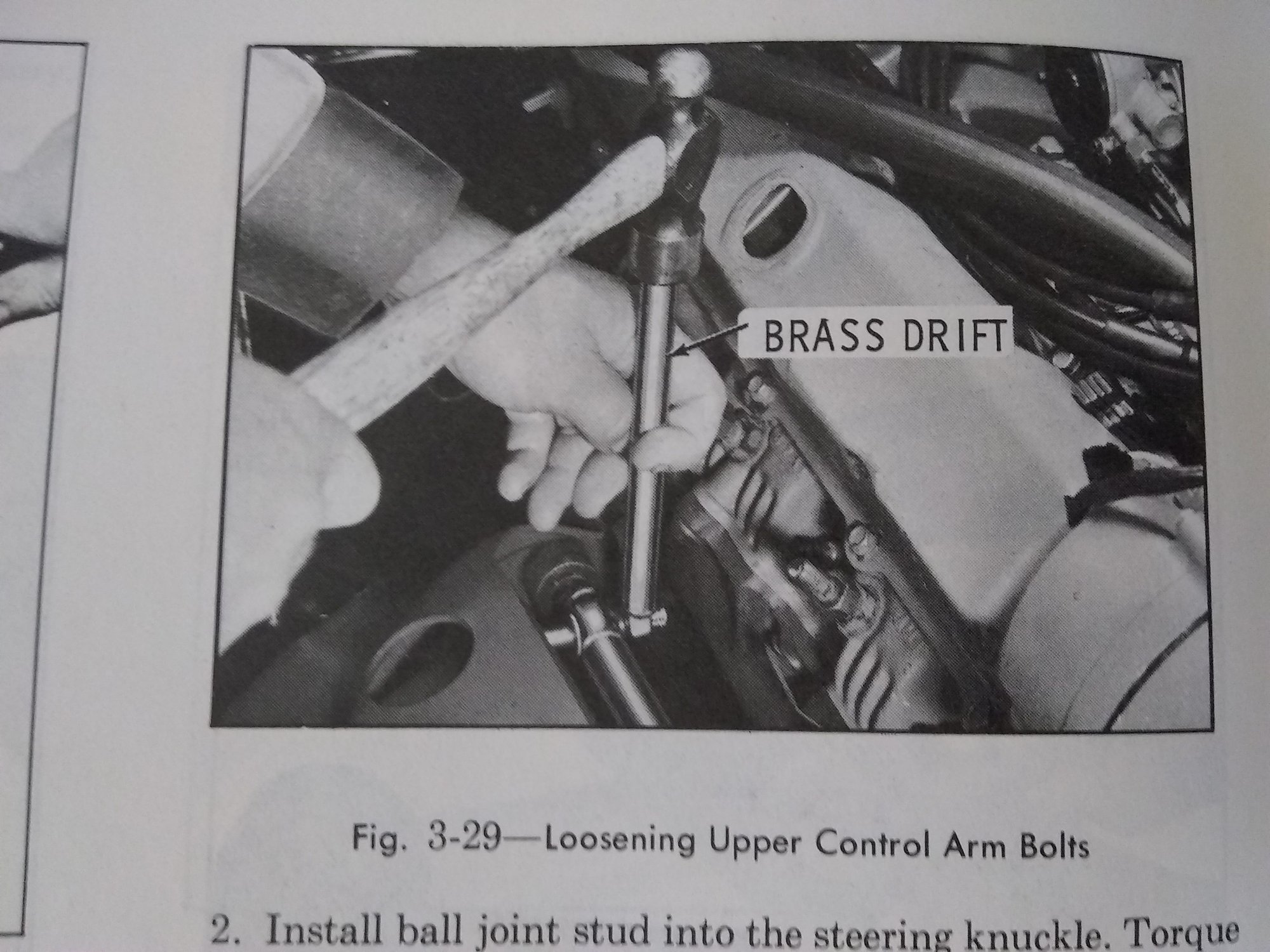

Posts: 50,802
You can (and must) hit them pretty hard. These photos are from the CSM.

ho heat shield in their picture. Will have to put wood against shield. Assume if I am able to loosen with the punch it shouldn’t take a ton of force to push out.

The other thing to note in that second photo is the wrench over the nut when they are using the pry bar. The text tells you to use that wrench to wiggle the bolt while prying.
