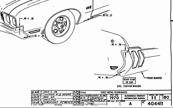

What is the proper gap(spacing) between the top of the rear bumper and bottom of trunk lid on a 70 442?Thanks.
In the assembly manual for 1970 - maybe this help you. I don't see a sketch for your exact question, I would gather if you get these two dimensions in you will be fine with the gap.
