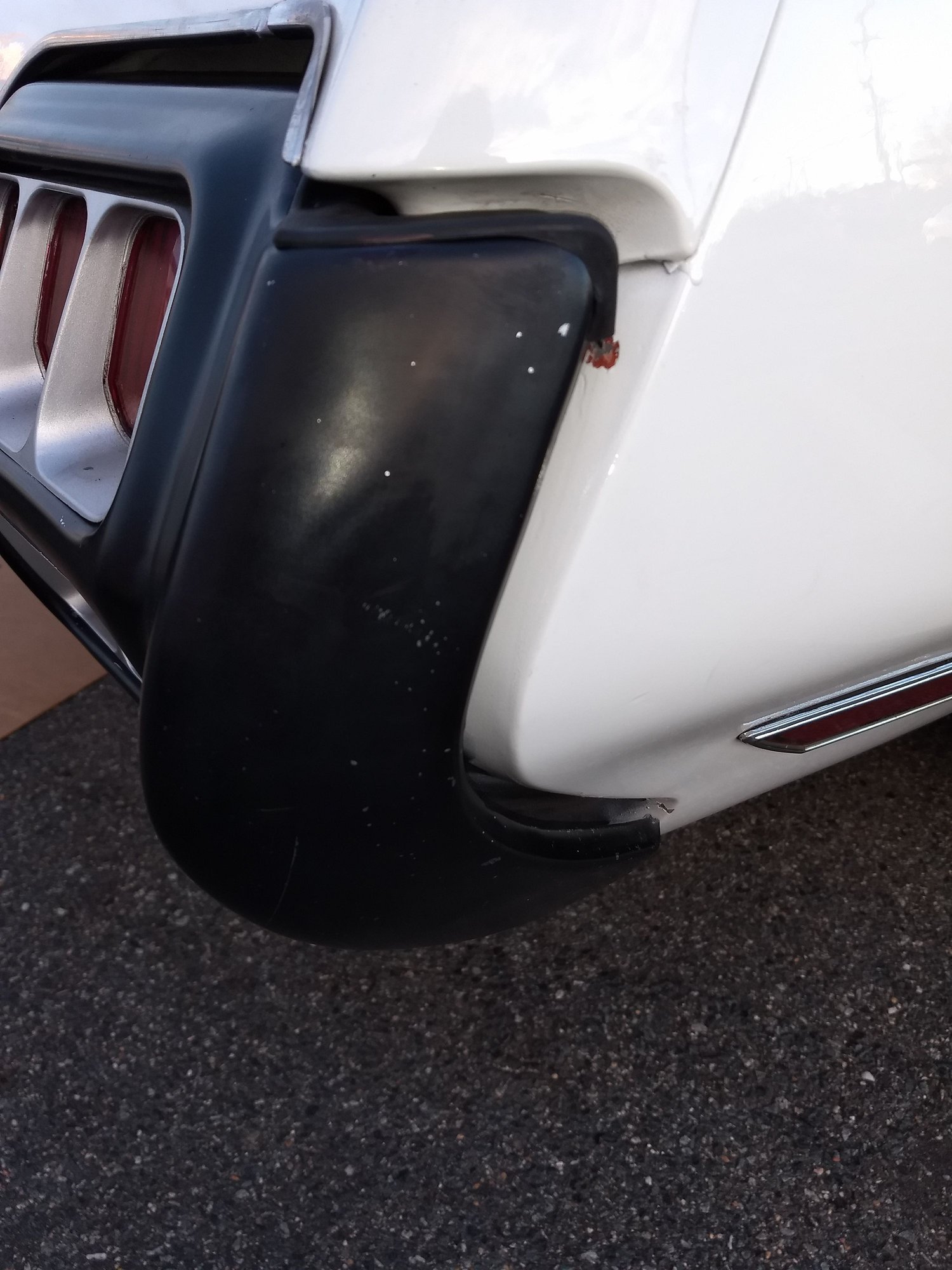

I got a chance to work on installing the rear bumper fillers before I head to work . It went relatively smooth and I'm happy with the results so far. I still need to close the gap between the bumper and the body, and I'm guessing that I have to do this with the bolts that hold the bumper onto the braces, am I right?
Here's a couple pics:

Yes Dave,

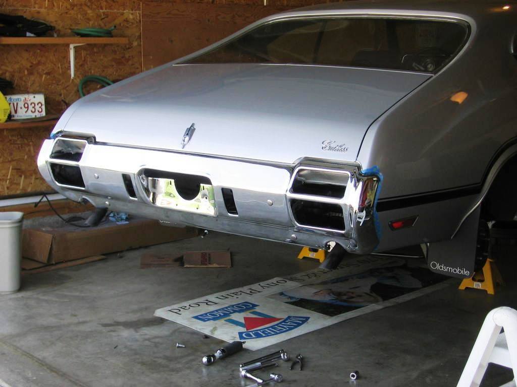

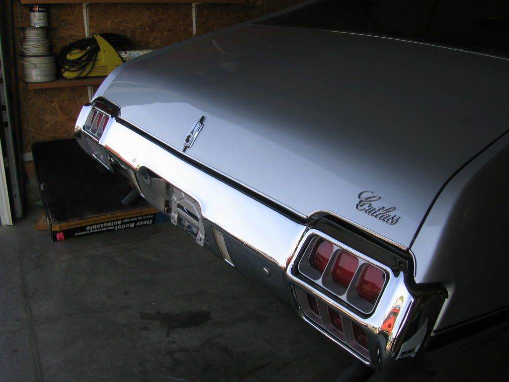

The gap you have is way out. You adjust this by loosening the bumper bracket itself, not the bumper. There are 2 slots in each brace that allow the bumper positioning. Here's what mine was before and after. It took about 35 minutes of adjusting to get it just right.
Stock bumper left side
stock bumper right side
test fit
test fit - note tape to protect paint
test fit
final fit

Thanks Allan...that covers the gap on the ends...what about the gap between the bumper and the trunk lid?

I guess it's not as easy to see in the pictures. The gap between bumper and deck lid is a uniform 1/2" all the way across, including up over the tail lights.

Before my final adjustment and after...
Before:
After .. much better now😀
