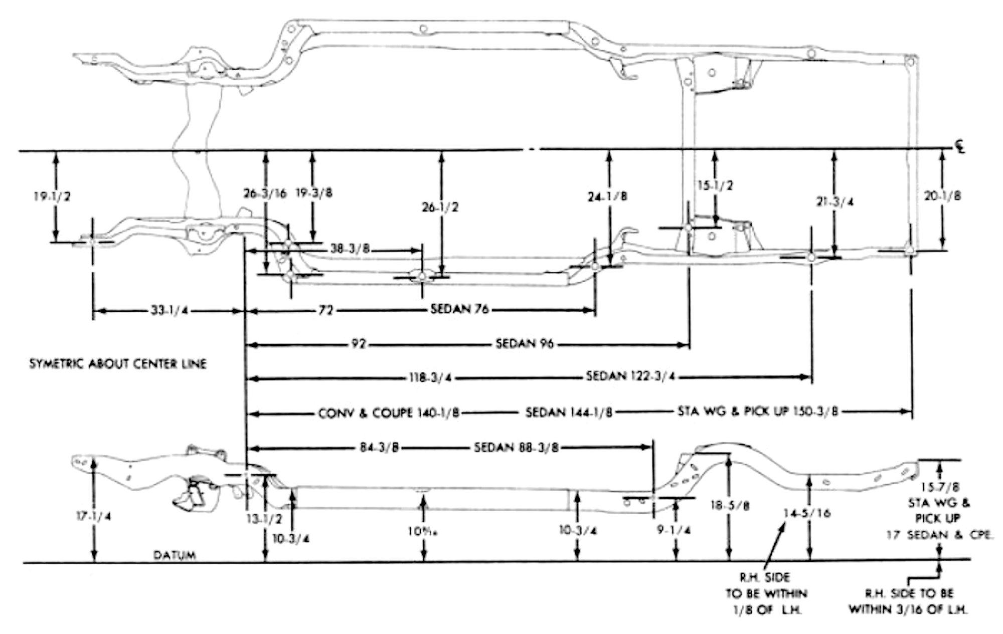

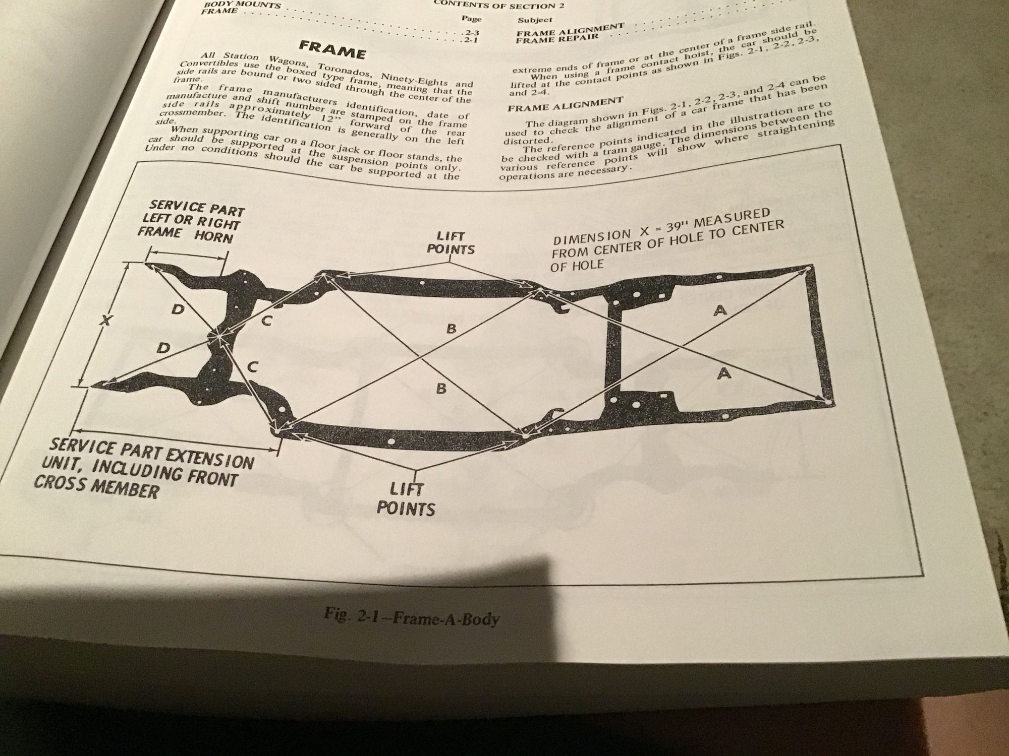

Does anyone have dimensions for “A”, “B”, “C”, and “D” as shown in diagram of a 1972 A body frame?

I pulled this image off the web years probably 10-12 years ago and found it to be accurate when I did the frame-off restoration on my '72 442 convertible.
Rodney

I dont’t know the actual measurements, but if you’re trying to check if the frame is straight both of the A, B, C, and D measurements should match each other. If one side is longer then the frame is tweaked.
