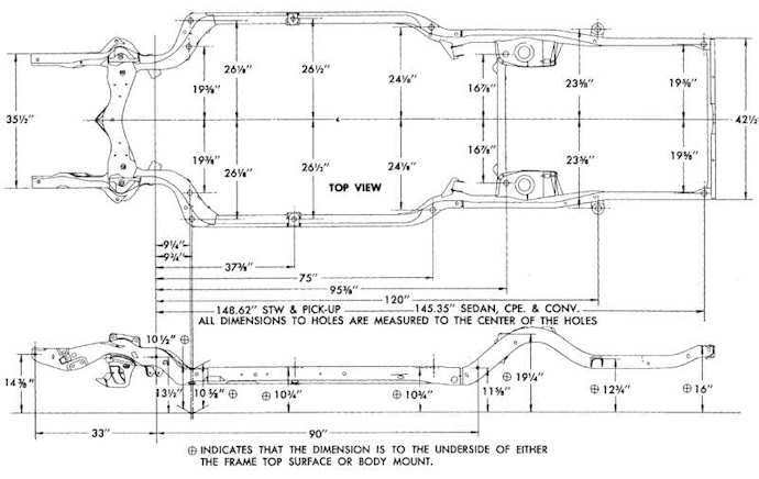

Frame Dimensions
This what you are looking for?? Hope so..
If not email me: thirdcoast47@gmail.com and I will email the drawing to you.. may be better as it shows on my screen much better..

Frame Dimensions

Thirdcoast,
Not sure, I Think that is what I saw listed a chevelle I thought they were different but I'll print it now and check it in a couple hours and report back....
The differences i read about were in the length behind the rear wheels so they may not matter so much in getting it square..
I appreciate the help. It will get me moving

So my frame is about 1/2” wide consistently all the way down, but it is square.
now……I’m measuring by myself. Center of hole to center of hole
