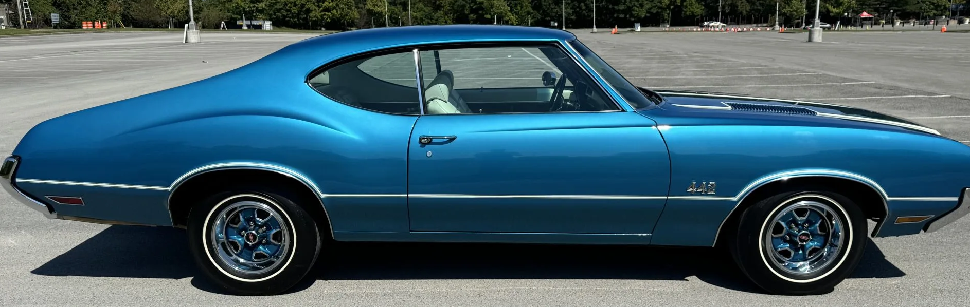

Oh yes, very strong dollars for a verifiably fake 442. Looks like after 8 months the seller lowered the price from 70k to 65k, according to the comments. And the comments there pull no punches. Not sure what decoder they used, but it was born a 160 hp 2bbl Cutlass. And its not W29...
Wondering if the current owner took a bath and is just trying to recoup with that outrageous price.

W-30 money for a Cutlass.

This. Crazy money for a Cutlass.

You guys are missing on this car. It's not your ordinary Olds Cutlass but an Olds Cutlass with a ROCKET 350, huge difference.

They almost had me as a genuine 442 with perfectly mucked up side stripes until I saw the emblem mis-alignment on the trunklid. Yikes. That bumper droop and tailpipe exit looks terrible.
WAY too much money for this one. But, if some fish bites the bait, so be it. I know it won't be me.

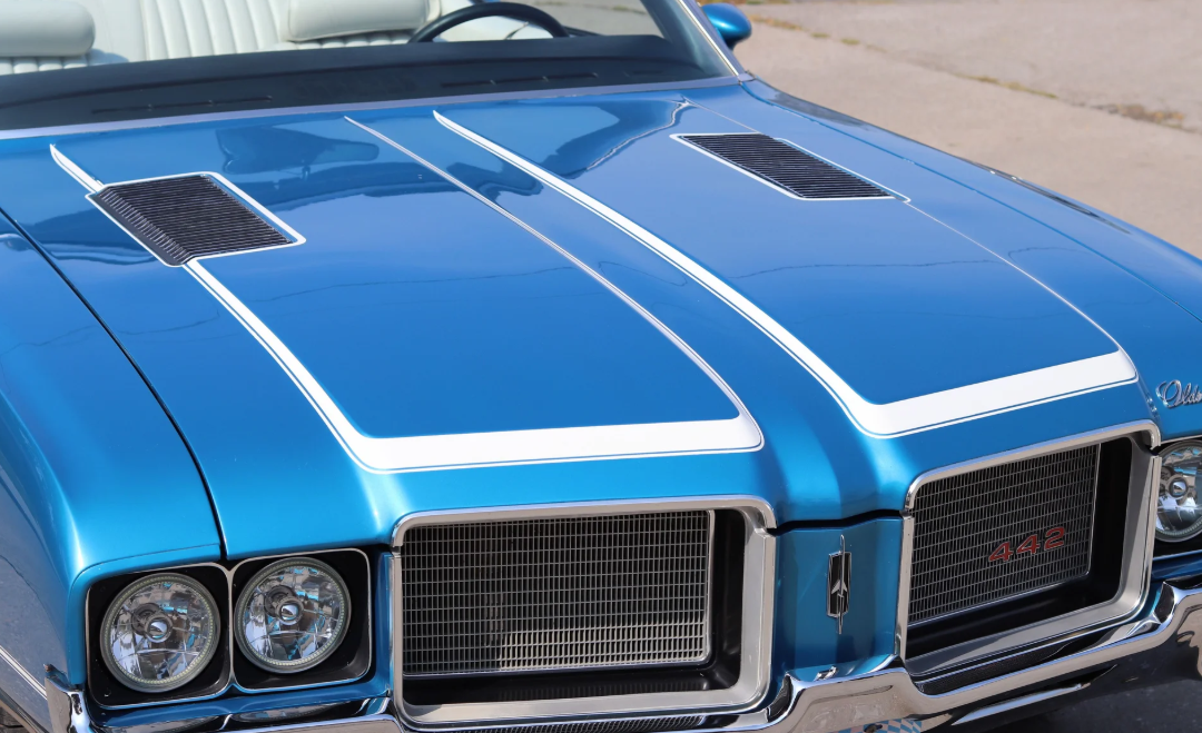

Fantasy money for a Faux Four Two that was originally a VIN H 350 2bbl single exhaust car. I do give them credit for not succumbing to the repro hood and wing disease. I always liked the 1972 hood stripes. Of course it has the incorrect cutout bumper on a 350 car.

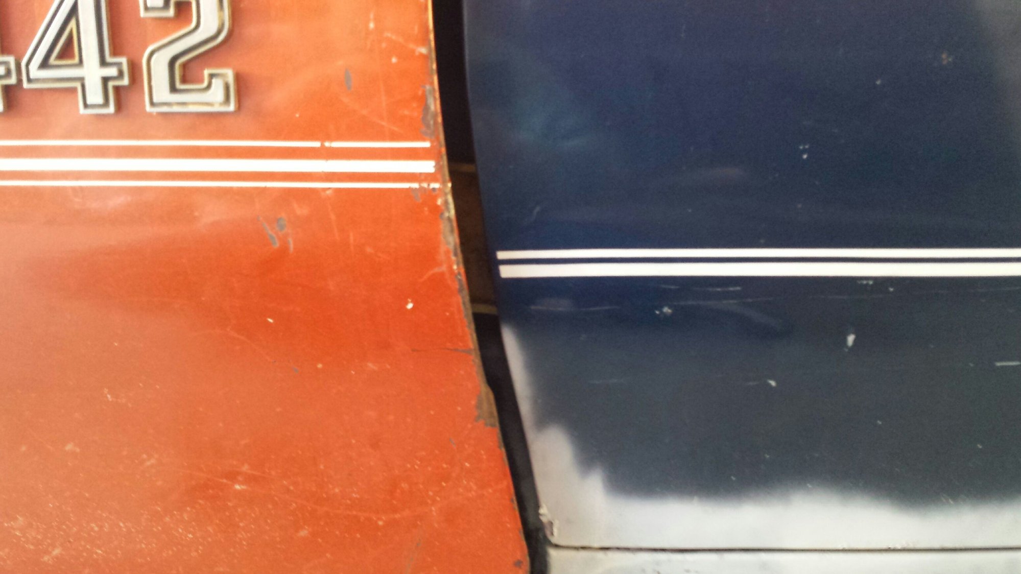

My 72 original 442 with factory OAI on a 455 motor has incorrect stripes after I finally repainted it. The Phoenix Graphics stripe stencils were the correct line spacing for the stripes BUT, they were cut to the lower position like the 1970 442's. I left them that length because the way the stencils were cut, I had to change the shape to match the wheel openings.....especially where straight line met the wheel wells(the placement doesn't bother me)! Also, the trunk lid stripe was 3/4 in short on each end of the trunk (like for a convertible). I called Phoenix Graphics and bitched about it and gave them the correct measurement and they re-cut and sent me a new one.

Yep, seen way too many 71/72 442 with the side stripes (non-W cars) with the 70 body break line hugging style. The 71/72 had triple stripes where the 70 had dual. Interestingly, the 72 steel hood stripes were decals that split and went around the louvers, where the 71 steel hood center stripe was painted, measured from the outside edges of the hood inward.

Side stripes should look more like this below if you wish to stay with the factory look, but the new car brochures like for 71 even had a lot of little "drawings" of the side views of all the models in the back of the brochures with 70 style stripe drop.

Here are 70 (RH) vs 71 (LH) side pinstripes
