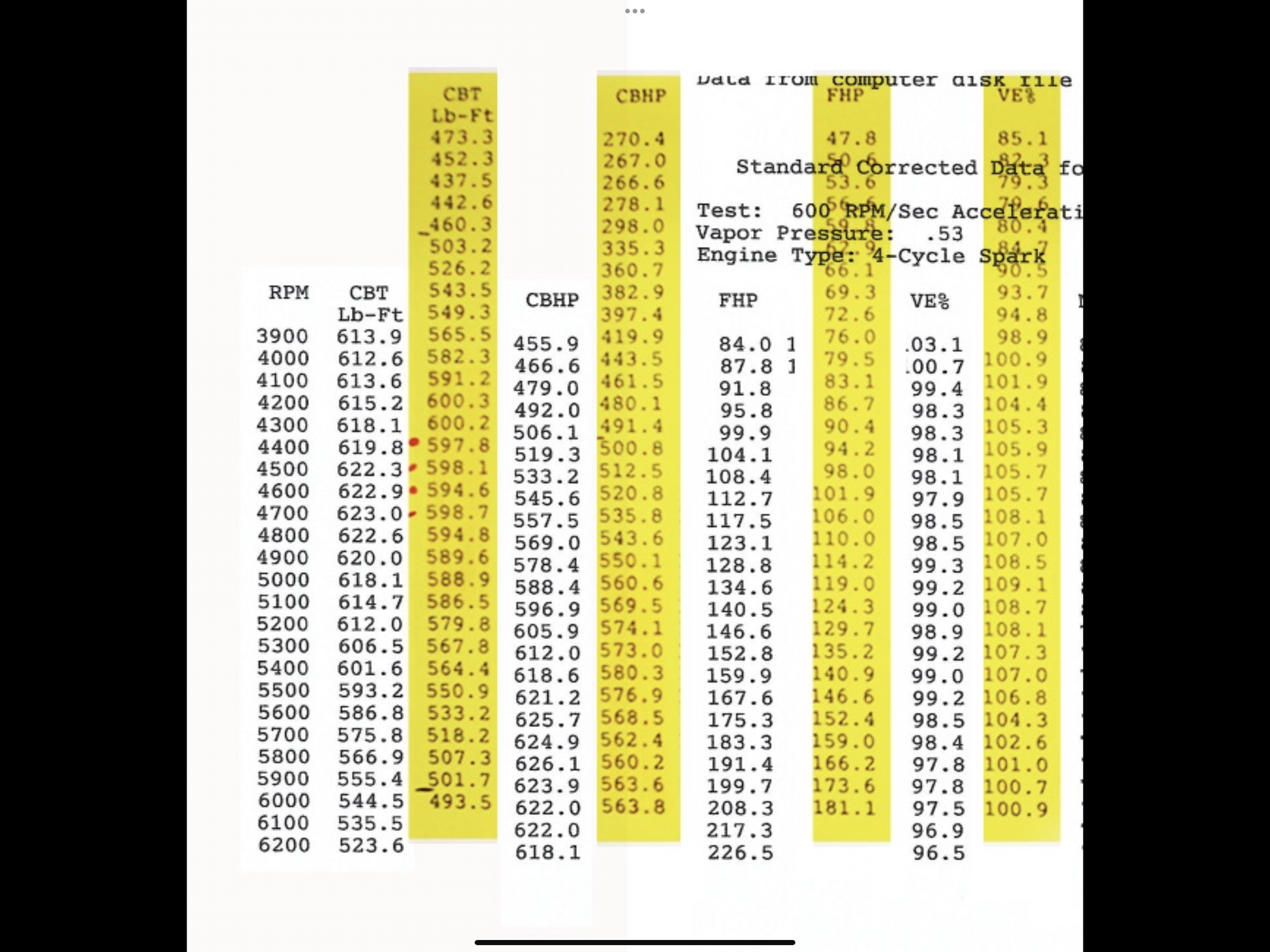

Old Sep 7, 2025 | 09:16 AM
Rallye469's Avatar
Joined: Feb 2008
Posts: 2,664
From: Jacksonville, FL
I get 1.58…that’s stock, no?
But with my 469… I had a 4.254 stroke for a 1.67 ratio.
(Same exact cam, heads, bore, carb)
600hp, 580lbft
‘So with an extra 26ci…it made 26 more hp and 43 more lbft
Im not sure whether that put the bigger ratio ahead or not.
but it’s interesting that it moved the RPM range up.

Old Sep 14, 2025 | 04:24 AM
CANADIANOLDS's Avatar
Joined: Sep 2013
Posts: 2,927
600hp, 580lbft
(the yellow is the 469(1.67 ratio)
look at your VE for the 1.67 rod, it peaked 10% better .. do you have the BSFC numbers for both of them? I’ll bet your BSFC’s are also much better
Old Sep 14, 2025 | 10:15 AM
cutlassefi's Avatar
Posts: 8,484
From: Central Fl
600hp, 580lbft
So the only change was the stroke? No other changes between the two, ie cam, heads, intake etc.?
Old Sep 14, 2025 | 11:56 AM
Joined: Sep 2013
Posts: 2,927
Yes, that was his m.o.
But Warren Johnson said the opposite, “just stick whatever rod you have in it”. Both were successful so…….
no, he didn’t say the opposite. if he did, then that would mean he said stick the shortest rod in it.
Johnsons comments were taken out of context by so many, including you. After that interview, the rod length internet gurus went nuts…just google it and you’ll see what I mean.
nobody in their right mind would build an engine on purpose with severe rod angularity which cause excessive side load on the cyl walls. look at any pro stock from his era and you’ll see an extremely short piston comp height and the longest rod they could fit, with a tiny ring pack.
THE EXACT same cam, heads, manifold, carb, headers, etc
The pistons were different of course, but the compression really didn’t change. 10.76:1 vs. 10.78:1 if I remember correctly?
do you have the BSFC numbers for each?
Old Sep 15, 2025 | 01:20 PM
Rallye469's Avatar
Joined: Feb 2008
Posts: 2,664
The full spread has the fuel consumption.
Old Sep 15, 2025 | 01:37 PM
cutlassefi's Avatar
Posts: 8,484
From: Central Fl
This is a stock stroke and rod length (4.25/6.735) vs a stroker with a 4.5 stroke and 7.100 rod correct? Sorry for questions, just trying get accurate info.

Old Sep 16, 2025 | 03:47 AM
Rallye469's Avatar
Joined: Feb 2008
Posts: 2,664
Mark- both used 7.1 rods
469- 4.185 x 4.254
496- 4.186 x 4.5
Old Sep 16, 2025 | 11:26 AM
cutlassefi's Avatar
Posts: 8,484
From: Central Fl
469- 4.185 x 4.254
496- 4.186 x 4.5
So if I understand your info correctly, the 496 with the shorter rod ratio not only made more power, but was only slightly less efficient?
