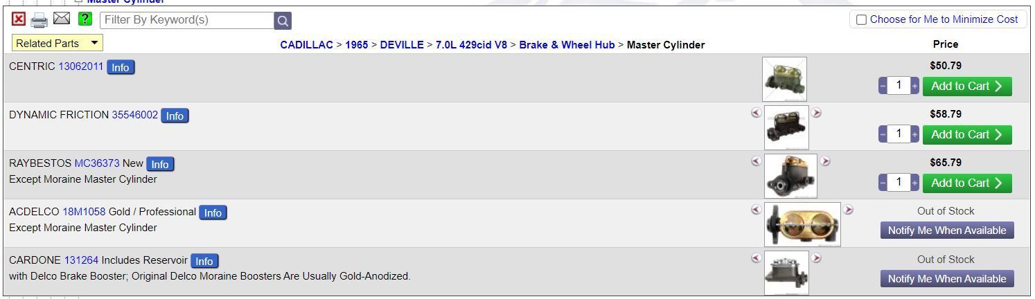

Thank you for the information. Rockauto lists a few for those years Caddys (see the screen-shot below) but have a footnote "Except Moraine Master Cylinder" which I'm not sure what it means; do they mean Moraine "booster", not master cylinder? And if that is what is meant, how do I know which booster I have, I believe my car has the original one from the factory in '66?

I found an ACDelco 18M1058 which is listed for the Caddy DeVille of those years you mentioned so it should work without any alterations; being this is a drum/drum set up, would you say a proportioning valve is necessary, I know they are needed for a disc/drum set up?,,,thanks
