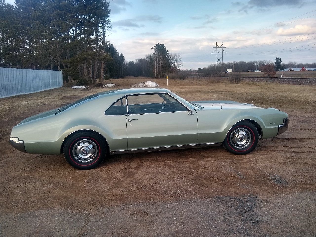

I have a 66 Toronado thats all original with 4 wheel drum power brakes, with a single res Master cylinder.
I don't want to upgrade to discs, as this would require different wheels. I would like to install a dual res Master cylinder for safety's sake. Does anyone have experience doing this and could offer some guidance? I can't be the only one who ever wanted to do this.

Just get a master from a '68 with drum brakes.
Love your car.
