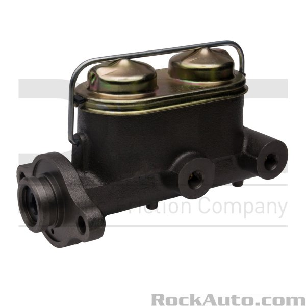

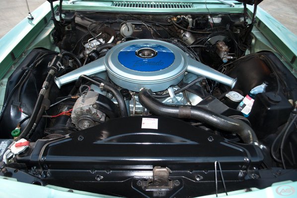

While the 1967 M/C and booster will swap in, it's easier to just use the M/C from a 1962-66 Cadillac. These were dual circuit and will bolt to your existing power booster. The 67 M/C requires a booster with a short pushrod and will not bolt up, which is why you have to use the matching 67 M/C and booster if you go that way.
This is the Caddy M/C, Raybestos MC36373 or equivalent. About $60 at RockAuto.
This is the 1967 Toro booster and M/C.

So you mean that a 66 Cad mc will fit on my existing booster? Will the Cad booster work as well if I have to replace it? Also, didn’t the Cad have disc brakes?
Old Jun 8, 2021 | 05:27 PM
Posts: 50,770
No, the Cad didn't have disc brakes.
No, the Cad booster won't work.
The whole point of my suggestion was that you didn't need to touch the booster, just swap the M/C for the Cad one. If you need a booster, just get the 67 Toro booster and M/C.

It looks like finding a used one and having it rebuilt is about your only option. There is limited demand for this and it appears that no one makes new ones (or even stocks rebuilt ones) anymore. Any 67-70 Toro booster will work.
