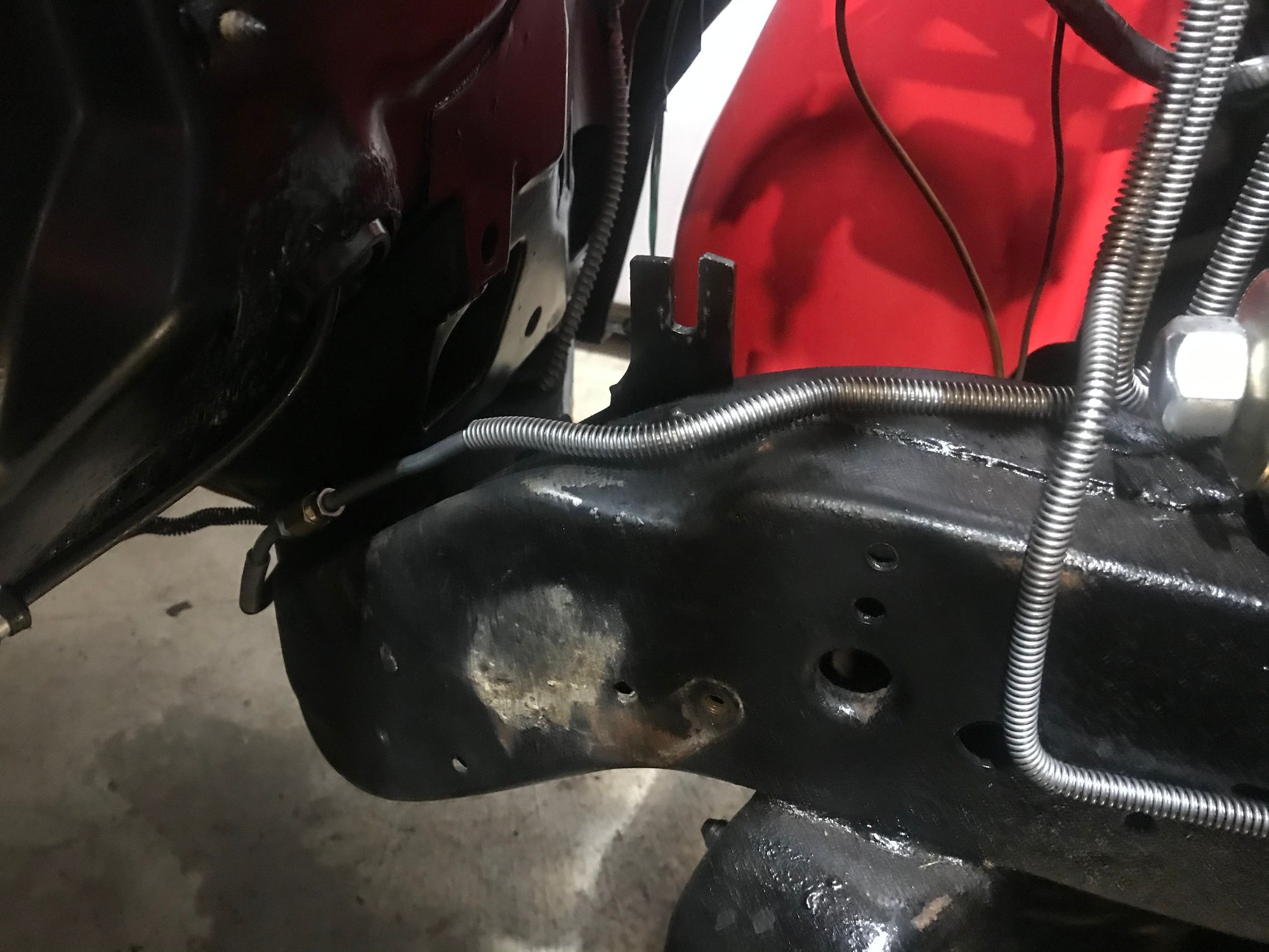

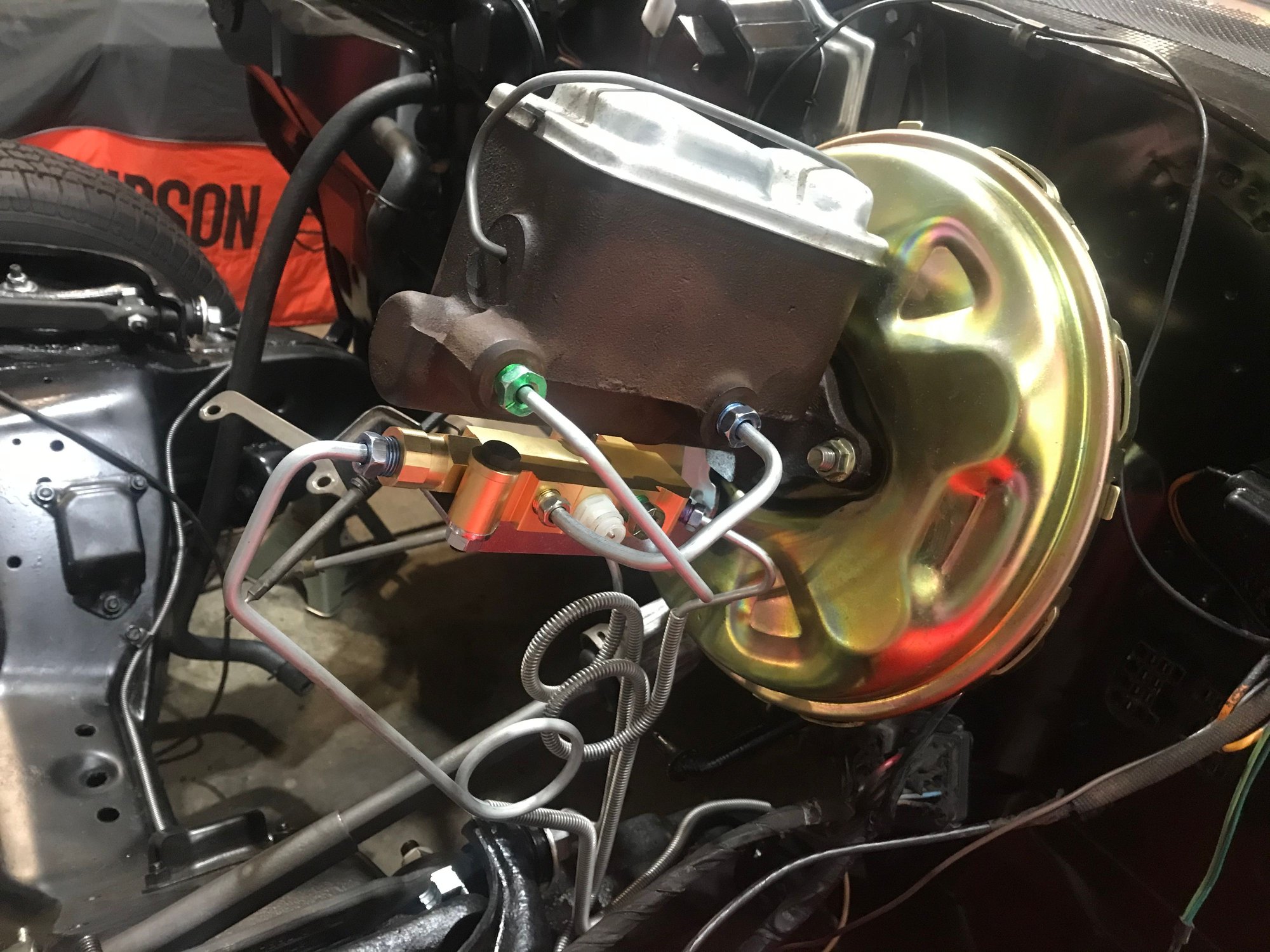

I just did this with parts from Inlinetube. Turned out very nice. The valve mounted directly under the m/c. There are two new lines to go to the two front wheels (disc) and a line that goes to the rear down around where the old lines all hooked up. I had to cut my old rear line in a spot add a coupler and flare and connect it to the new line. Worked pretty slick but had top massage the lines a bit.

I have just purchased a front disc conversion kit from the Right Stuff and, as mentioned above, they also have everything necessary to avoid piecing the new system together. I'm going with a manual set up so I'll be changing the master and it has a new prop valve that mounts to it. They sell a new hard line kit that will replace everything, front to back, similar to the factory lines but connecting to their new master and prop valve.
I did a fair amount of research and comparison shopping and this seemed like the best/cleanest option to avoid splicing to the original lines. Also, I've used their stuff before and have always been very happy with their quality and service.

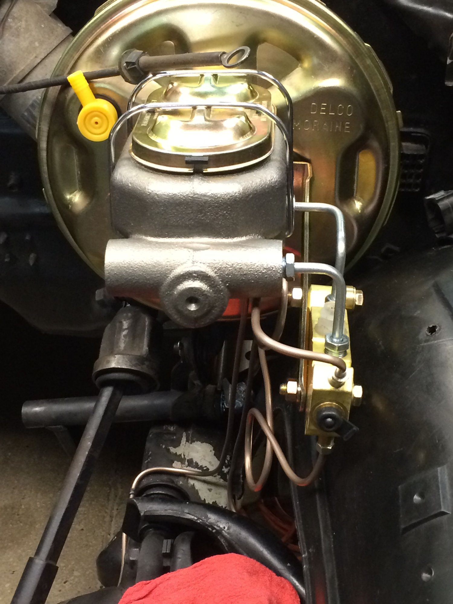

I think I bought the valve from ILT and coupled some nickel brake line on to the rear line.
Used the same tubing to do the fronts.
