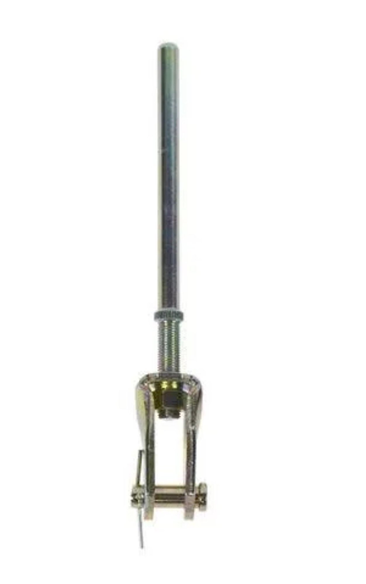

I assume you have a provision to ensure that the pushrod can't fall out of the master cylinder cup, such as this reproduction from Inline Tube.
The push rod that I have is smooth, no indent.

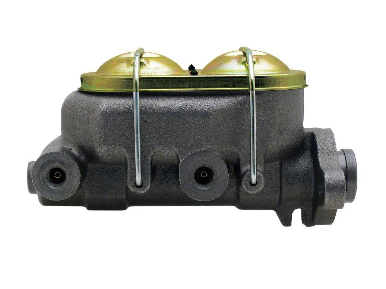

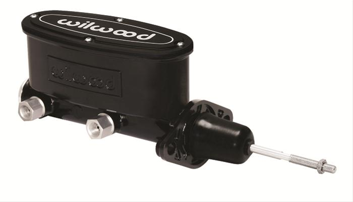

Are you going for a factory look, or aftermarket on the master cylinder?
You can buy a stock-is style (no bleeders) like the one below from many vendors
https://www.ecklers.com/camaro-gm-co...MaAmfMEALw_wcB
Or you could buy an aftermarket version like the wilwood below
https://www.summitracing.com/parts/w...0aApmuEALw_wcB

I am replacing this currently- just finished painting it and it's on the workbench, but suppose I could switch to a 7/8 bore. Would it be a noticeable difference?
https://www.summitracing.com/parts/RSD-DBMC05
In the picture for Ecklers, it shows disc/disc as a possibility but in the description it says
For Disc/Drum or Drum/Drum Applications

[QUOTE=MPSax;1668880]
[QUOTE]
I saw that and I believe it is a miss-print. Should read Disc/ Drum or Disc/ Disc. A Drum/ Drum mastercylinder would not have a larger front reservior as seen in the photo you posted. Front and rear reservior would be the same size for 4-wheel drums. You could call Ecklers to be sure though. Are you running a Disc/ Disc proportioning valve? You may want to run a drum style distribution block with an adjustable proportioning valve on the rear line. It will take some road testing to fine tune, but will keep the back brakes from locking up before the front.

With a smooth pushrod, you could force onto it an internal star washer that grips it tightly, and then use the Inland Tube retaining "cup". I would sure use something. Drag racer Ken Etter had a bad accident a few years ago when the pushrod came out of his master cylinder and he had no brakes.
