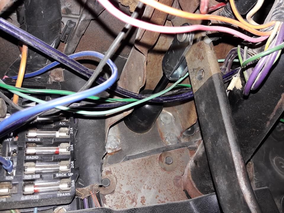

I have one more question. I have the inline tube rod and derby hat set up. It seems like adjusting it is pretty straight forward but for those who have used a stock style set up for manual brakes the adjustment is pretty much removing the slack out and placing the clevis on the top hole for manual brakes on the pedal ?
