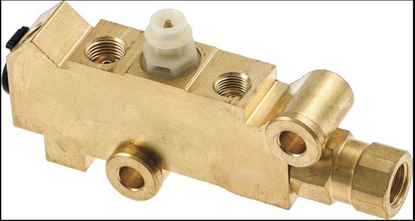

Old May 6, 2022 | 05:32 PM
cjsdad's Avatar
Joined: Sep 2010
Posts: 1,663
From: Norfolk, Va
If you have a combination valve like this,
and the shuttle has stuck at one end or the other you will probably need to take it apart and re-center it. I just went through this with my brakes. Mine came with a plastic screw-in button to keep it centered while working on or bleeding the brakes and I didn't use it. My front brakes wouldn't bleed so they didn't work. A quick Google will find the closest place where you can get one. There are fittings on both ends that can be unscrewed so you can move the shuttle which ever way it needs to go. It should move fairly smooth, it is suspended in the bore with o-rings on each end. You don't need to remove the shuttle to see when it is centered, unscrew the warning switch, it is dry, and you can see when the low spot is centered and install the centering button. Mine was too far to one end to catch the shoulder of the low spot so i had to take the ends off and center the shuttle. Bleed your brakes and re-install the warning switch and you should be good to go. Remember to bleed the fronts last.

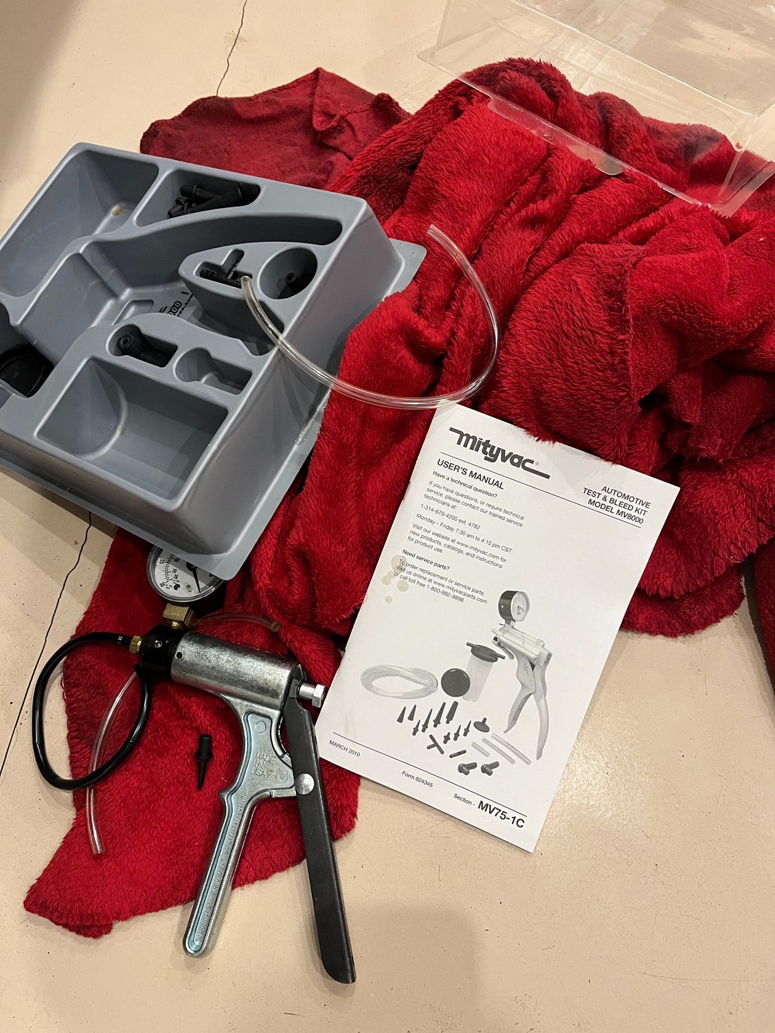

Old Jul 11, 2022 | 10:58 AM
98 man's Avatar
Joined: Nov 2011
Posts: 1,000
From: Oshkosh, WI
Just wanted to put a end to this thread as the brakes are now bled and working great. Kept thinking problem was in the proportioning valve since I couldn’t get fluid past there I took it off and it was in the center and I put that thing in the top to keep it from moving but still wouldn’t bleed. I sent the valve out to have it rebuilt it came back and I put it in and same results. It finally dawned on me that I had a vac tool used for checking diaphragms and it said it was also used for brakes so I put that on pumped about 5 or 6 times and started getting fluid out then did the other side same way then just bled the brakes like normal in 20 min I was done which is how it should have worked in the first place. Hope it helps someone else out down the line
Greg
Old Jul 11, 2022 | 11:49 AM
Posts: 18,201
Greg, you used your hand operated vacuum pump to "suck" brake fluid to the rear brakes via. the bleeder screws? Just want to make sure I understand...
Old Jul 11, 2022 | 12:17 PM
98 man's Avatar
Joined: Nov 2011
Posts: 1,000
From: Oshkosh, WI
Yes the kit had a bleeder attachment and I used the tool to suck the fluid to the rear cylinders on both sides once I did that they bled normally. I still in my head dont understand why the brake pedal wouldn’t have done the same thing pushing the fluid back? Been a 4 week nightmare trying to figure it out in my spare time and the part I sent out got lost for a week too lol
Greg
