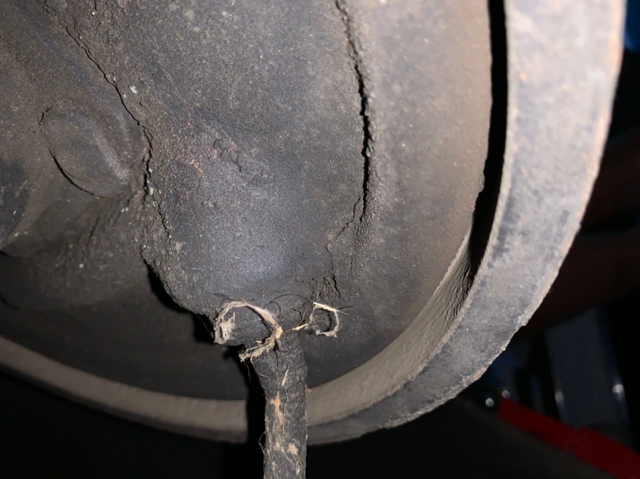

I think this is exactly what’s happened. The rear drums were the culprit, and as soon as I cracked the bleeder valve, some fluid squirted out and the wheels would spin by hand then. This may be a dumb question, but there is a metal line and a rubber line going into the rear drum. I haven’t traced them yet, but I’m almost certain the metal line at the top is the brake fluid line. But what is the rubber line? It’s more toward the front bottom part of the drum.

Well this is going to be one of those times we need a picture. The only thing that may have some rubber on it at the bottom of the backing plate is the e-brake cable.
Not a great picture, but it’s all I’ve got for now. Ran out of daylight. Also note that the pic rotated when I uploaded it. The line runs toward the front of the car, not toward the ground.

There should be another on the other rear wheel, they should have cables that run to the front of the car.

Yep, I think it does. So e-brake cables? That makes sense. Not sure why I didn’t think of that. Thanks!

Originally Posted by Eaton3122
...what is the rubber line? It’s more toward the front bottom part of the drum.
Unfortunately I can't recall from memory neither what the parking brake line looks like as it enters the rear drum brakes (whether it is enclosed in a rubber sleeve) nor can I recall at what location it enters the rear brakes but could it be the parking brake line? I'm looking for a diagram.

Yes e-brake cables. Change the rubber hose that connects the metal line from the body to the metal lines on the top of the rear end, you'll need to perform a brake bleed after. You can get one at the local parts store. While your there I would pop the drums off and do an inspection of the brake parts.
