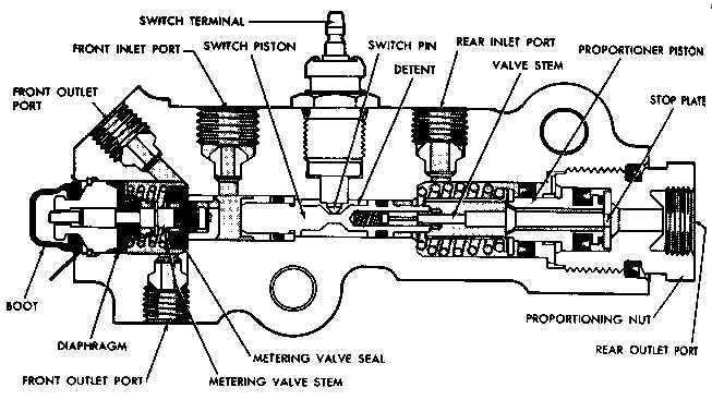

I changed bthe master cylinder and both rear lines, they twisted and rear wheel cylinders. The front are new a year or so ago. I tried pushing a bunch of fluid through the front brakes, still stuck. I then pulled the switch and tried moving the combination through that port, no go. I even tried the original master cylinder because it has bleeder ports and this one looks a bit different, chrome lid doesn't fit😁, still no go. The new master cylinder is going back on, had the pedal go down randomly, probably is 50 years old, so it is probably shot. My plan according to this diagram is unscrew the switch, remove the rear outlet line and push the valve back with a small screwdriver to reset. Thoughts?

If you still have the original cast iron combo valve, it's likely there is rust in the bore that is causing the piston to stick. Unless you are doing an optically correct resto, consider replacing it with a brass unit.

Cast iron, pretty sure all the brake parts were orginal. From what I can tell it is centered, thin part of the spool is under the sensor, can see a beveled edge on each side. I have flow with brake clean through the inlet to the outlet on both sides Not sure why no fluid is coming from the rear port on the master cylinder on either master cylinder.
