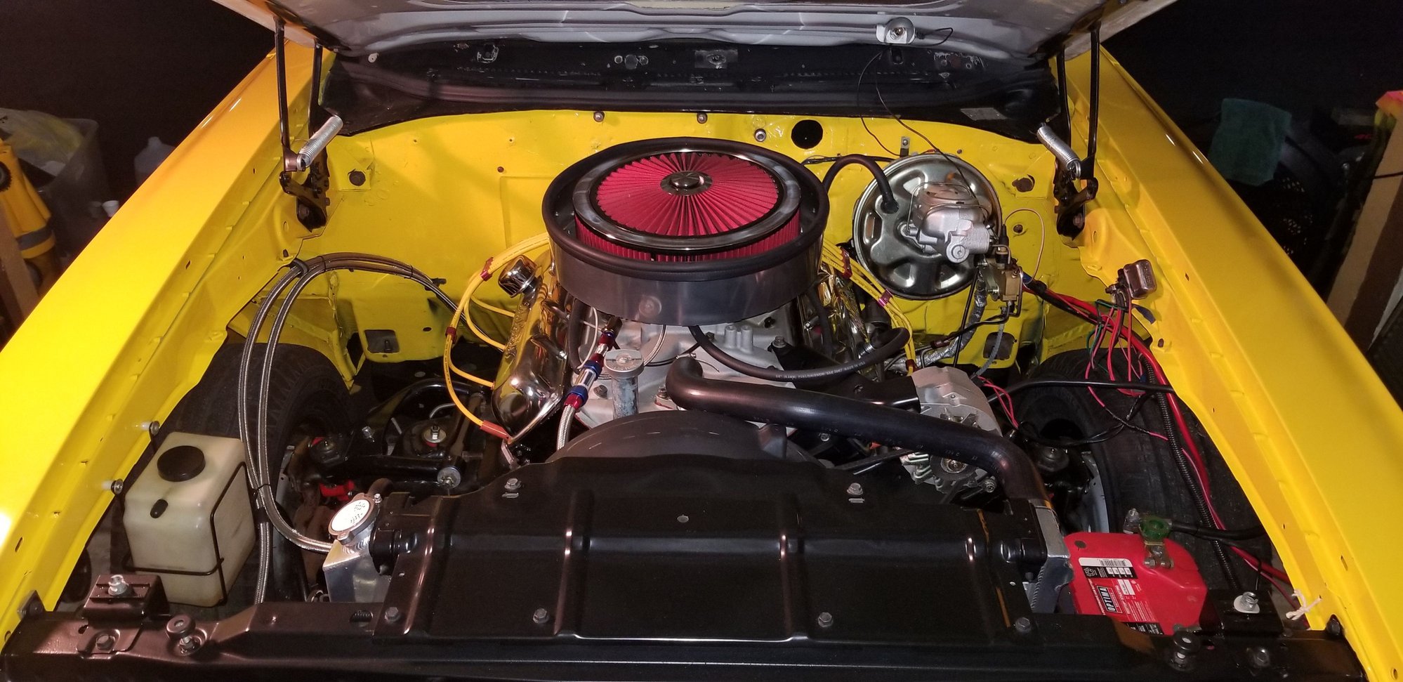

Old May 1, 2019 | 03:02 PM
JCMC64's Avatar
JC
Joined: Feb 2012
Posts: 1,069
From: So Florida

Chief - I get it thx. Applying brakes, M/C piston eventually cant release. Understood you from the first. I guess I got to be ultra exact with my words. I thought that was understood already.
And I will try both ideas just out of curiosity before I fix it, and post back. Actually home early today to hit it some. But its a rainy day today, so dont know if I will be able to try ideas.
But engine warm may still be cooking brake line, no? Took this pic today
Formulating a series of test in my mind, including Chiefs, to include most of the mentioned fixes/possibilities. One I already know is this problem does not happen with engine off, no matter how many times or how long brakes are applied.
Can you please explain why that is? Thx.

I don't think the brake line in the picture will pose and issues with overheating the fluid. Mine front line running across is very close to my headers as well, haven't had any issues. The brake fluid can take some serious heat before boiling or expanding to cause any issues, even with the line in the picture shown to be close to your headers.
