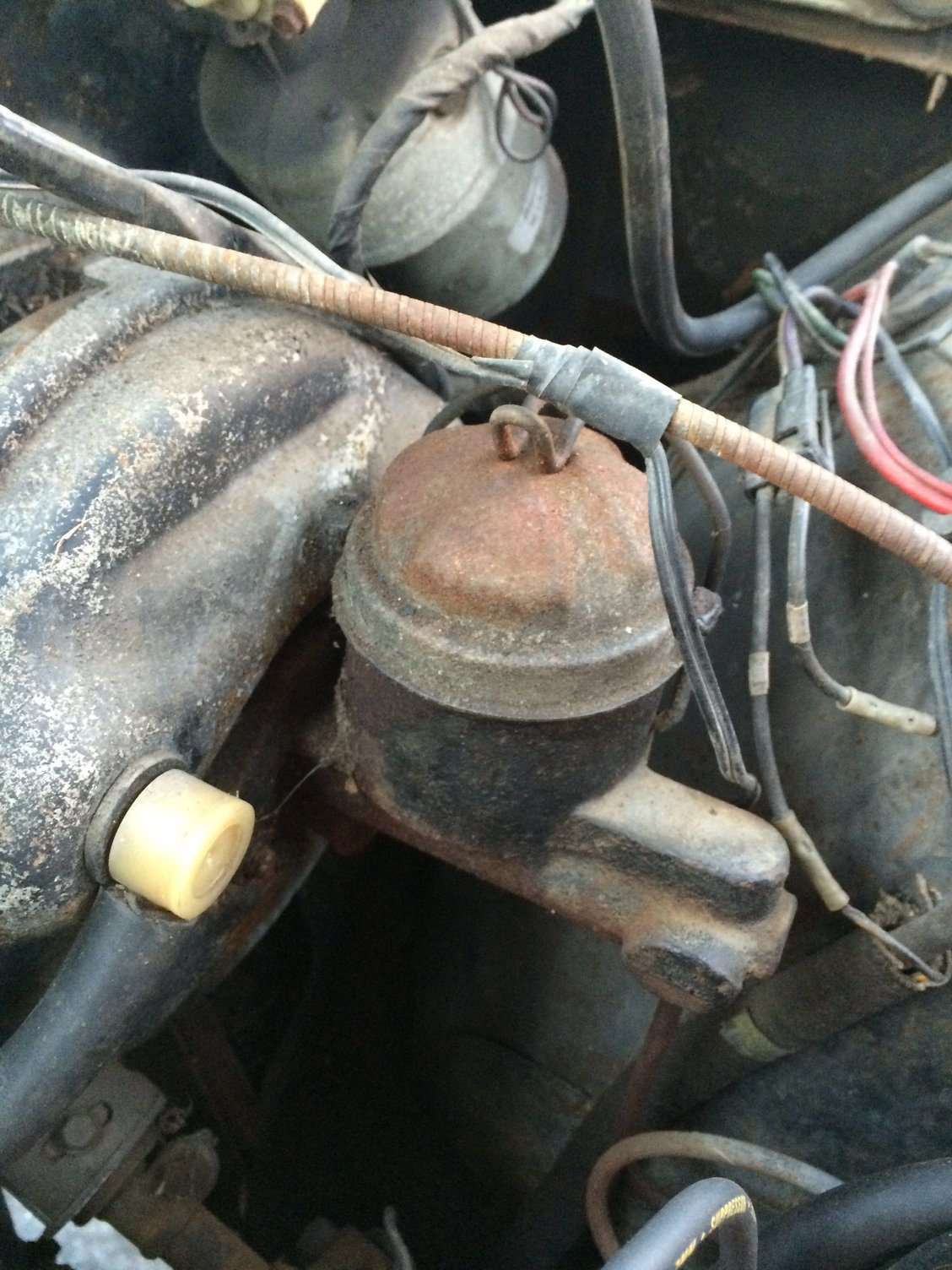

Hey, I am not sure whether my master cylinder on my 66 Starfire is a Moraine or a Bendix. I bought a master cylinder off of rock auto and there are only holes for the brake line to come in from the side or the top, while mine comes in the bottom. Would just bending the brake line realistically be the easiest way to go? But either way need ID help... Thanks

Did you get the correct master cyl? It isnt too hard to bend the line just dont kink it.

I ordered a 66 Starfire power brake master cylinder off of rock auto guess it's just a generic reproduction.
It's a Moraine Master Cylinder showing in this pic....

Casting # is on the bottom....

Call me with the casting number (on the bottom of the master cylinder) and I will tell you DEFINITIVELY what you have... and I am POSITIVE I have the correct one in stock (and it will be less expensive then Fusick)...

What Charlie shows you has a 50 - 50 shot of being correct -- the Delco and Bendix "look alike" -- but their guts are different and the ultimate reach is different (critical).....

The way I told them apart was Bendix normally had a screw cap instead of the wire bail. I've seen Bendix both front and bottom connection whereas all Moraines were bottom outlet
But yes, Lucas- that's a Moraine booster and M/C. I'm not 100% sure the B/C cars were using Bendix in 66.
