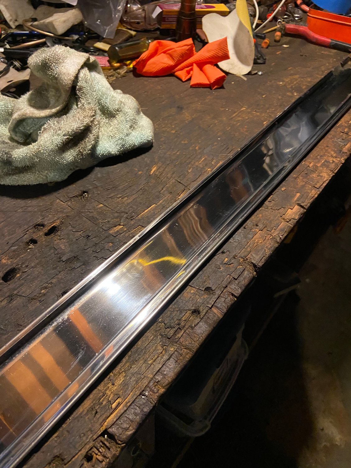

I removed a few trim pieces off my '72 98 while trying to paint some rust spots. Finding the lower'most trim is pretty nice at the forward end and ...pretty foggy at the rear end. I rinsed the entire peice first, then used a Turtle Wax polishing compound which made no difference on the foggy end. Then used that old Nevr-Dull polish which made no difference. I have an electric buffer - just wondering what some folks might recommend as a polishing compound. Thanks.

Stainless. or aluminum? BIG difference! I'm guessing that a 72 probably has anodized aluminum for most trim. In that case, polishing does very little, unless you completely remove the anodizing, then polish it, and then you really need to protect the aluminum surface, with something. Re-anodizing is not an easy thing to do yourself, or even find a local shop to do it. I've cleaned and shot freshly polished aluminum trim with Imron (polyurethane clear), or even modern urethane clear, and it holds up well.
Stainless? sanding with a very fine sandpaper, 600 up to 1500, and then machine buffing, or even vigorous hand buffing will bring it up to like new condition.

Thanks again, all. Yea, I beleive this is aluminum - super lightweight. I bought some of the Simichrome and will try even using my buffer. If that don't do it, I'll strap it back on car and call it a day - this ain't no show piece.

So. If I understood everything correctly:
  • I have aluminum
  • It's anodized and can't be ...made shiny (un a reasonable sense)
  • Don't use the simichrome I just bought :-)
It's down low on the car - I'll just clean it as best I can and reinstall. Weird though - the front half is shiny/chrome-looking and the rear is all milky. I'd have thought the other way around, or ALL milkly... Que cera cera I guess. Thanks all.

pretty interesting that the inner side of the trim (which isn’t aluminum as I / we thought, magnet sticks right to it) looks fantastic while the outside is …milky, though doesn’t look like it’s gonna flake. I’ve tried a number of polishes - nuthin works. Just gonna clean and reinstall and call it a day 😎.
