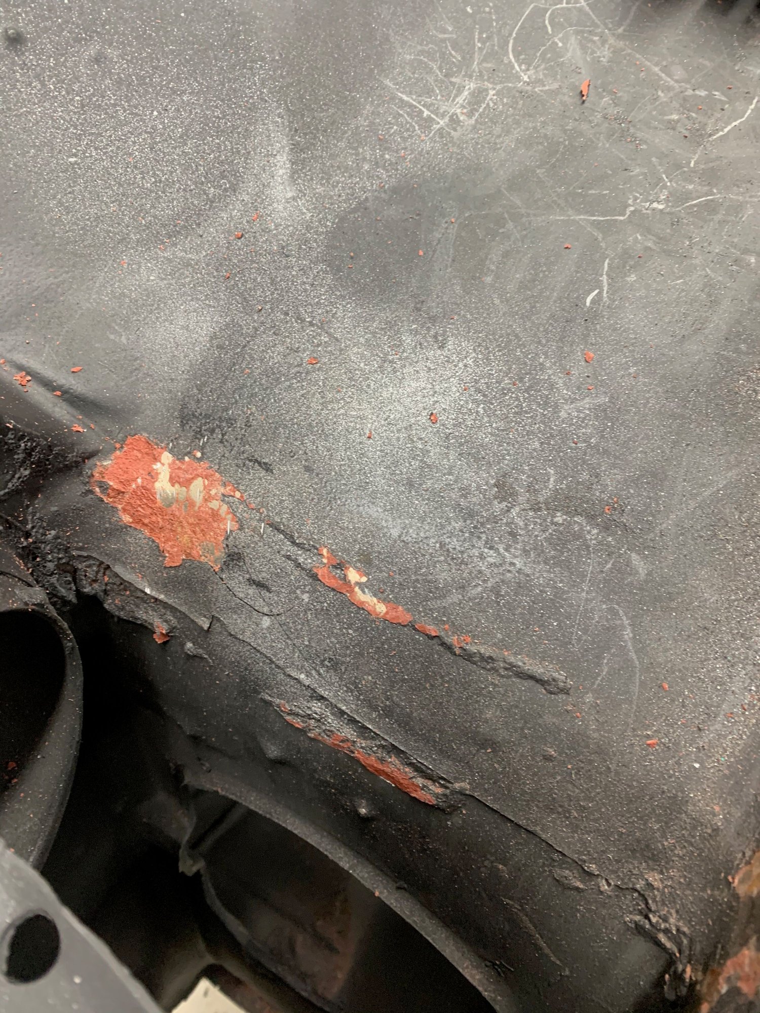

Can any of you body guys I.D. this stuff or recommend a current substitute for this stuff? Its different from you typical seam sealer it seems and was used in many areas around cowl and body gaps.

expandable foam,was put and flowed like regular sealer , then panels get welded together. when it went thru the paint over it expanded filling all gaps that wernt accessible. when wet it was horrible to get off your hands don't know of anything like that to use now,should be ok with regular seam sealer. its still between the seams unless the car was dipped

Thx for the info
