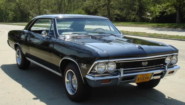

Great Q Thomas. I went to look through my interchange, but it only has engine drive train and suspension. I know you aren't looking for guesses, but based on observation the rooflines and the front moldings all look the same. If I was a betting guy, I'd put a sizeable wage they are the same moldings. In fact, I'd bet all the glass interchanges too.
66 Chevelle 396
66 Buick Skylark
66 Pontiac Lemans
