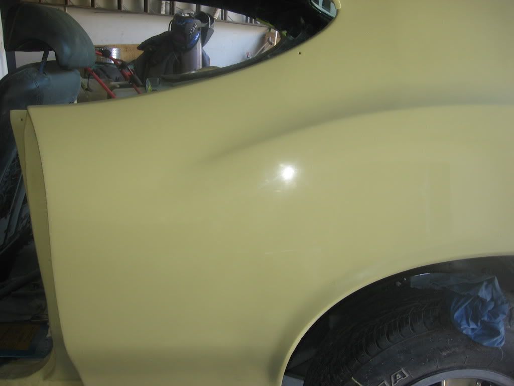

Old Apr 24, 2011 | 07:25 PM
COcutlass72's Avatar
Joined: Feb 2011
Posts: 67
I gave it my best, I think it looks pretty good for my first try at ever doing this.

Old Apr 25, 2011 | 05:09 AM
Gary's 2 442-S's Avatar
Gary
Posts: 1,245
From: Houston,Tx
Looking good! Nice welding
