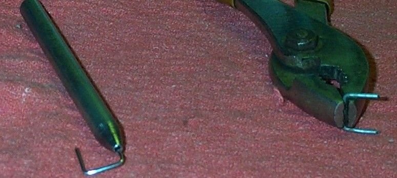

I made a tool to start the bend in the staples after I got them in position, it really helped. plus the kit I got from Fusicks didn't have enough staples so I made up some using standard slip joint pliers(they're the perfect width for the staples) I used large paper clips for the wire. They worked fine.
Old May 26, 2019 | 07:18 AM
Allan R's Avatar
Just an Olds Guy
Posts: 24,528
What a great innovative idea. I wondered about that but never had to go that route. Well done!!
