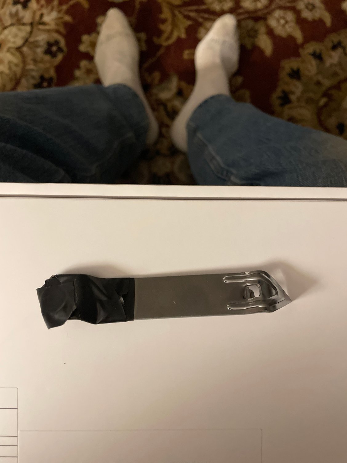

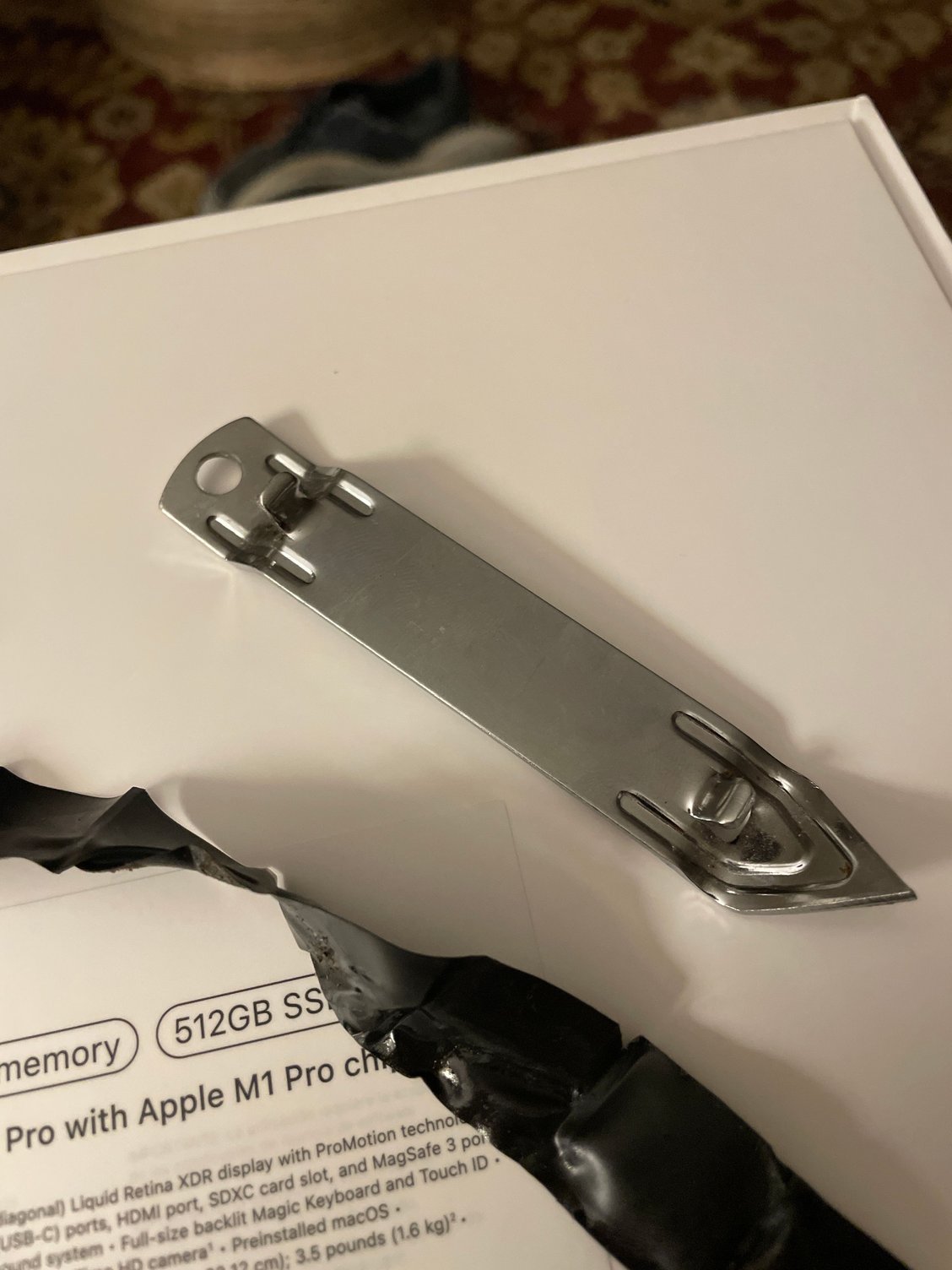

Can you post a pic of said bottle opener just so I use the right one?
Old Mar 16, 2022 | 04:48 PM
tdhill01's Avatar
Posts: 1,138
From: Middlesex County, MA
Old Mar 16, 2022 | 04:52 PM
CRUZN 66's Avatar
Olds Fever
Joined: May 2011
Posts: 4,525
From: New York (Upstate)

Originally Posted by CRUZN 66
Got it...thanks
