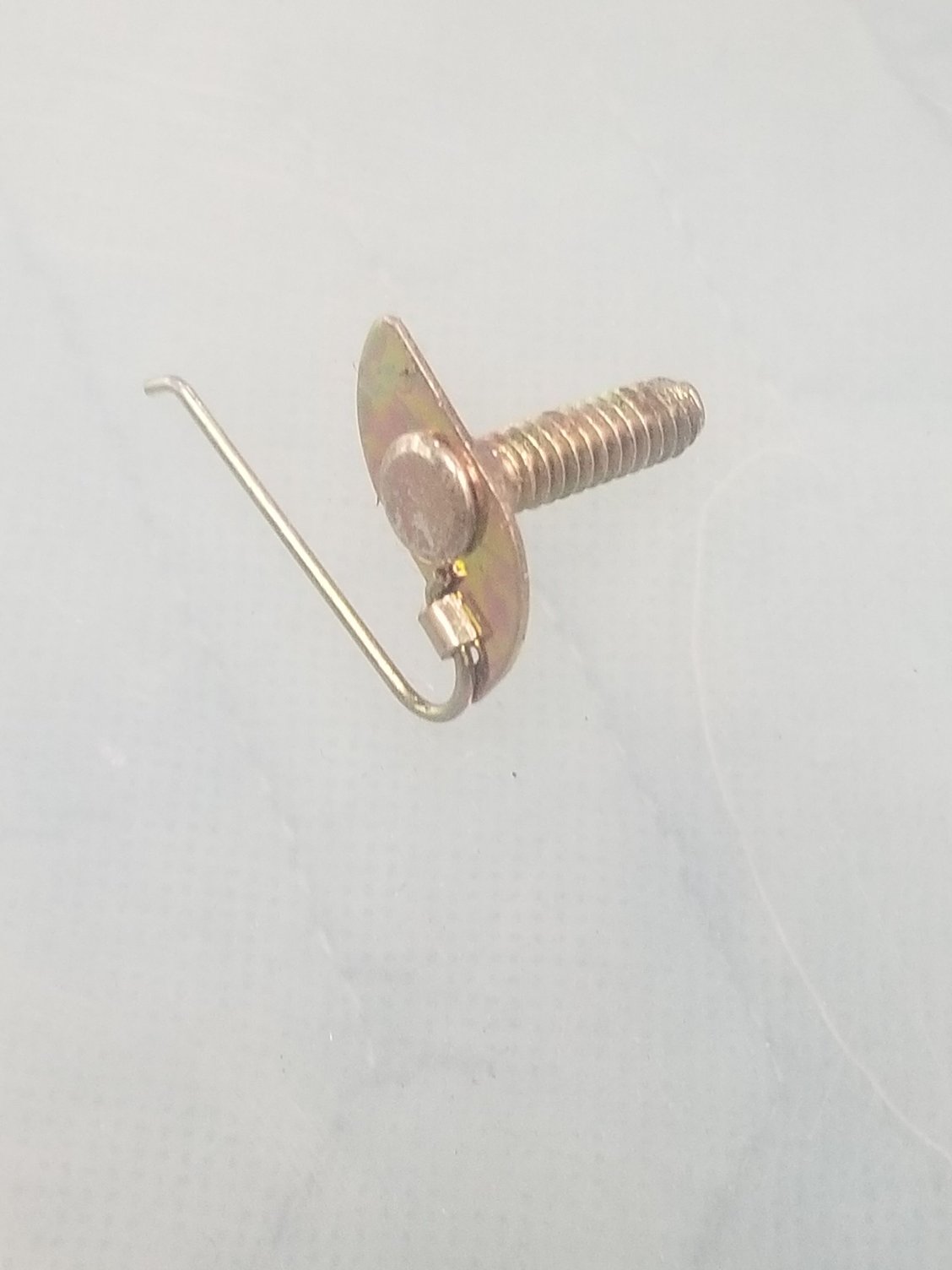

I have removed the clips along the upper door trim. You have to remove the door panel and reach up with a 3/8" (?) wrench. I haven't tried the rear 1/4 ones and am not sure if they use the same clip. I purchased these at NAPA, there the same as were on my car and I didn't have to wait for them.
Old Jul 30, 2022 | 06:22 AM
69oldsguy's Avatar
Posts: 420
From: Meridian, Idaho
Your doors don't have studs? My doors have a hole at the leading and trailing edges which use the spring clips you showed, but have studs between those two with slide on plastic clips. Interesting. Every '69 I've ever had was like mine. Except for the Supreme. Are the convertibles different or has someone replaced your door skin in the past?

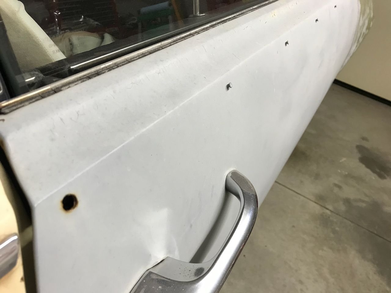

This is how my doors are. The quarter panel is the same for the continuation of this trim and the vinyl top trim as well. It also uses these studs across the deck lid for the vinyl top trim.

Interesting, I do not have any studs, just holes. The same for the rear quarters.

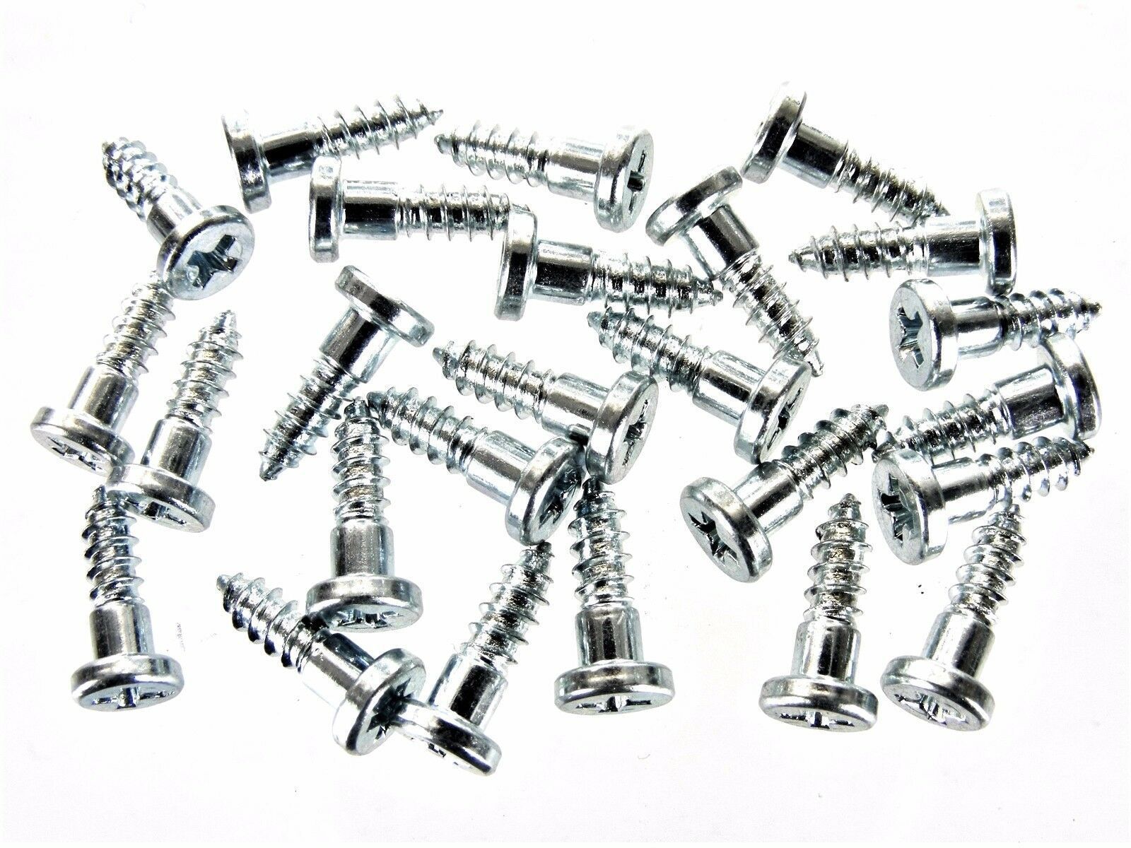

I have seen people use self tapping screws with heads the same size as the studs to hold those clips on replacement panels.

Something like this. https://www.ebay.com/itm/22366346073...hoCwvEQAvD_BwE

Well would you look at that! Awesome. Many thanks Joel.

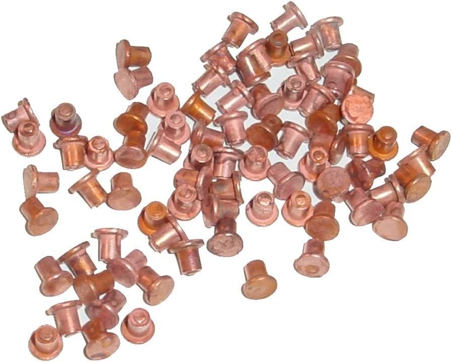

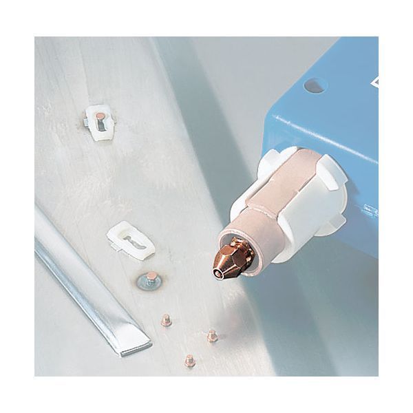

Posts: 50,770
The right way to reinstall the trim rivets is to use a stud welder with a trim rivet tip. Drilling holes for screws in fresh sheet metal is never a great idea, and is a good way to cause leaks and rust. There's a reason why the factory used trim rivets.

Joe, Fashionably late. Where were you 3 posts ago?
You are absolutely correct. I was not relishing the idea of screws or holes. I just got off of Eastwoods site and like what I'm seeing. Looks like problem solved.
Thank you. Cheers.
