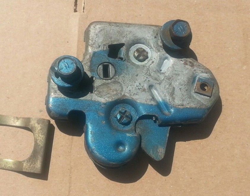

On the other hand, the lock DOES have an "overriding" feature such that the power trunk release mechanism can turn the lock actuating rod without the lock cylinder turning. The rod is about 3/16" x 3/8" and sticks all the way through the latch to interface with the power lock cylinder. If you don't have a power lock you should be able to see the tip of the rod. Of course, that's not exactly a standard socket size, but if you can get to it and turn it CCW (as seen from the back seat) that should release the latch. If it doesn't turn, the latch is jammed.
In comparing a picture of a power trunk release and a regular one, I can't figure out where the "overriding" rod you speak of is.
Can you shed some light?
Thanks
72 cutlass power trunk latch
72 cutlass regular trunk latch

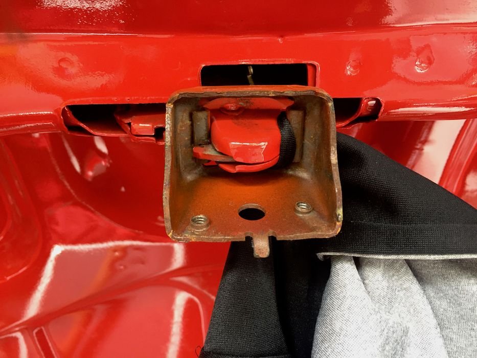

These 2, correct?
2 internal bolts

No...those you show retain the latch ***'y. on the trunk lid. I'm talking about the ones that would be seen below those that retain the catch bracket mounted in the trunk.

Unbolt the latch from the trunklid and the rod to the lock cylinder still holds it in place. Unbolt the striker from the rear panel, however, and the trunk lid opens. Very nice.

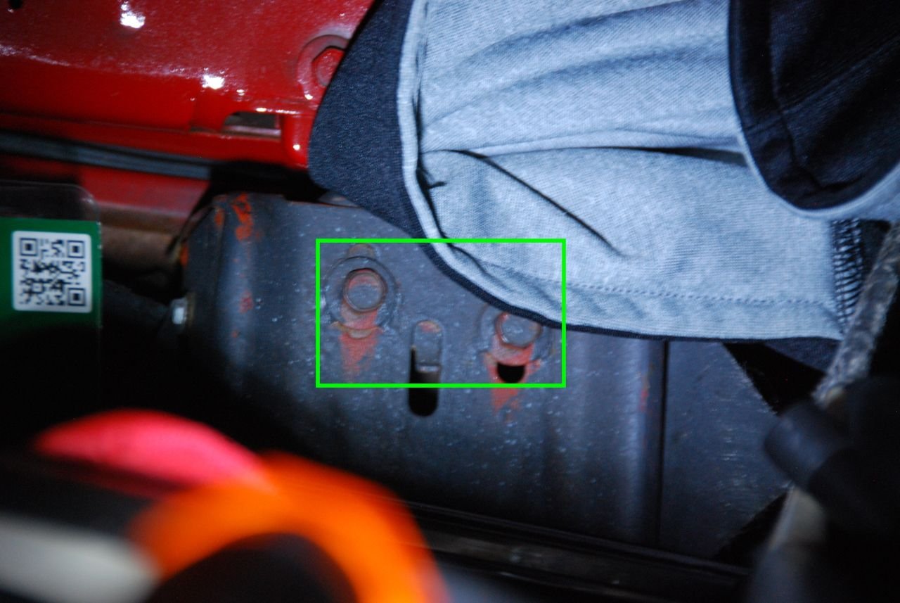

So these two? (right below the sweatshirt in question)
interior of 72 cutlass trunk

Yep...go for it! The striker will come out of the bracket...releasing the trunk lid. You will then need to assess what's going on with the latch portion to see why the rod/key is free-wheeling inside the lock.

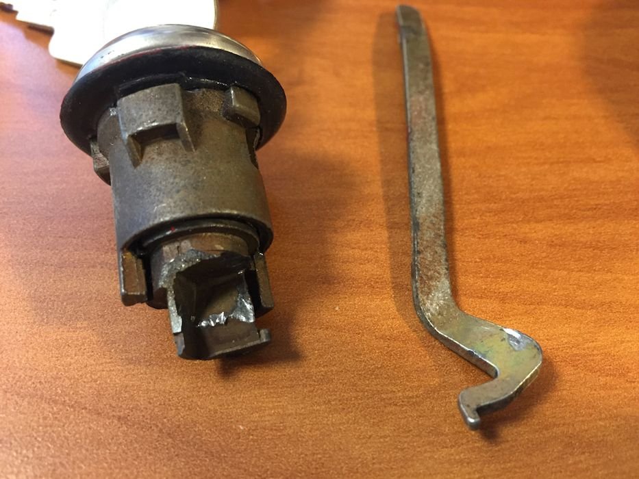

Worked like a charm. Thank you all for helping me problem-solve.
A friend had a whole bunch of extensions that we strung together and ratcheted those two bolts off. Popped right open to reveal the sweatshirt really jammed in there.
Once in, we found that the lock was spinning freely becasue the back end of it broke off under the pressure of turning it with force from within, and that the rod is quite bent.

Trunk opened to reveal the sweatshirt that caused all the pain.
Back of the trunk lock broke off and rod got bent.
