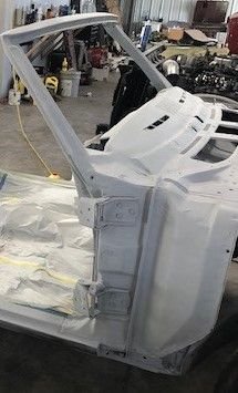

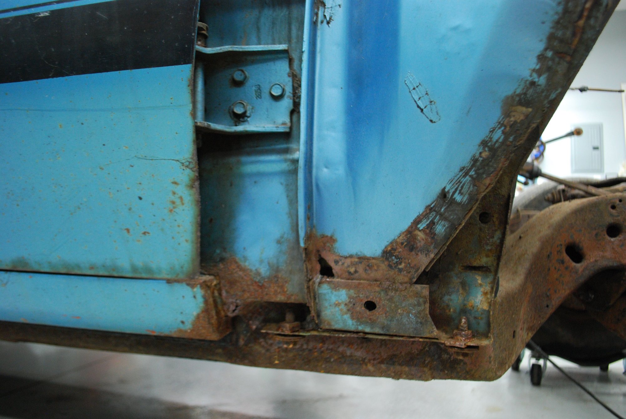

Hello I have a 72 cutlass supreme. Behind the front fenders that the lower fender bolts to? I cant seem to find a nice picture of what its suppose to look like behind the front fenders on the cutlass. Mine is rotten and and I want to cut it out and replace it but cant find a good picture for comparison. The torque box is in ok shape just the rest of it by the bottom cowl and fender bracket is gone. Any help thank you.

hope this helps
https://www.ebay.com/itm/For-1968-19...75.c100623.m-1
hope this helps bud

A little rusty but maybe what you need?
this is exactly what I needed thank you very much wow what a difference mine is rusted to s$%#!

Originally Posted by Eddie Hansen
thank you it does help alot. My lower bottom piece of that of that is toast....

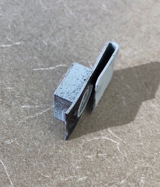

The correct j-nut that is the attaching point for the lower fender bolt is very difficult to find. It's still attached to the blue car pictured in this thread. The new ones available that are listed and described as "correct" are not close to the original.

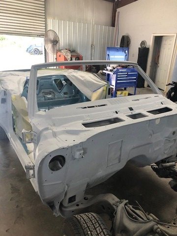

Here's my car before paint. Maybe you can zoom-in on the lower cowl area and they'll help.
perfect thank you i found everything i needed from you guys. Thanks again!
