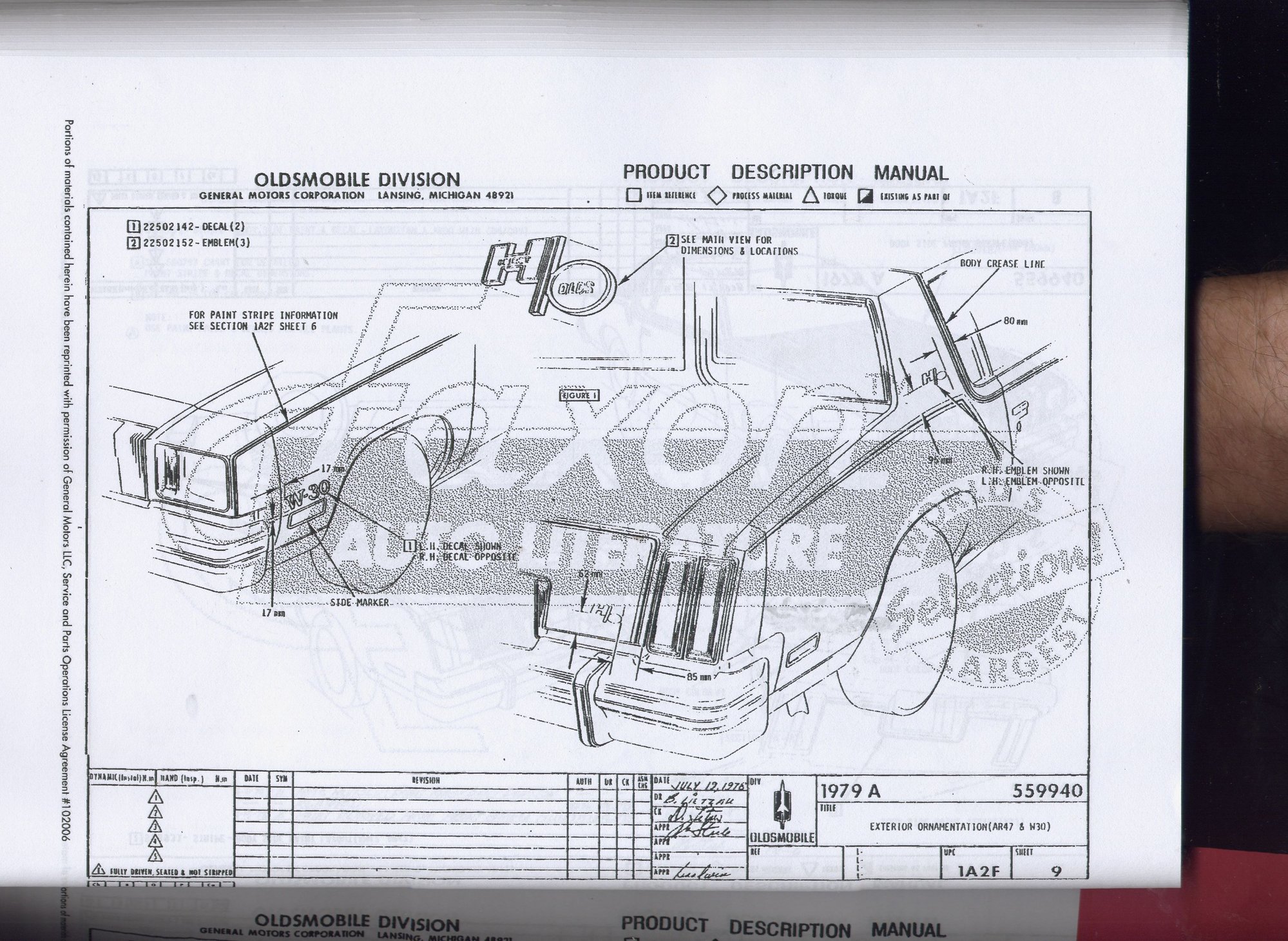

1979 Hurst Olds emblem placement
From the 1979 Cutlass factory assembly manual.
