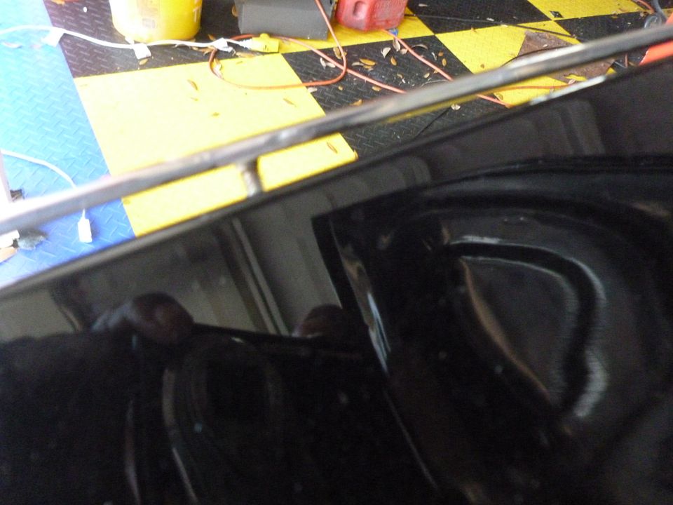

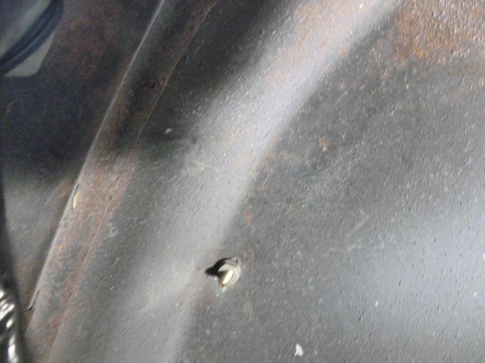

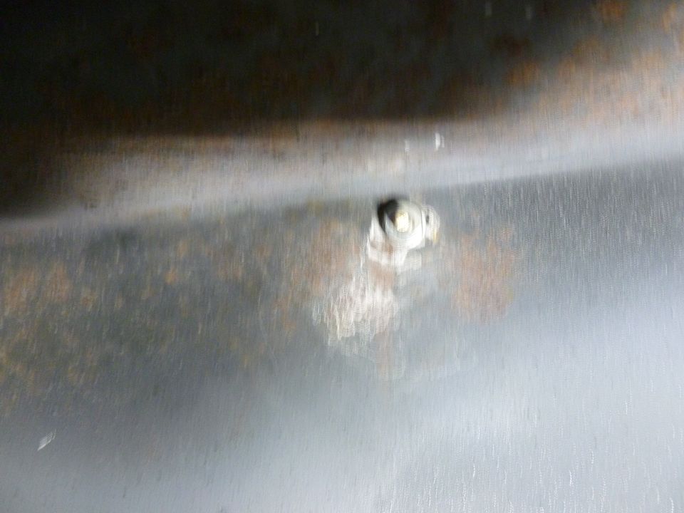

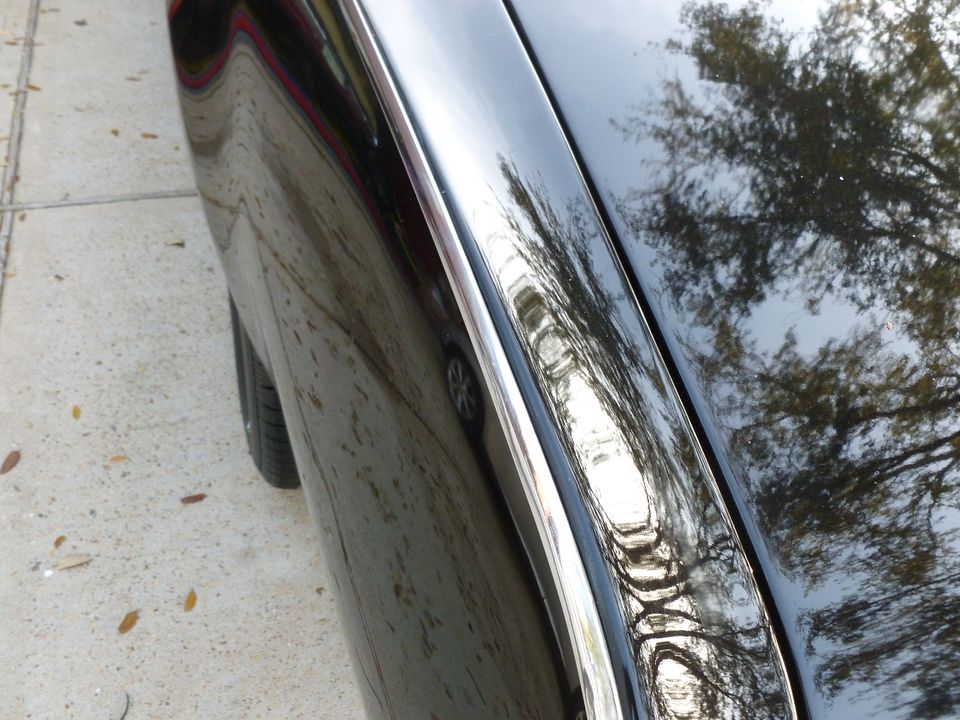

Those clips you have are not going to get the moldings flush to the body. I tried them and even took a razor blade to try to shave them down and still would not work. this is what Ally is talking about doing
