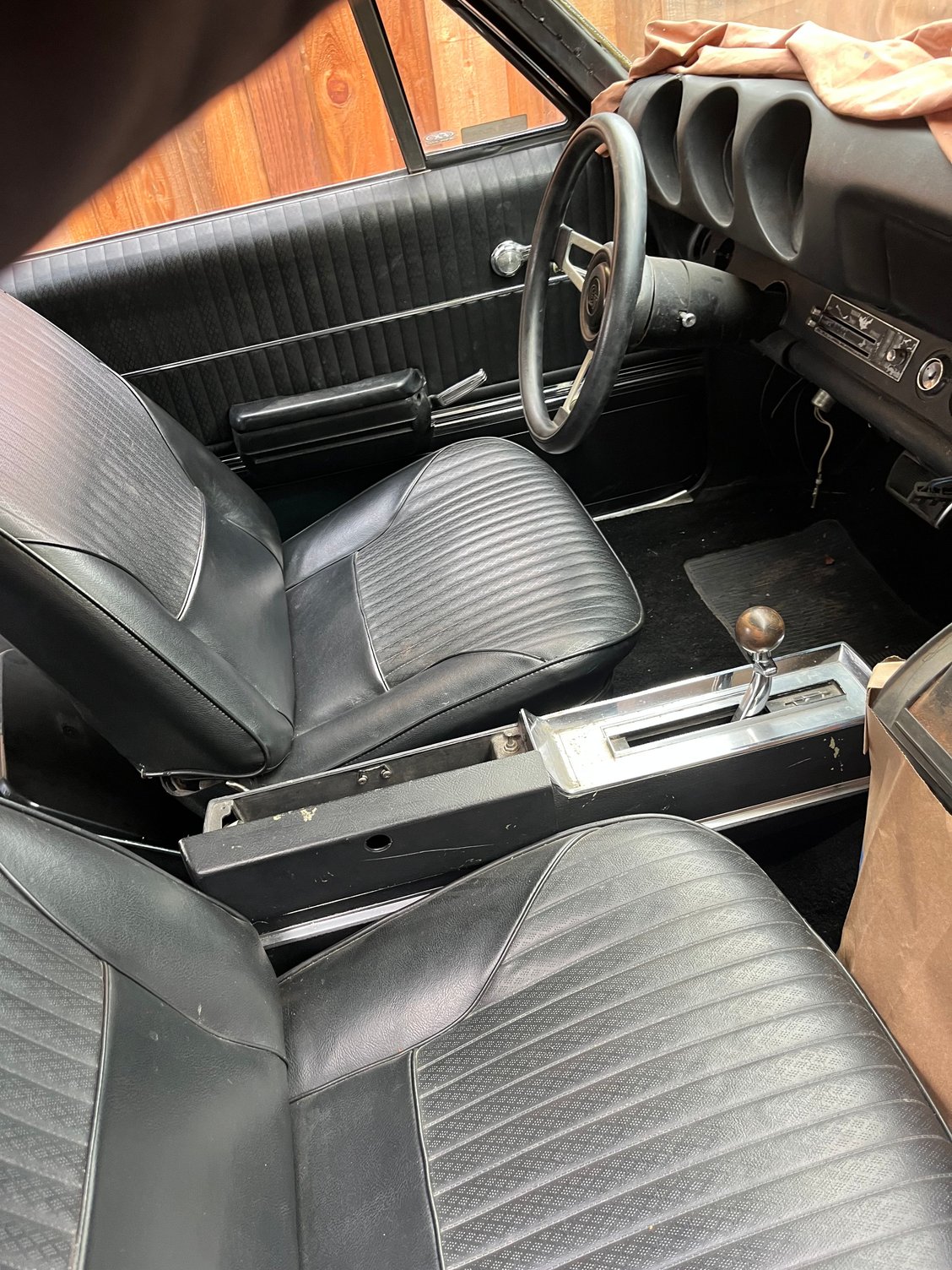

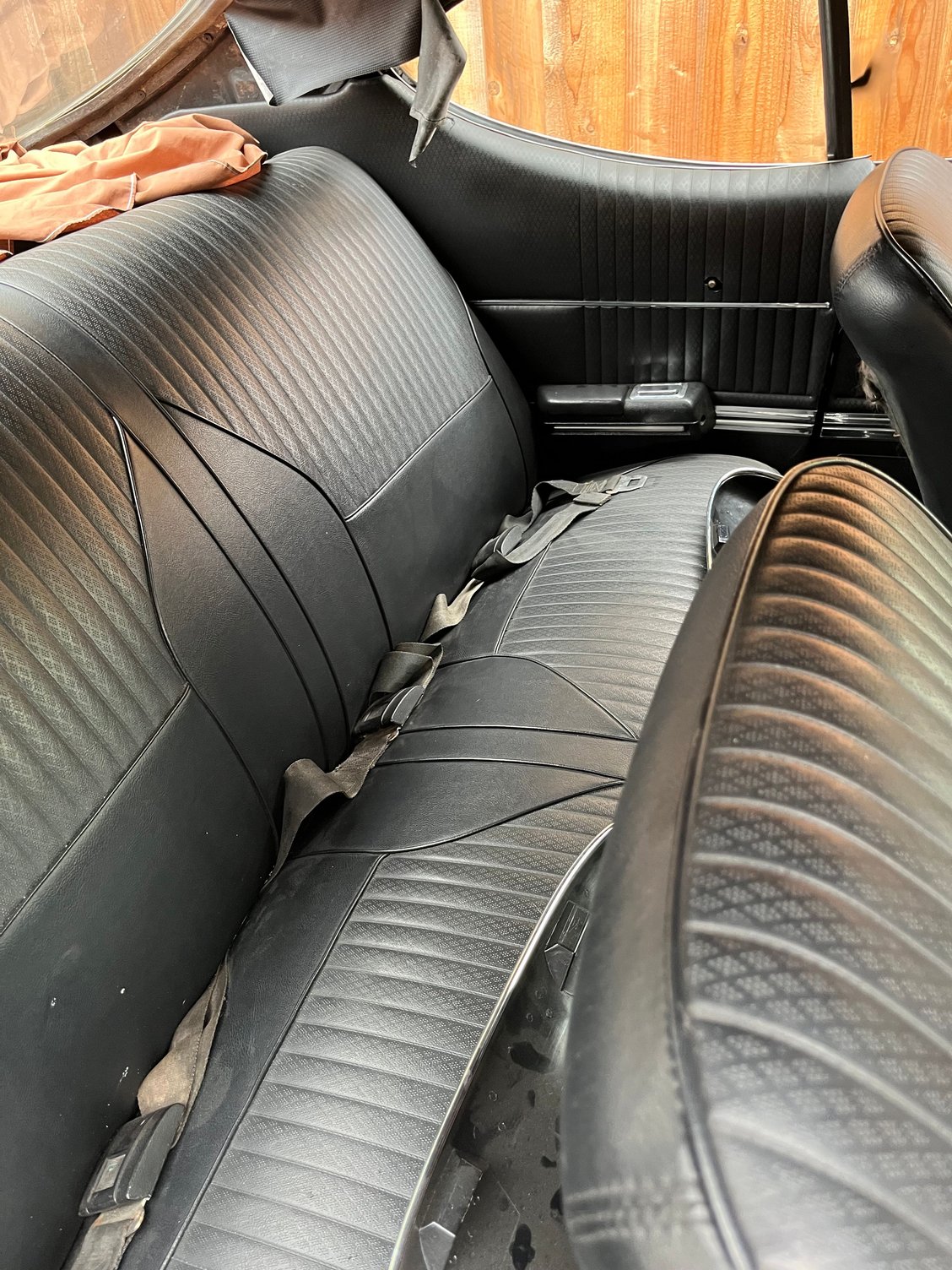

got it fixed, and here’s some photos for y’all. Now i need to go through wiring everything for the dash. since this car is a barn find, and the original owner seemingly cut all the wires to everything, i’d greatly appreciate any help or tips on where to start, as none of the guages work, and all the wires are cut. Here are photos of the car:
