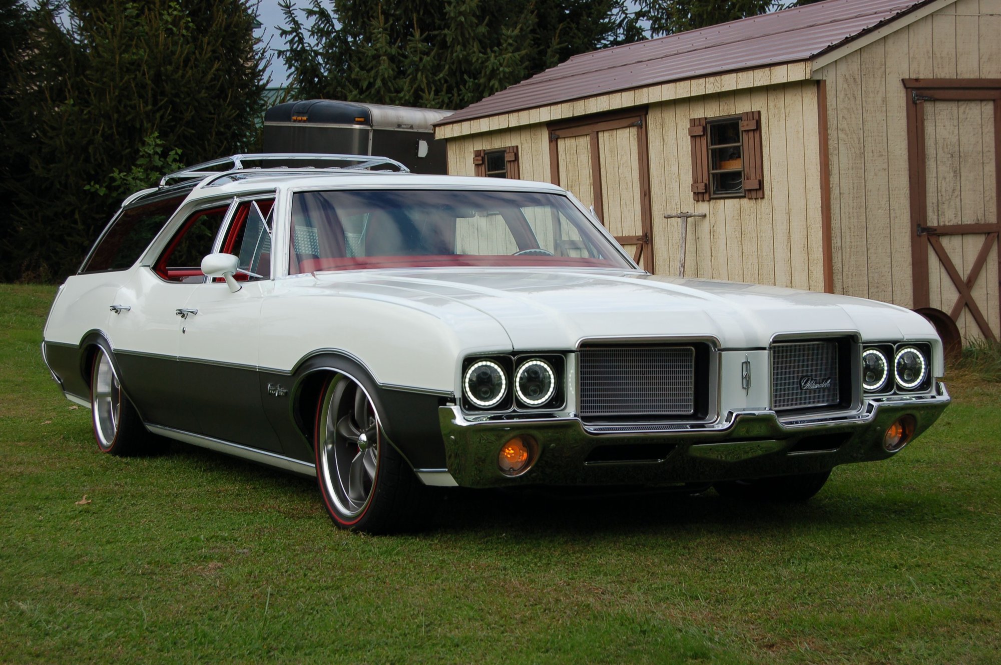

Will the car sit outside year round or be in a garage? The wrap will degrade faster if exposed to constant UV light from the sun. Most say ~ 5 years or so if the car is always outside. I had my wagon done with a black brushed metal metalic wrap in the areas the woodgrain would have been. As said, the body still needs to be pretty straight and smooth for the wrap to look good. The plus side is that as long as you can get a decent looking surface, you would not need to strip it to bare metal and you can probably prep it yorself in your driveway. The wrap on my car cost $1600 a few years ago. Roughly half was for the material and the other half was labor.

That Vista is bad@$$!😎
That looks sharp. Yes, the car is always stored in a garage. Thanks for the help.
