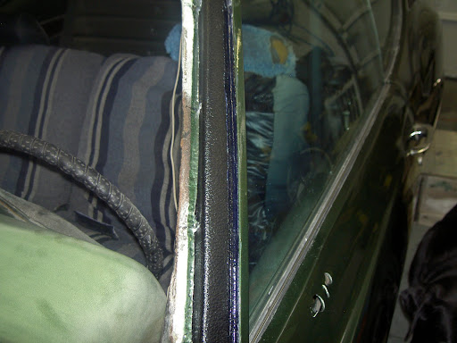

I finally got my top on yesterday with 2 volunteers and a case of beer. I did back off the fender bolts to anchor the vinyl on the pillar and then layed it out and applied contact cement to the vinyl and pillar, while it was bolted to the fender...and then stuck them together and it seems to have worked great.
finished pillar
Having this go on so smooth really gave me confidnece getting ready to do the top! More details to come on my 72 Olds Cutlass thread.

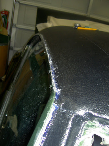

Now that I have the top on sucessfully, I need some help on finishing the drip rail. All the articles I read said to seal the edge in the drip rail with a sealer to prevent water from getting under the edge. I found a good all purpose sealer by Liquid Nails, water proof, indoor, outdoor, non srinking, non fading, etc meet all my needs. Only problem now it has set for a week and it still feels tacky. Hopefully this will pass and it will dry out. my concern it will just catch dust and dirt and not clean up over time.
Any thoughts???

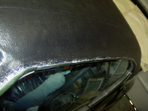

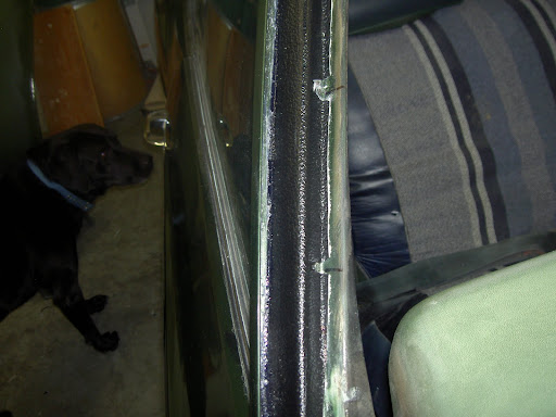

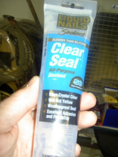

Here is the culprit, When I read the label it seemed to fit my needs, non fading, outdoor, waterproof, remains flexable.....50 yr warrentee,,
what I missed ws the very very fine print on the back that said not for automobile use. Guess that ment not for outside sealer use, since it remained tacky.
Here are some shots of the troubled area. I have picked out all the adhesive I could with a screw driver.
You can see I have some glue on the outer rail, I don't think thats a problem since my molding with fit over that and cover it up. In fact the glue will help hold onthe molding I'm guessing. Also some still on the vinyl (could be long term problem??)
The sealer can be disolved with Minerail Spirits, but don't want the vinyl to become unglued at the edge... I did test Mineral Spirits on my vinyl and it did not appear to react, but I'm afraid it might get under the edge...
I finally did what I should have done to start with and that is to go back to the Auto paint and body store experts and ask the question. Is there a special sealer for the drip rail? His answer was YES. It will be in Tuesday. He said it is a sealer that will when applied spread out and fill all the holes and seams, etc... Guess I should have ask first, but it seemed so easy to put some sealer in the rail and fill it in like caulking a bathtube. (Not so!)
Any suggestions on cleaning up my mess? I'm hoping after getting all or most of the old Liquid Nail out the other sealer will cover it to prevent catching dust and dirt

The final touch to seal the edge I ended up using the urethene Adhesive that I used to install the front windshield. It was blacka dn cured in a flexible water proof finish... It also covered up the mess I had..
The end result once adding the molding it all looks good!!!

I was wondering is there anything I should put under a vinyl top to make sure it doesn't rust out anymore? As my back window did have some rust issues on the side and on the inside of the rear window from moister. Is there something that will stop it from rusting for good? As I don't have a garage to park my car in. I plan on using a car cover and what not. Thanks
Old Nov 28, 2010 | 04:51 AM
Gary's 2 442-S's Avatar
Gary
Posts: 1,245
From: Houston,Tx
I don't know how you repaired the rust around the windows but the best thing to do for rust is to completely cut it out and weld new metal in. I would then use an epoxy primer. Now if you did not cut the rust out and patched it I don't think that even if you used POR 15, that the rust still might come back from thru a filler. I am getting ready to soon put my vinyl on very shortly because just about finished painting the car. I guess I was very lucky because when I took the old vinyl off which was a chore there was no rust under it. I just stripped the top and the car down to bare metal. I did not paint the top but just left the epoxy primer on and plan on putting the vinyl over it. I thought that it made no sense to cover paint with a vinyl.
Old Nov 28, 2010 | 10:21 AM
  #31
richeyb's Avatar
Posts: 209
From: Idaho
rust
I'm no body man but I did try to document what my friend did as he attaked the rust in my Cutlass... The one thing he attempted to do was to remove and replace, grind down and eliminate the rust then repair, etch, prime and paint. For areas he could not totally get the rust out or area that would probably rust again, i.e., wheel wells he sprayed in what he call fish oil or an anit rust agent.... There was lots of rust and damge around the front windshield and required some creative work to get it repaired. This is documented in another tread of mine https://classicoldsmobile.com/forums...s-cutlass.html
You might check that out and see if anything in there will help. Good luck!!
Richey
