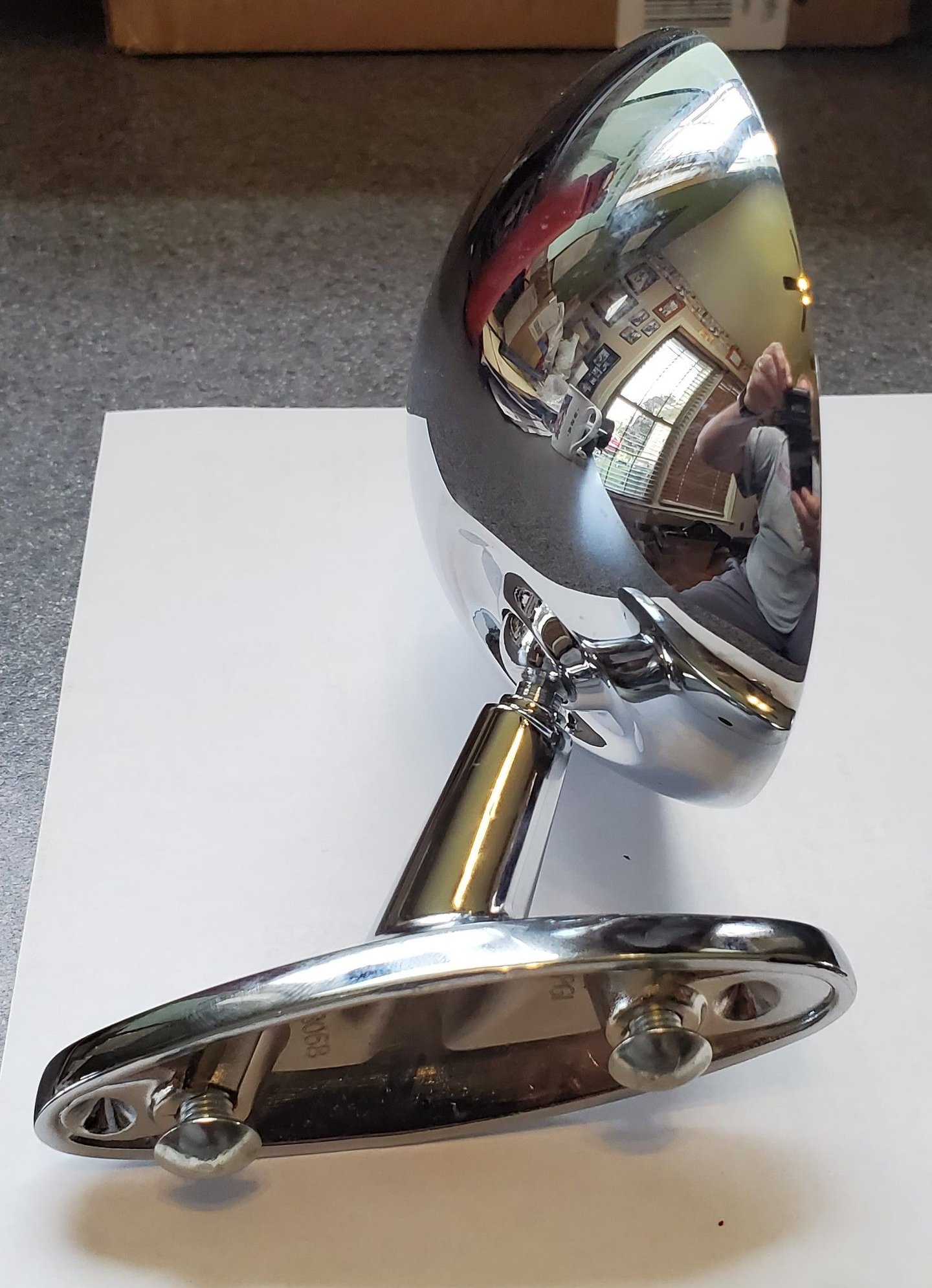

Not sure if this is the correct area to post this but seemed close. So I recently purchased a 1970 Cutlass Supreme and it did not have a passenger mirror. It has the remote drivers side mirror (controlled by know inside vehicle). I purchased a right side mirror from OPGI and noticed it is much thinner than the drivers side. I am assuming it is because of the remote adjustment function. But there is an obvious difference in appearance. My question is, are there passenger side mirrors that are the same thickness as the drivers side available and if so where do I get one as I cannot seem to locate or is the passenger side being thinner acceptable as I am trying to keep it as original as possible and well to me it just does not seem right.

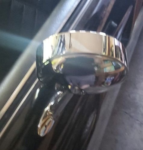

Waiting for answer as I have the same mirror as in the lower picture and want a passenger side to match mirror housing.

If the one you have is oval, then yes, it is correct. Passenger side mirrors didn't have remote mechanism, therefore, they were thinner than the driver side remote mirror.

That is not correct. ALL passenger side mirrors are the thinner manual style. The thick driver side mirror is the optional remote style. The base equipment driver side mirror looks just like the available passenger side. They did not match from the factory and no matching style mirrors exist for the passenger side.

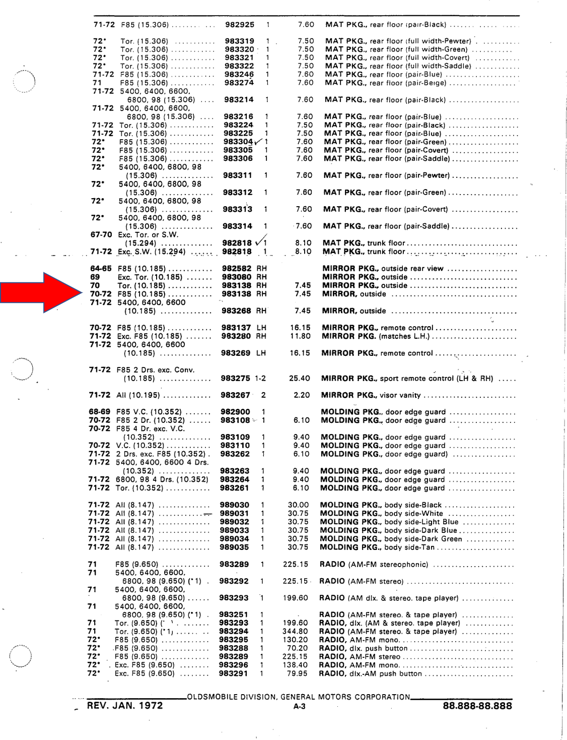

Picture? Part number? Sorry, but not from Oldsmobile.
Originally Posted by rcorrigan5
If that particular mirror style is the same as the way the '68-'69 chrome mirrors were, the passenger side chrome mirror wasn't called or labeled as an option. Instead, it was called an "accessory" which would have been available for purchase and installation at a dealership.
Correct, though the 70-72 mirrors have different bases than the 68-69 mirrors due to the different shape of the door. From the ACCESSORIES section in the parts book. Note that there is only one style of RH mirror for the 70-72 cars (not counting the sport mirrors).
