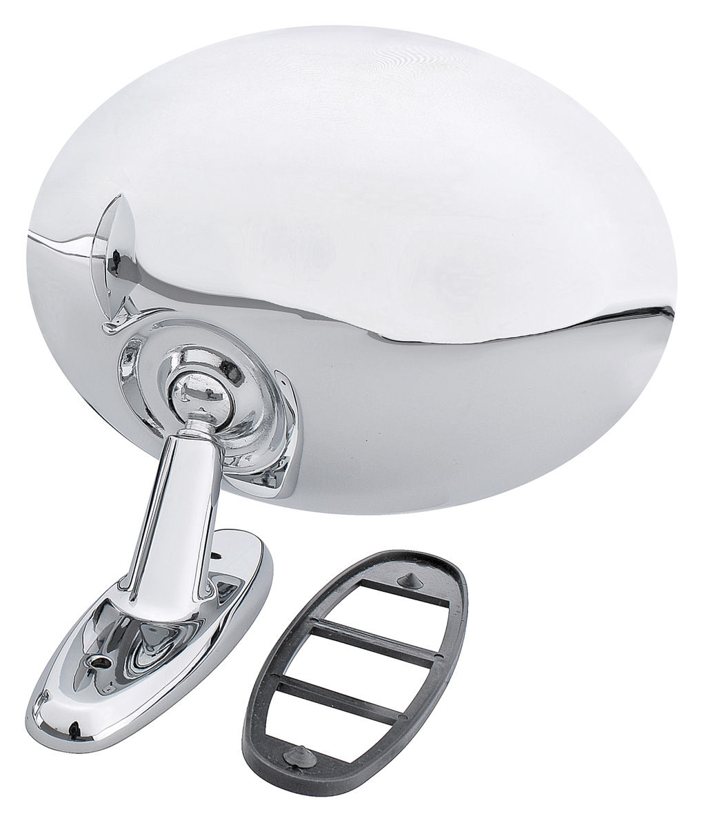

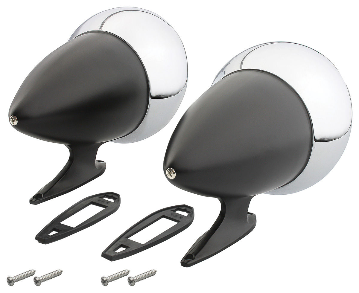

The only other option that is guaranteed to work is the repro 1969 H/O mirrors:

I thought about changing out my '69 to manual side mirrors as well, but then, what do you do with the hole in the driver door panel?
The passenger side mirror was a "luxury" in the day. Most cars back then just didn't have it. But, once you do have it, you sure do miss it not being there!
Anyway, I'll just reluctantly stick with my "upgrade" remote mirror on the driver side and leave it at that! At least I won't get wet if I need to adjust the mirror and it's raining outside!

on your white car Nick the HO mirrors would look sweet IMHO
